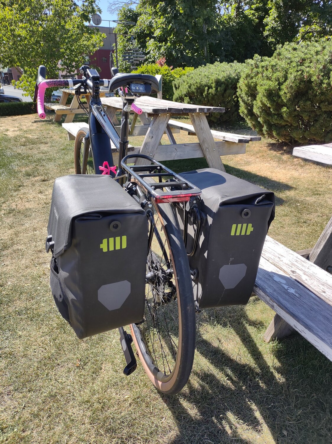

It works great and the light is super bright!

Thanks! It's fantastic riding it with the pedal assist off. Most of my rides I toggle between eco and off, usually off on anything where I'm descending regardless of the gradient. Really makes a difference with respect to range. When moving the bike's weight on flat ground isn't as noticeable, when the road goes up I usually keep it in eco. The light wire runs through the tubing of the rack down to the left dropout and I routed it through a hole on the back side of the motor surround.
There are AC and DC versions of the racks, the e-bikes all use DC whereas a dynamo hub uses the AC version.
Additionally if you wanted even more light you could remove the reflector and splice in a 2nd light with those bolt holes. I believe there are some lights out there that have alternating flashing modes for use with e-bikes. Won't be a proper strobe or anything but it's something.

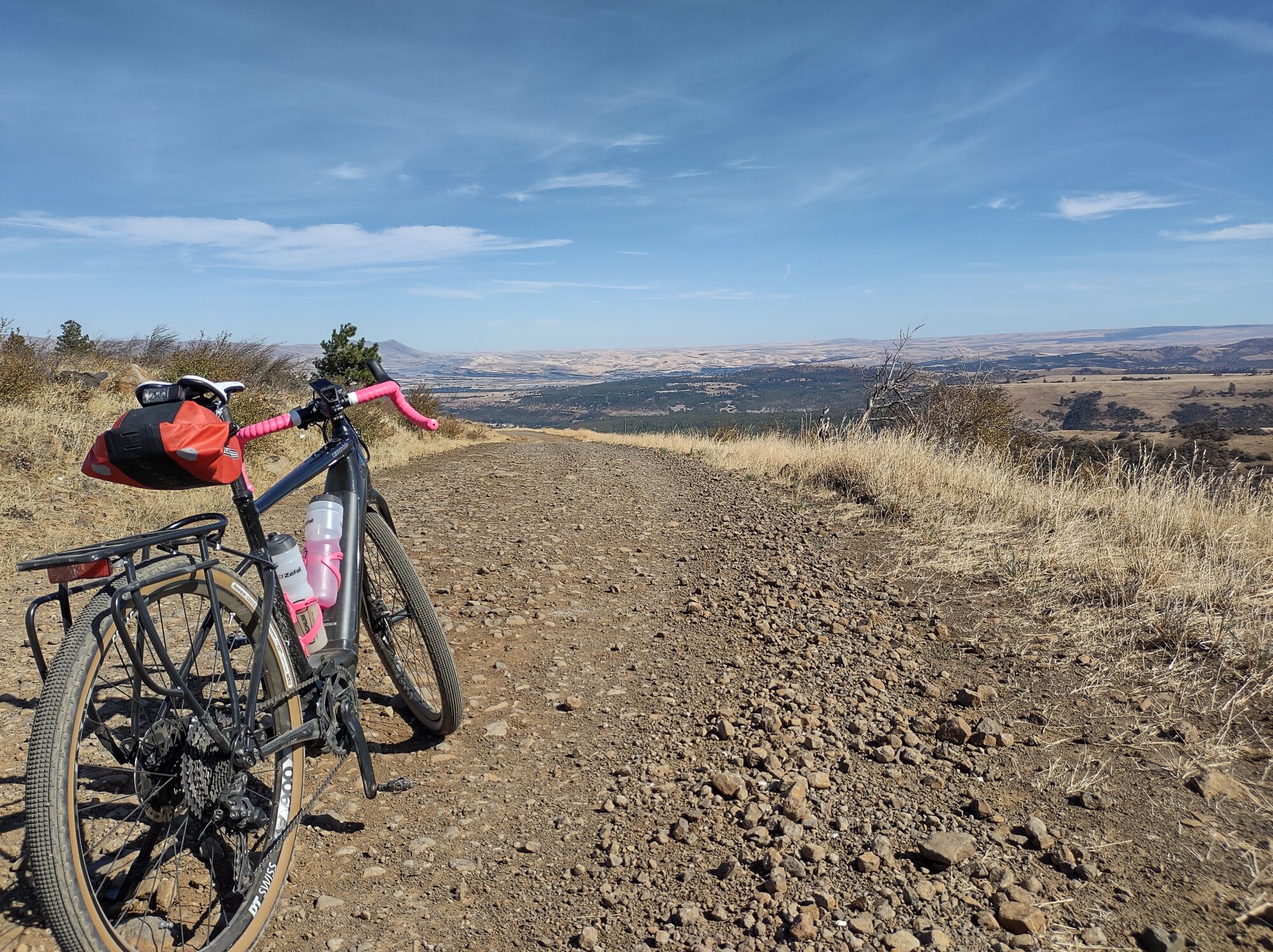

Here's the bike in full gravel mode, 650x1.9 Panaracer Gravel King SK's, absolutely perfect setup when the road becomes less than paved. Truthfully I'd probably keep it setup in "gravel" mode all the time but I'd rather not trash the gravel tires commuting.

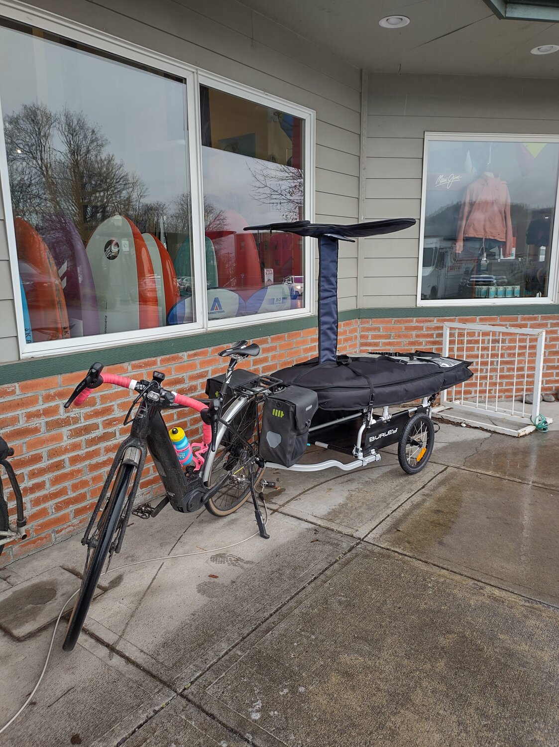

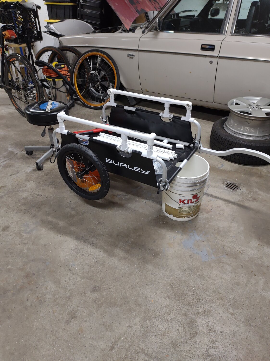

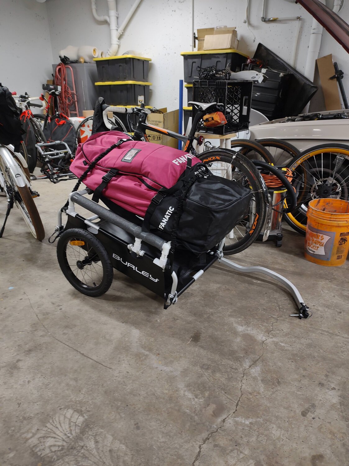

Got the trailer built up for hauling the wing-foil board to the river!

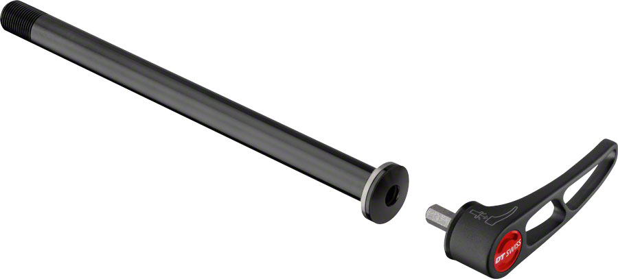

The Cannondale part for the front axle (that's the one that's hard to replace being 12x110) is K83011, I'd replace the rear with a DT Swiss one that has a removable handle so you've always got a 5mm key on the bike, check it out!
The rear axle isn't special, pretty standard 12x142 axle with 1.0 thread pitch.

Just want to check though my rear hub is 148mm? As opposed to 142?
Is there anything that is say DT Swiss in 148mm?
Thanks for the help Brendon!
Did some digging and:
DT Swiss Part Code HWQASM00S9923S, UPC 7613052278902
This is the DT Swiss Thru Axle for the Carbon series which is 168mm long, has a 12x1 or 1.0mm pitch and has a 15mm end which is Syntace X-12.
That is obviously for the rear!
For the front it is just like Brendon said K83011.
Hope this helps somebody else!
