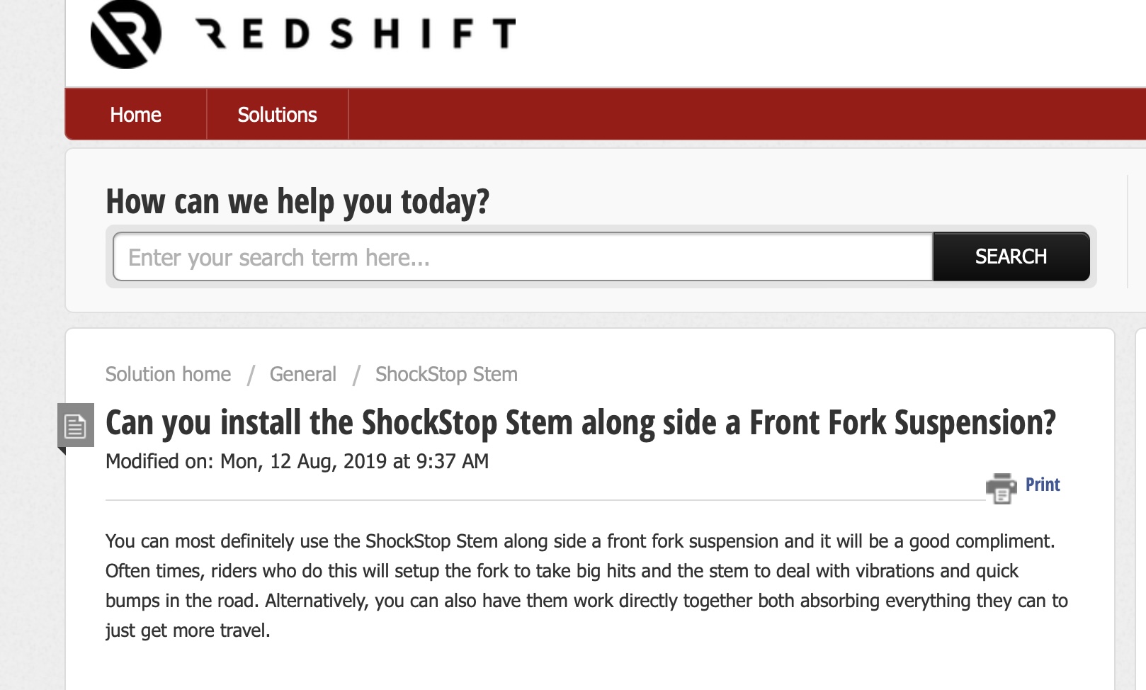

Technically speaking, Redshift shall not be used together with any other form of suspension because of harmonic vibration (resonance). Taking into account the travel of Lefty fork is similar to the travel of Redshift, it makes little sense to install the Lefty.
I checked with Redshift and they say it is fine to use with a fork. Here is the stuff from their website if anyone is interested.
Thank you for clarifying! It looks I was wrong about the possibility of installing the Redshift ShockStop stem for rigid forks only. Actually, Redshift Sports never wrote a word against using that stem for suspension forks!

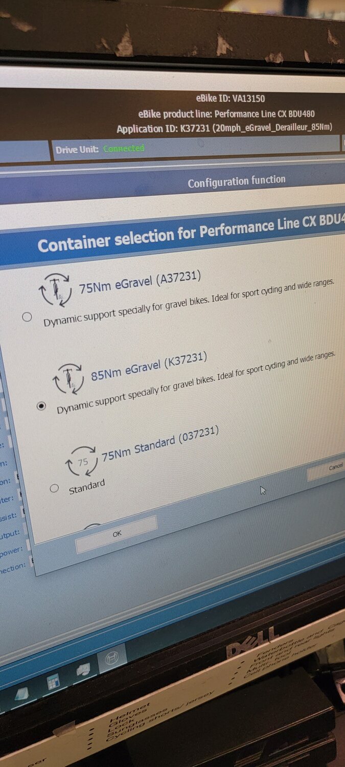

Hey everyone. Topstone Neo Carbon Lefty 3 owner here. I've got a Canadian version that I picked up lightly used this past summer and it's great! A completely different experience than riding my CAADX or non-ebike Topstone Carbon5.
Looking to see if anyone has been able to get the software updated on your ebike to get the Bosch eMTB (replaces Sport mode) or Bosch Tour+ mode (replaces Tour mode)? The Tour+ was released in July. It gives you power based on your pedal inputs and automatically adjusts from Eco to Turbo. The eMTB mode is the same idea but goes from Tour to Turbo automatically.
I brought the bike in to a dealer in September. They are only a Bosch service centre and not a Cannondale dealer. They put a new update but it didn't look like Tour+ was available. The techs didn't seem to comfortable with the Bosch software so I'm not sure if they missed anything. Here's a screenshot of the software that they loaded.
Let me know if you can help! Looking to get the best experience out of the bike.

With the upgrade does the eMTB and Tour+ show up on the display?
I have a Neo Lefty 3, but the display shows Sport and Tour, so I suspect mine may not be updated, even though I had the bike into the bike store I purchased the bike from last September.

Tour stays the same but Sport changes to EMTB on the Purion display from what I am told.
I reached out to Bosch a few months back and they told me that I had a specific Cannondale eGravel software installed on the Bosch drive unit that currently did not have Tour+/eMTB. They were not able to tell me if the feature was available to be added. They instead directed me to contact Cannondale since the current software was a Cannondale proprietary file. I did that and never got a response.
