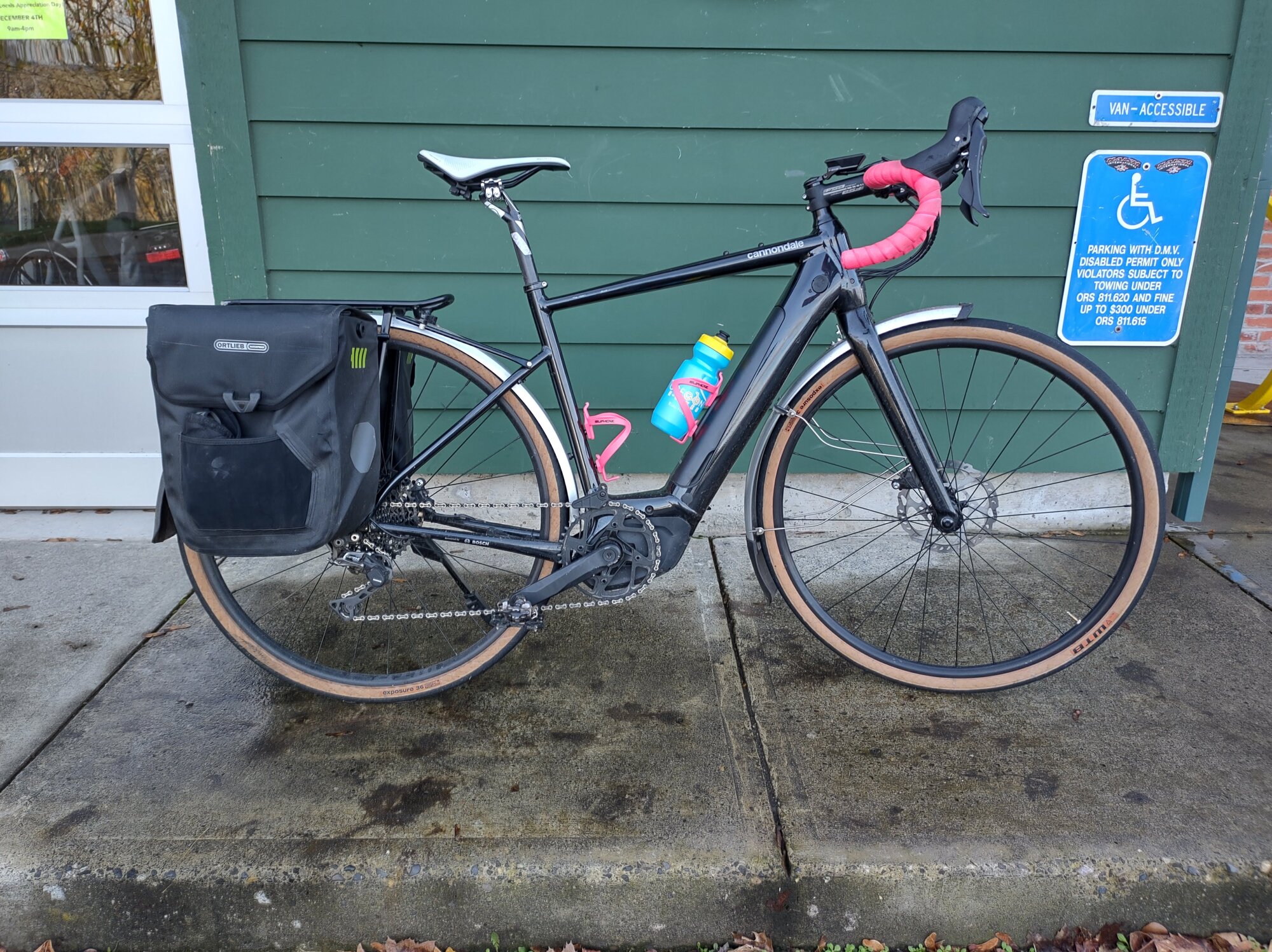

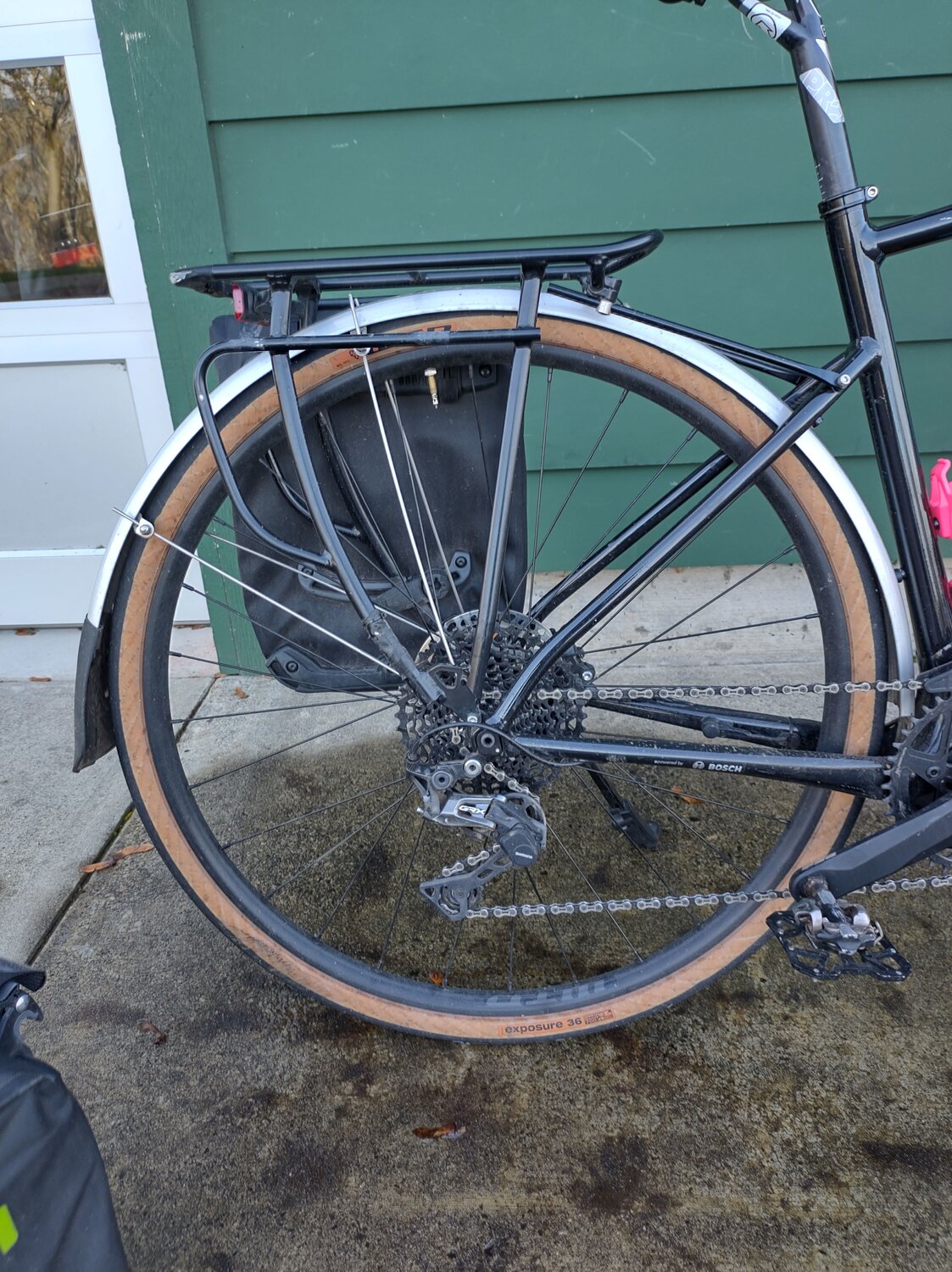

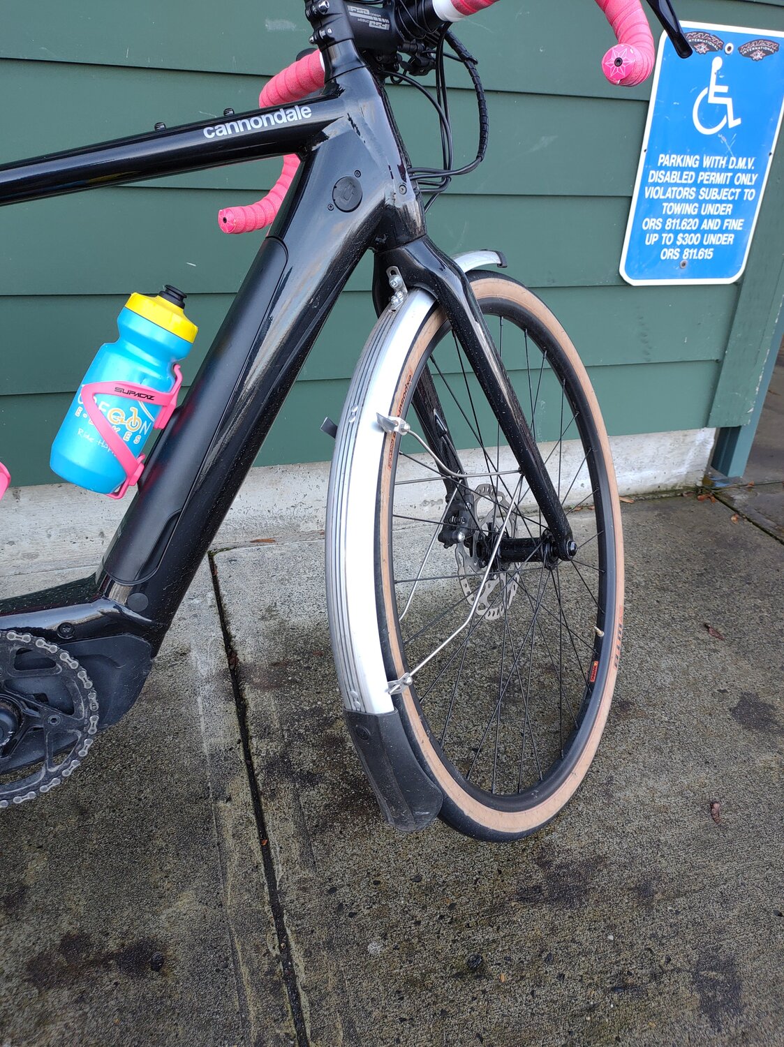

The Topstone's have mounts for proper fenders, both SKS and Planet Bike make great plastic fenders with stainless hardware. The SKS B65 Commuter is what I've fitted. Clears the factory 36c tires fine and plenty of room for my 650x47c gravel tires. Planet Bike Cascadia's are my other go to fender, long mud flaps, great durability. I've messed with metal fenders but have always been disappointed with the results.

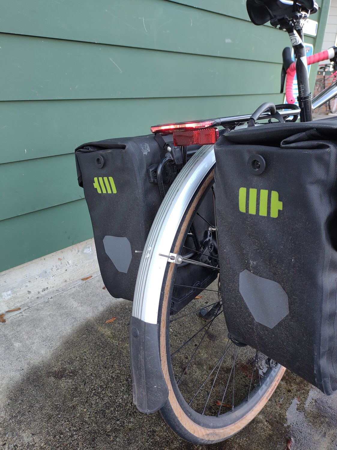

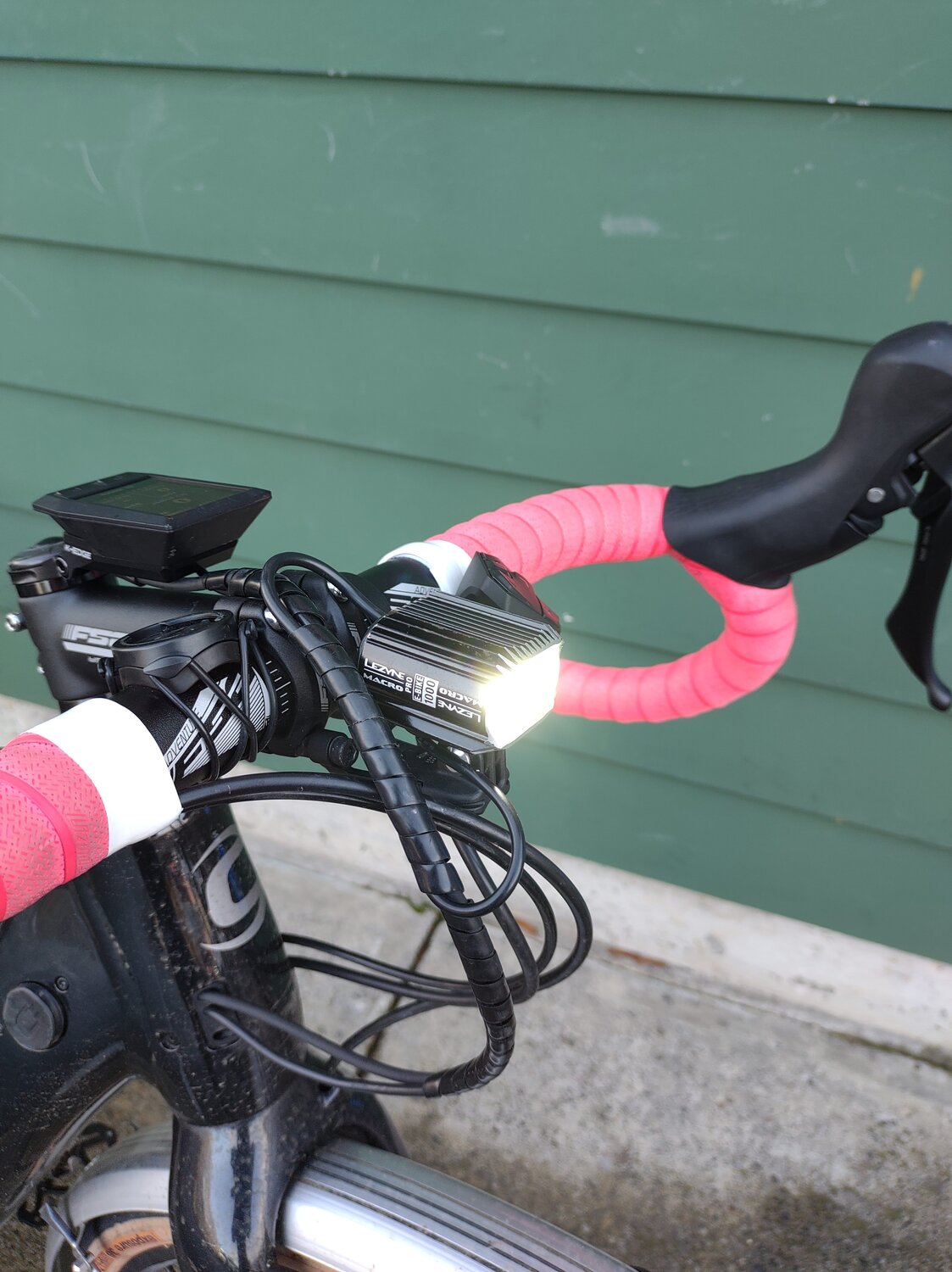

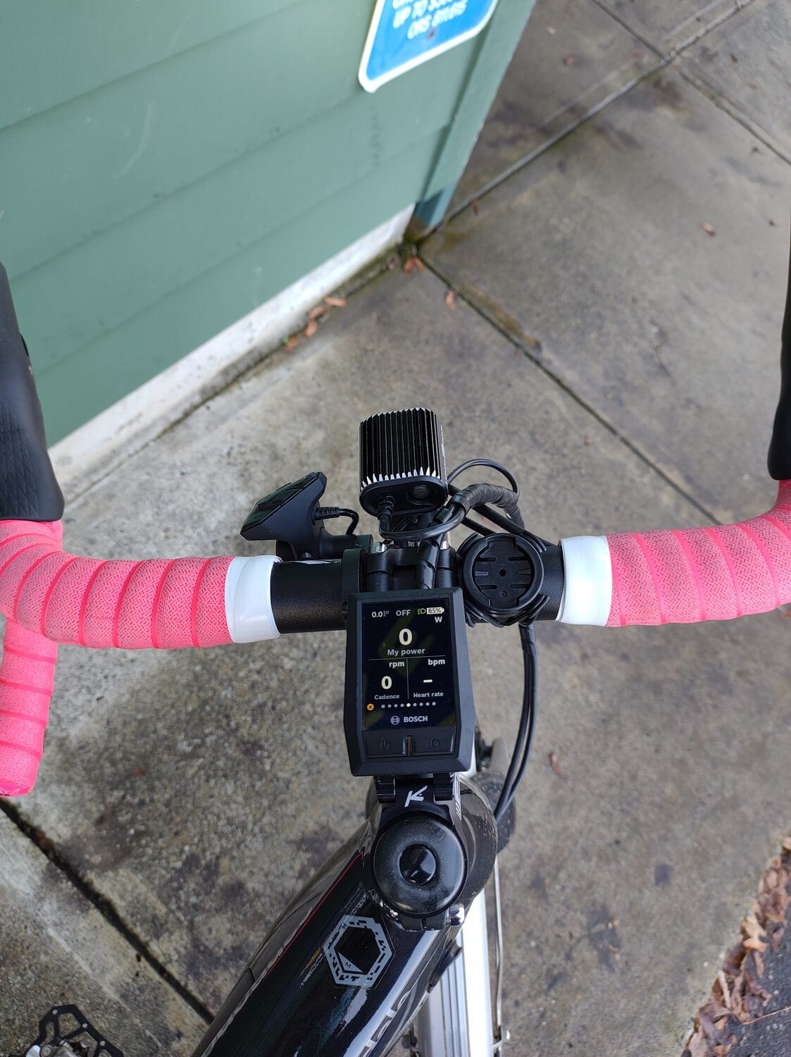

Light wise, they're able to be wired into the Bosch system as stated, the headlight wire should be pre wired, the tail light/rack lights aren't though. I did the Kiox upgrade the same time as the rack/light install so the motor is coming out regardless. You should bring it in for a firmware update/check also to make sure that you can control the headlights through the display.

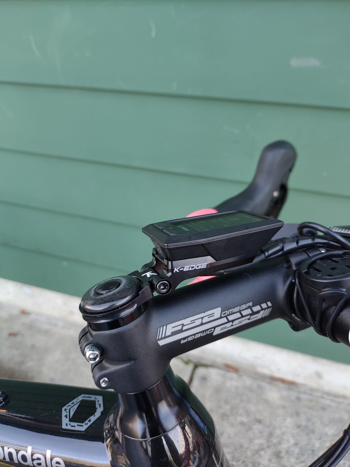

Have a gander! Also check out the new K-Edge Kiox display holder, so slick! They've got another one that's like the Acid mounts from Cube too. https://k-edge.com/product-category/computer-mounts/bosch-mounts/

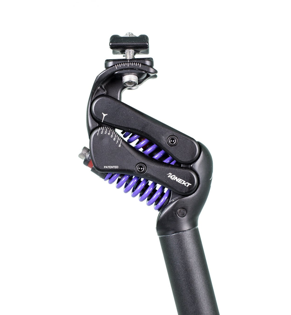

I have the kinskt carbon seatpost on my Neo 3 which is a major improvement as the kingpin deals with big hits, while the kinekt is good at smoothing out the higher frequency chatter.
