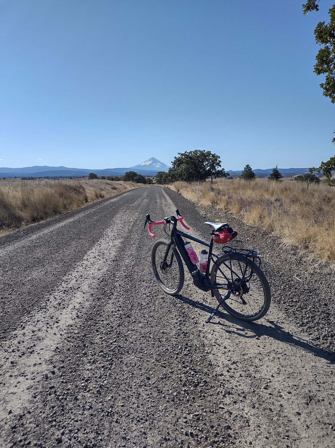

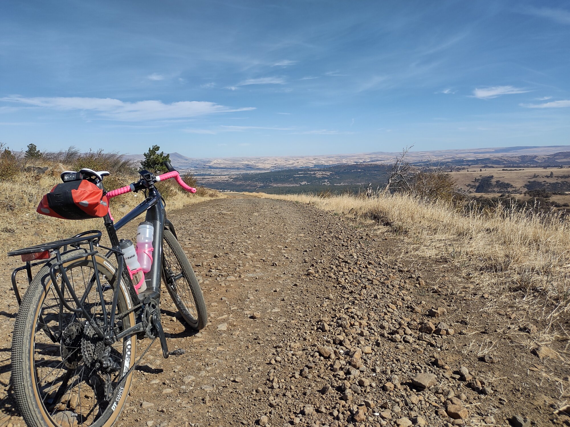

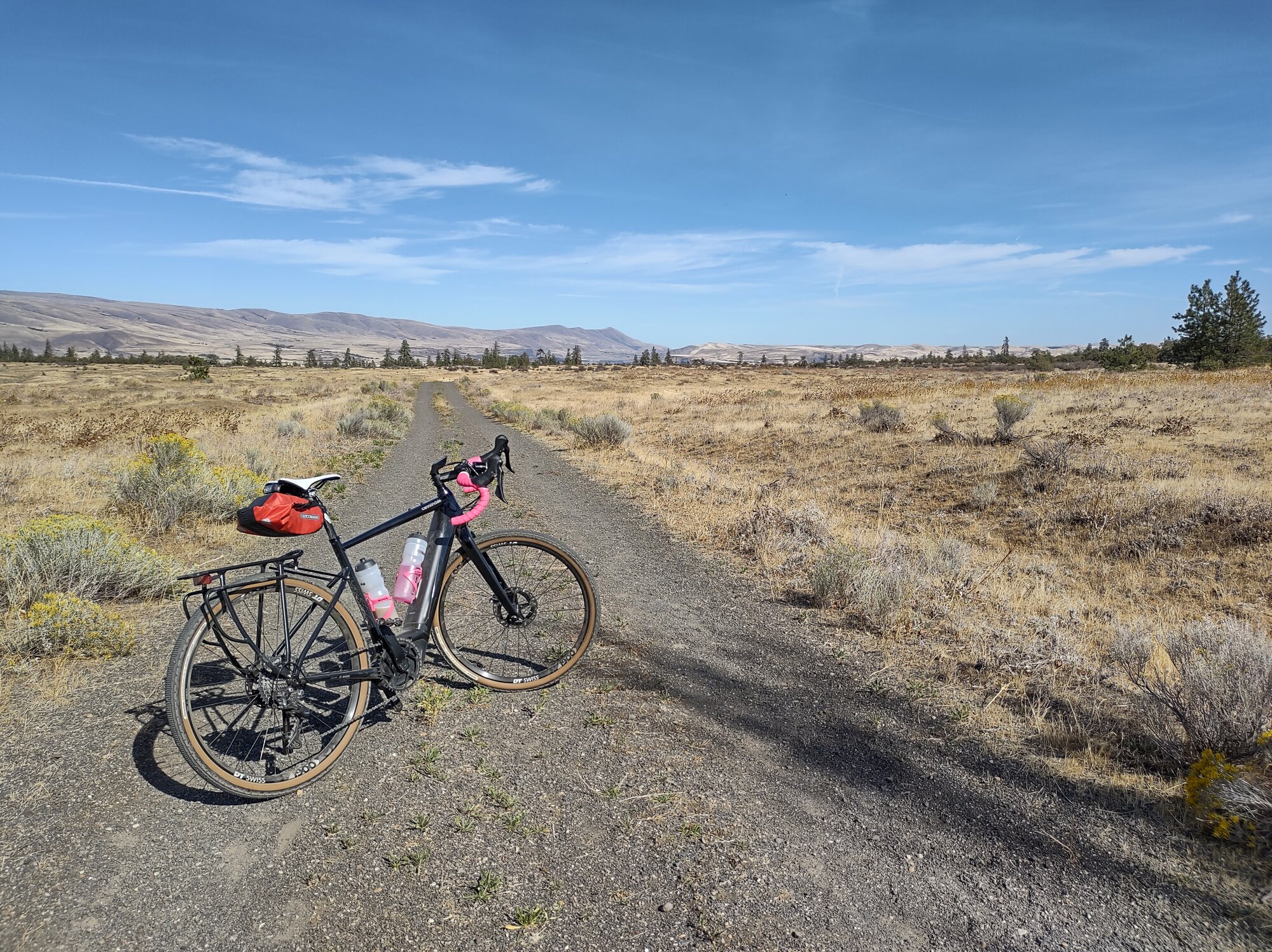

Couple of pics from the last few gravel rides, loving the 650x1.9 Panaracer Gravelking SK tires too!

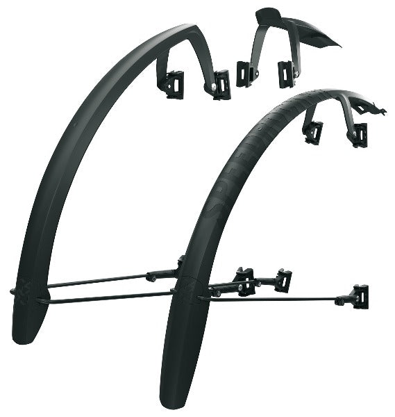

these are great fenders for the Neo Carbon 2 available at REI

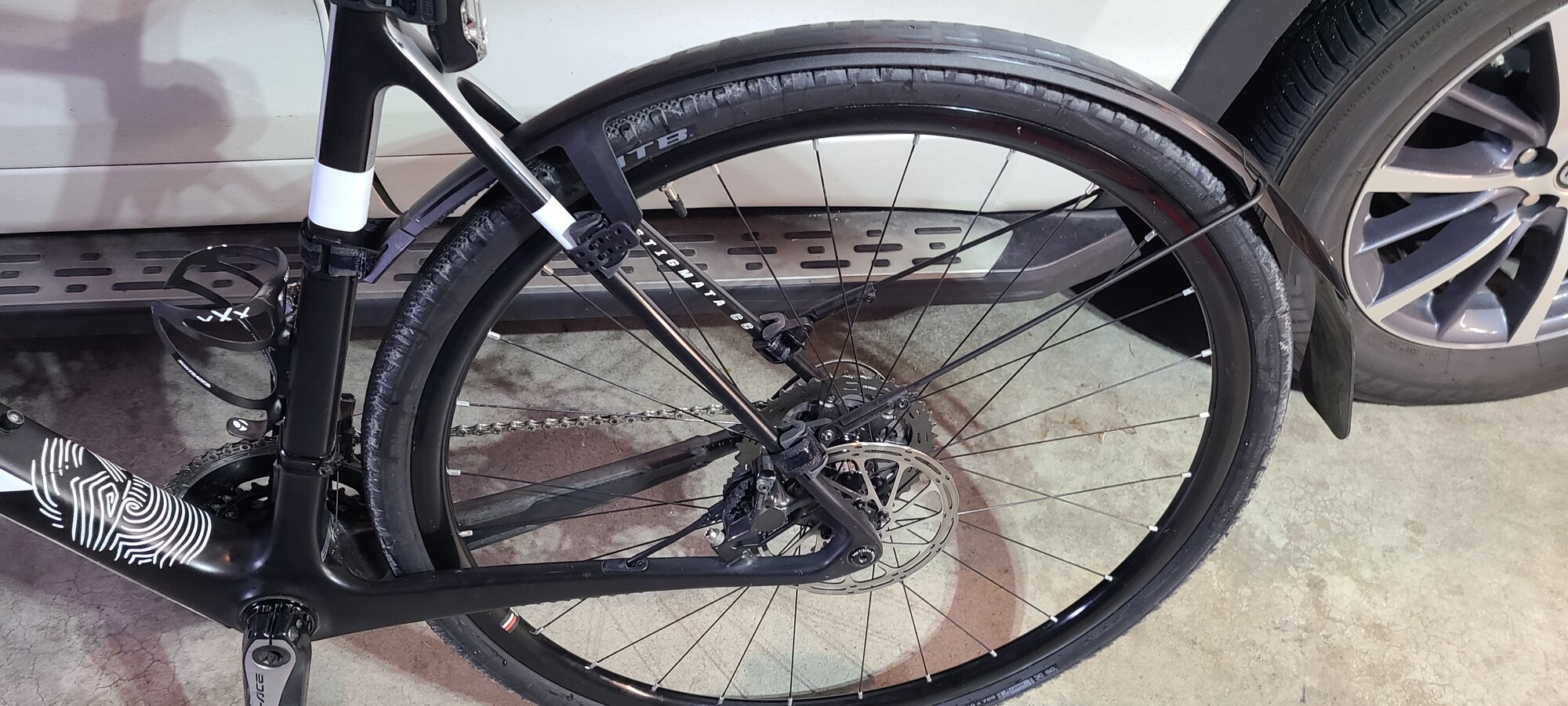

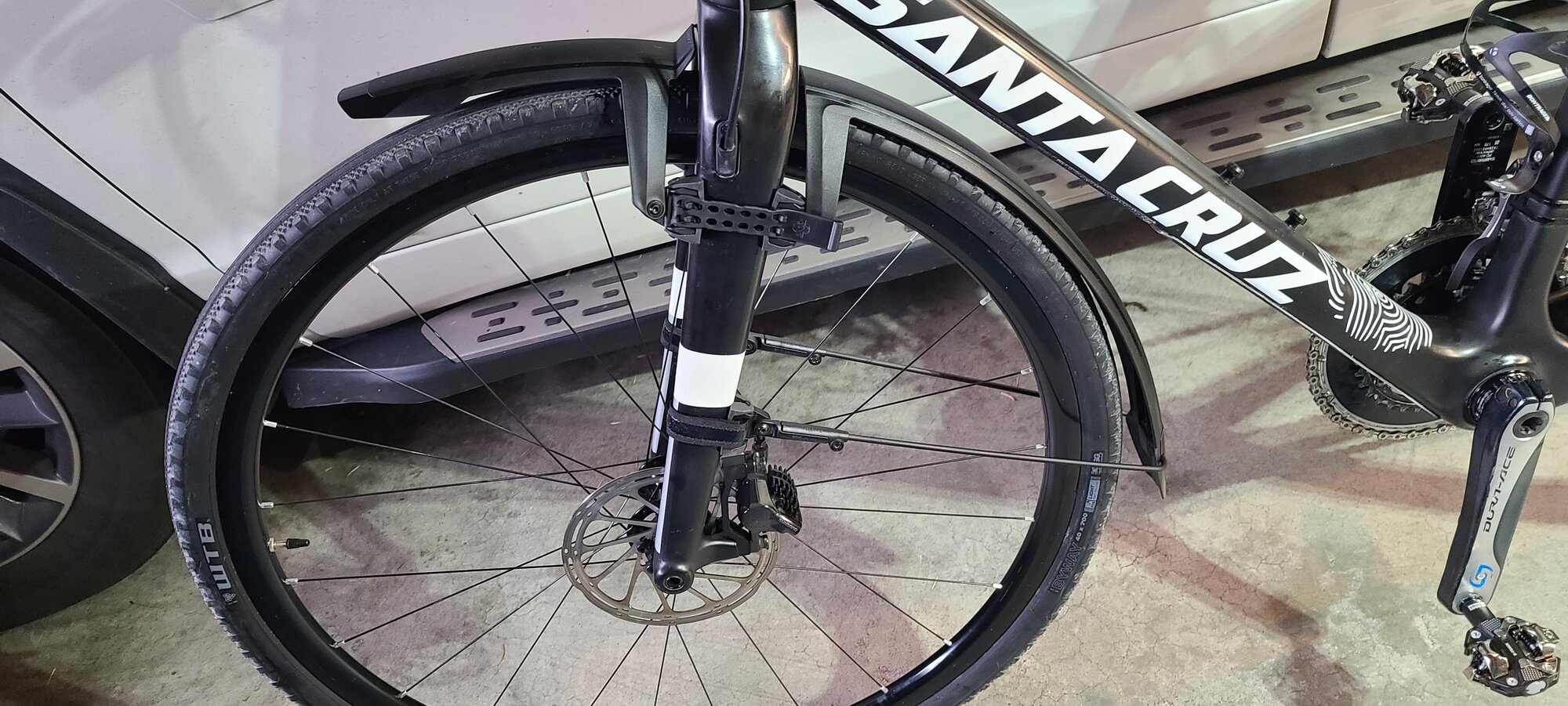

I had a set of Speedrockers on my carbon road bike last winter. They did a decent job of keeping the water spray from the tires off the bike and me, but I found they needed to be adjusted on a regular basis.
Thanks Alaskan. I have an outward Bound tBrail light (https://www.outboundlighting.com/products/trail-evo) I was thinking about putting on it. The light is impressive - super bright, incredible build quality and I love the flash mode for road riding. I would however love it to hardwire and that should be an option so I am going to look into that some more.
Glad you posted that link - I should be out by REI next week so I will check those out. I just cant believe Cannondale does not offer a nice factory option. Seems they are sort of missing a good opportunity there?
Probably a good idea to call ahead to REI and make sure they have a set in stock when you get there. Best to just order them and not buy them if they don't meet your needs. I really like them as they go on and off in about 5 minutes and require no frame screw mounts.
Here they are on my Santa Cruz Stigamtta CC (not an ebike)
