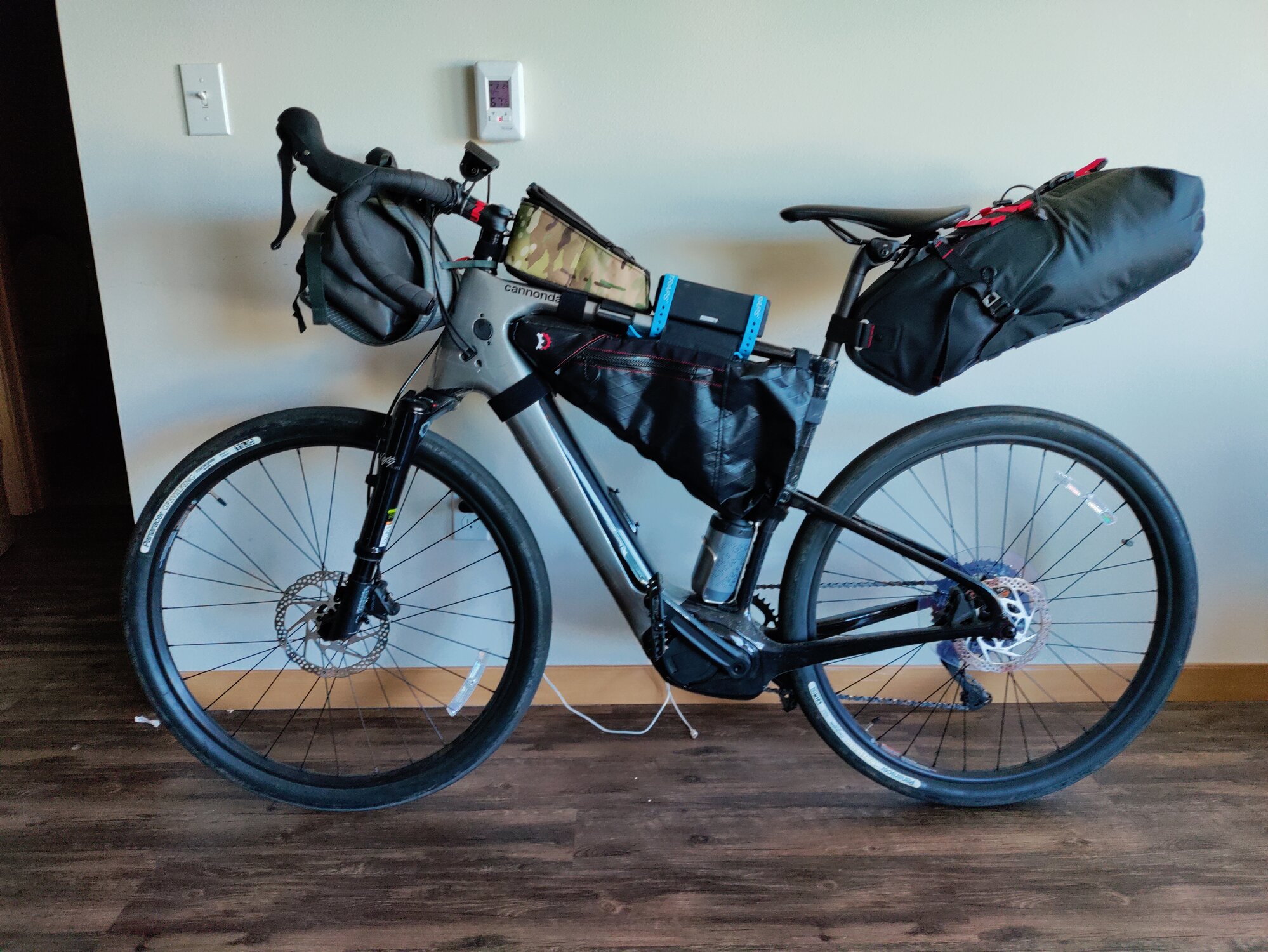

I wanted to make use of the bottle cage mounts on the down tube. That ended up being more trouble than it's worth. I was able to make use of the seat tube bottle cage mounts. It is enough space for a can of beer, or a tool/repair kit. The King Cage lowering cage fits perfectly.
On the XL frame the Revelate tangle bag just fits and leaves room to use both bottle cage locations. The battery goes in on the drive side of the bag and fits just right with the cover fitted, in a protective woven cloth tube and allows for some low profile items to be kept in the left side of the bag with a panel between compartments.

This is the final iteration of my bike packing setup. I have my tent, groundsheet, and sleeping pad in the handlebar bag. I have my sleeping bag in the seatpost bag. The spare battery and chargers fit in the triangle bag. A few items, including water, will be carried in a backpack.
