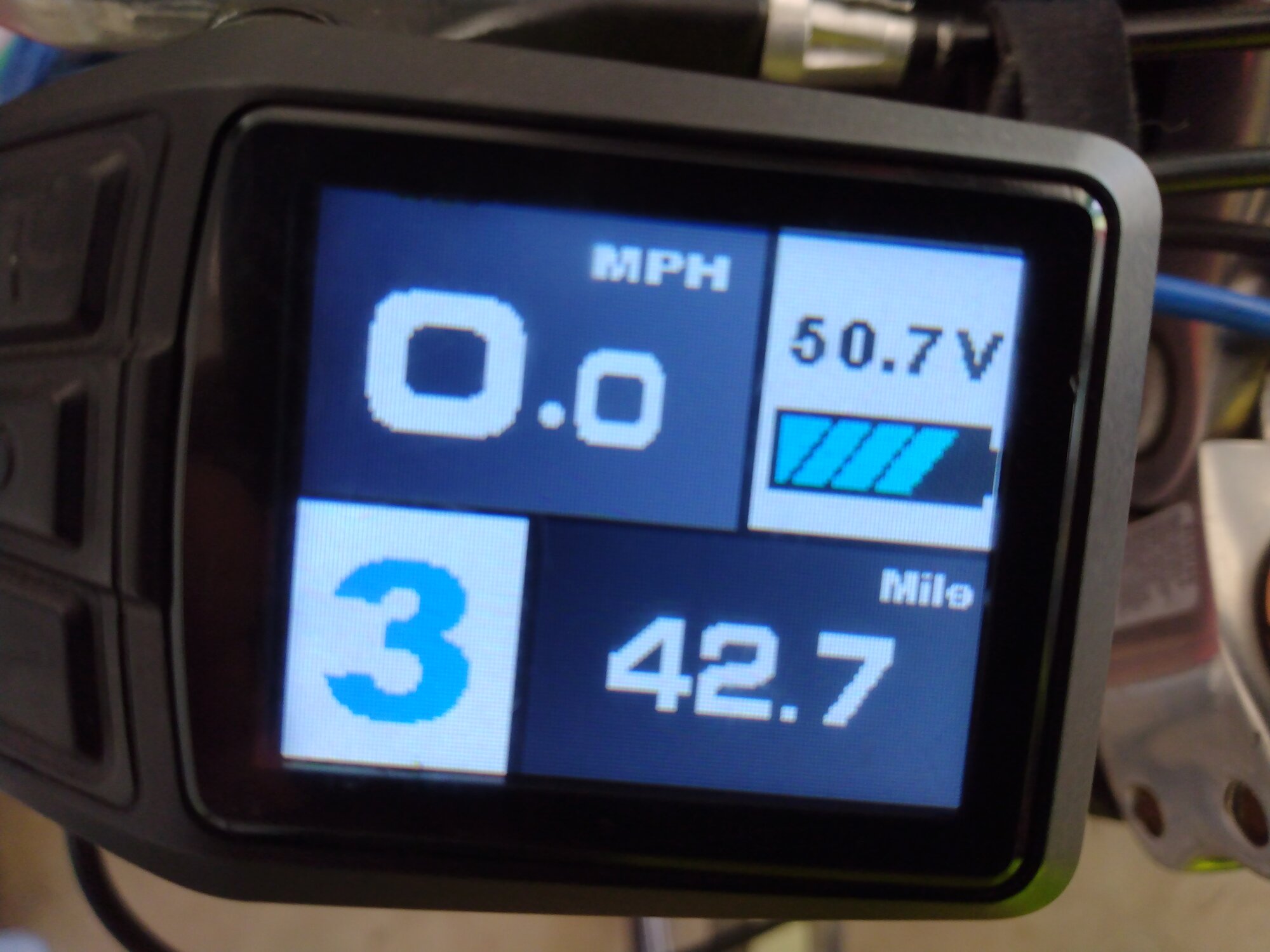

I've ridden over 90 miles and it is still over 50v. Fully charged it 3-4 weeks ago then rode 50 miles on the Olympic discovery trail, let it sit a couple weeks then rode again yesterday and today another 40+ miles. Probably in the neighborhood of 4,500 ft of climbing total. Still over 50v briefly saw it drop to 49.x volts on a steep long grade today. I don't think my Yamaha 500wh battery can match this. I hadn't used it much over the past year because it weighs a good 10#.
From the last 2 days of riding + the 50 miles riding the Olympic peninsula.
Crazy
BTW both the mileage and voltage are accurate
I'll try to do another 20ish mile ride and tell my wife to have her phone with her and be ready to come pick me up if it goes flat. Mileage is very individual but I'm pretty sure that my Yamaha battery on a similar but lighter bike wouldn't have made 90+ of the same miles and still had much, if any, capacity left.

I did confirm with a multimeter, only 1/10v difference. The display voltage is odd in that the max voltage that will display is 51.7 v even if the battery has higher voltage but once it hits anything below 51.7v, even by a fraction then the displayed voltage is correct (at least the times I have double checked with a multimeter).
Battery dropped off at the worst time, just before a 1000ft climb over 2.5miles to get home. Went from 47.x volts then fairly quickly to 42v then cut out over maybe 1/2-1 mile of moderate climbing.
Still, it gave me good assist over the 110 miles that the current charge lasted.

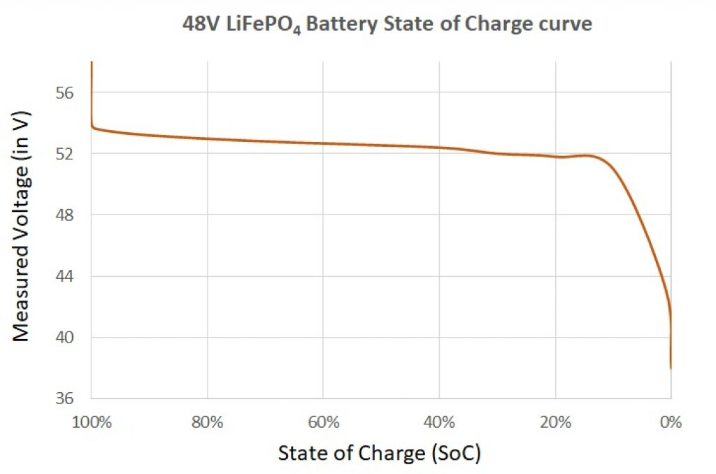

Found this chart, not sure if it is accurate but if it is it explains a lot
State of ChargeVoltage
100% (charging voltage)57.6V
100% (resting voltage)54.0V
99%53.6V
90%53.2V
70%52.8V
40%52.4V
30%52.0V
20%51.6V
10%49.2V
1%43.2V
0%38V
State of Charge (SoC) x Measured Voltage
table for a 48V LiFePO4 battery
as does this
