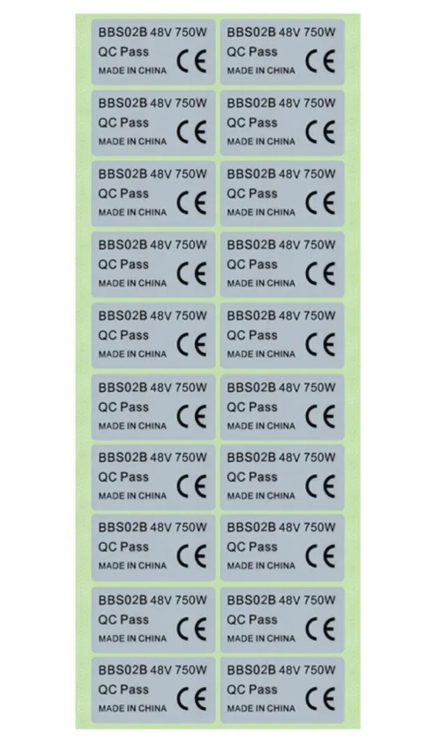

The battery is sealed of course but if you look at the photos I posted,I was wondering why does my battery have a white sticker with 750 on it.
I also have the same battery with a sticker on it but that is 250 any one no why that is.

No idea what the 2 stickers mean.
There's also no manufacturer identification sticker?

Stickers don’t usually mean much. A 750 watt sticker is just an identifier for the bike to enter the country. Other countries you could see a 250 watt sticker.
My controller can provide 1200 watts. I could get a 48v 750 sticker on eBay and be compliant for the officer. If they were interested in looking. Just searching eBay, I can purchase these.
