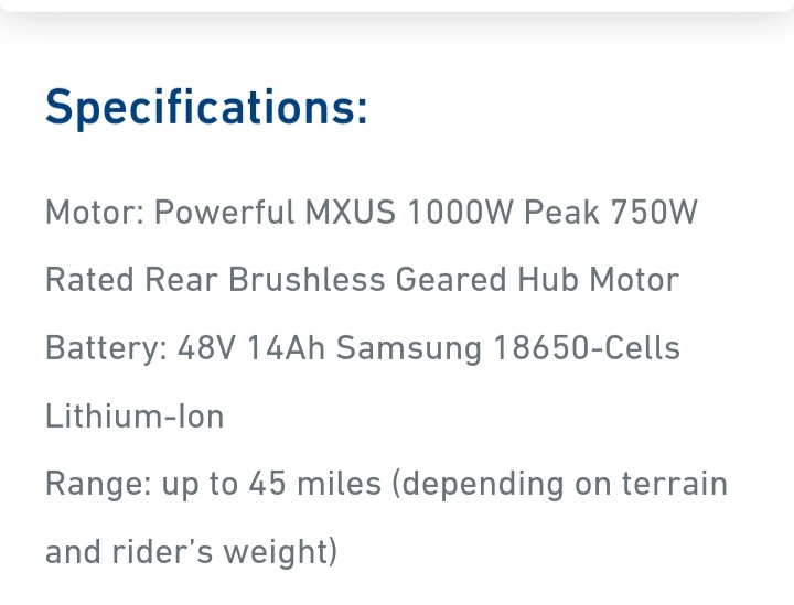

The original battery was 48V 14AH and had a Maximum range of 45 miles.
You have an ~48V 8AH battery taking you 17 miles.
