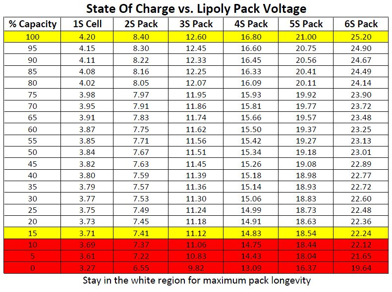

To be relevant to the original thread, I do like MarkF's chart,..
It shows 3.71 volts as a lower caution, so 48.23 volts (13s) and 3.27 volts as 0% at 42.51 volts.
That's more in line with my fuel gage and my three batteries.

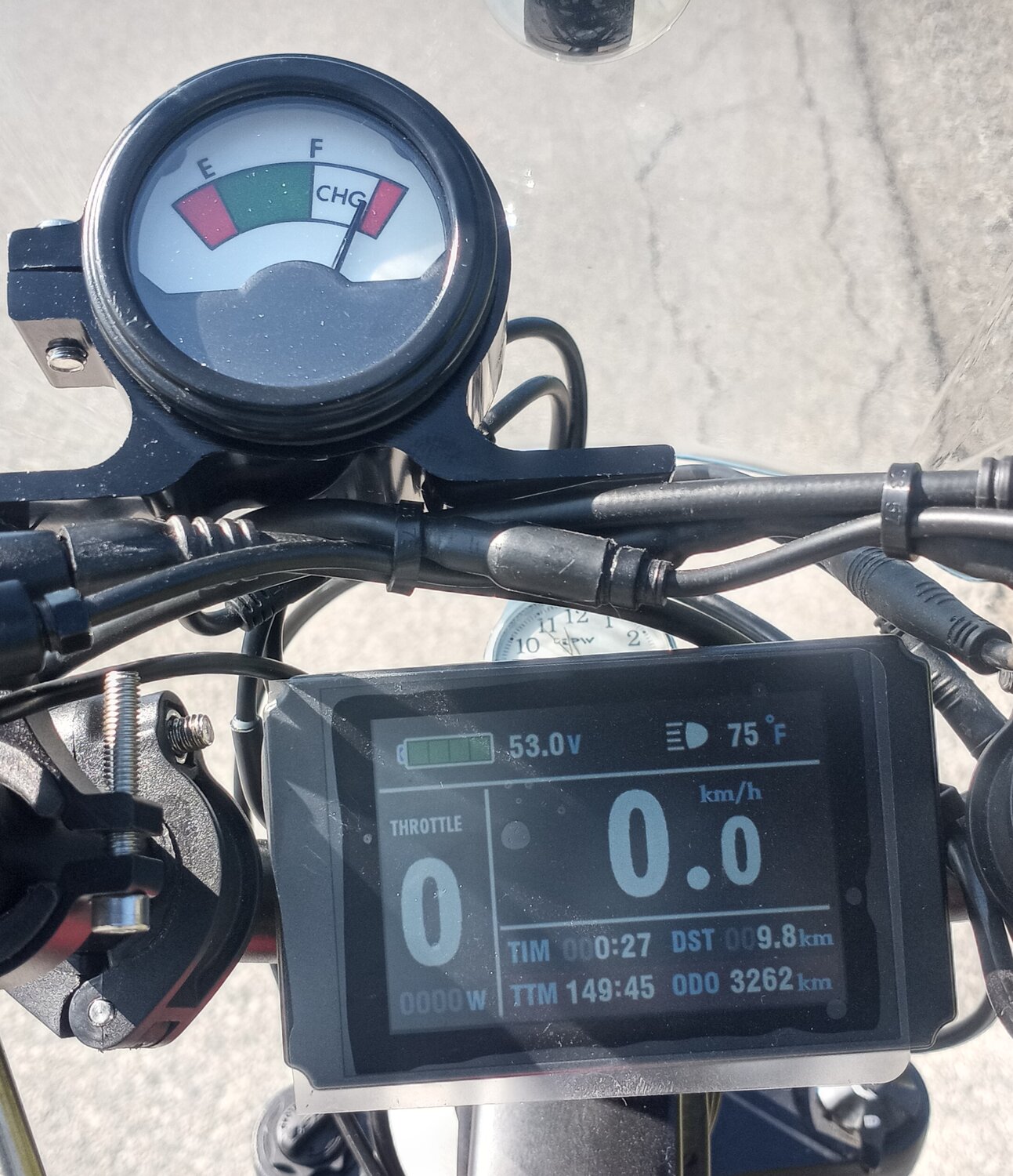

My fuel gage just enters the green at 48 volts and my displays' voltage bar graph shows full power until 48 volts, but that's really misleading.
Once I hit 48 volts, the capacity starts dropping Really Fast, and by the time I hit 42 volts, my battery is useless and my controller starts cutting out due to voltage sag.
I can easily sag 2 volts with less than a 200 Watt draw.
If you're using say, 300 Watts to ride the way you're riding, you are drawing 5.5 amps with a fully charged battery at 54.6 volts, but to get the same 300 Watts to the motor with the battery at 40 volts, you need to draw 7.5 amps from the battery.
My fuel gage needle starts picking up speed and drops to my low voltage cut-off in a big hurry once I hit the green.
The battery bar graph on the display really should read about 25% once you hit 48 volts.
If the fuel gage on my car read "Full" until I was at ¼ tank, I'd disconnect it and use my odometer trip meter as my fuel gage.
