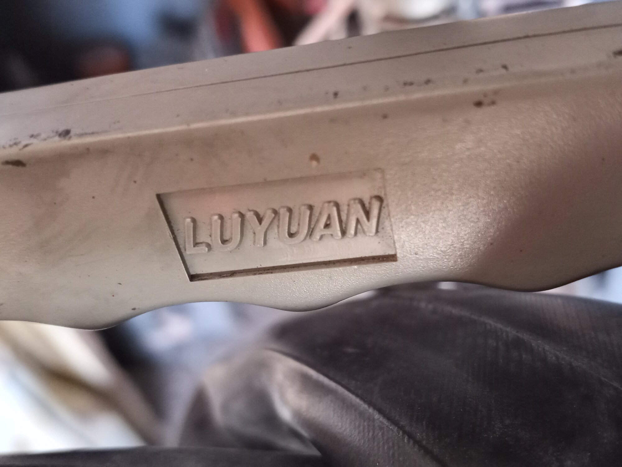

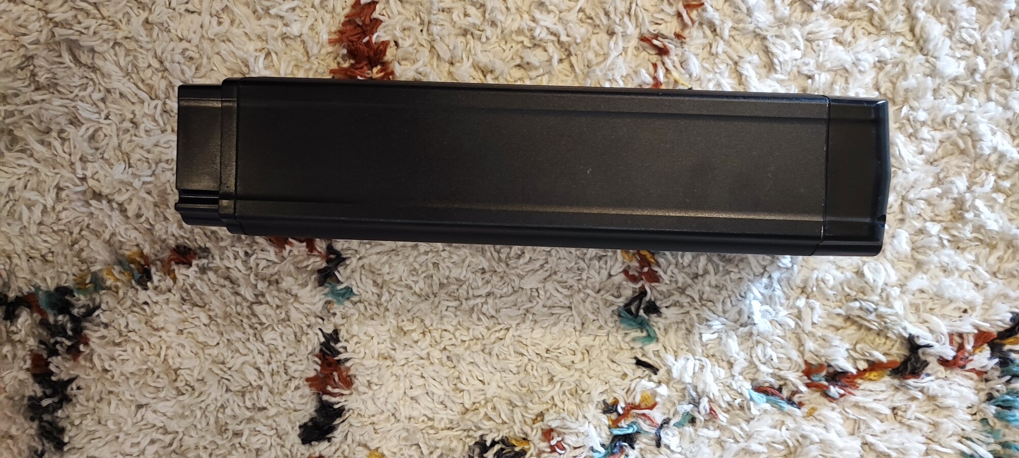

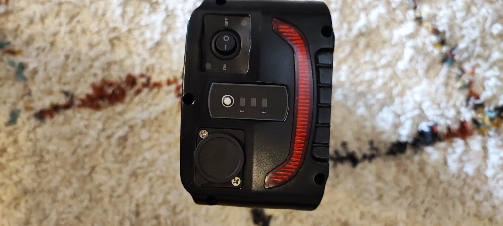

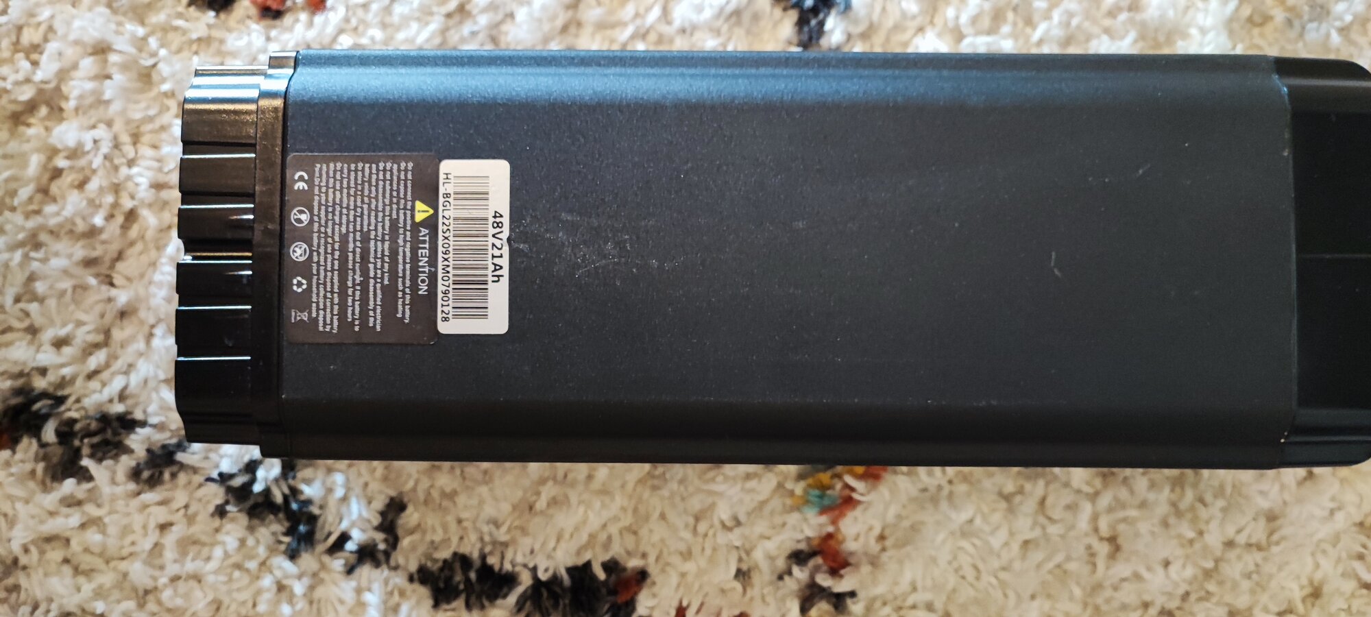

Yes my battery is inside an metal case I have enclosed photos if that helps,great news then if my battery is 30a maximum.
I saw the pictures, but wasn't sure if I was seeing a metal case or not.
I'm just speculating that a 21AH battery would have a 30 amp BMS.
My three batteries do, and the smallest one is 19AH.
I suppose that if your battery was only intended to deliver power to your stock ~250 Watt motor, it could have a smaller BMS?

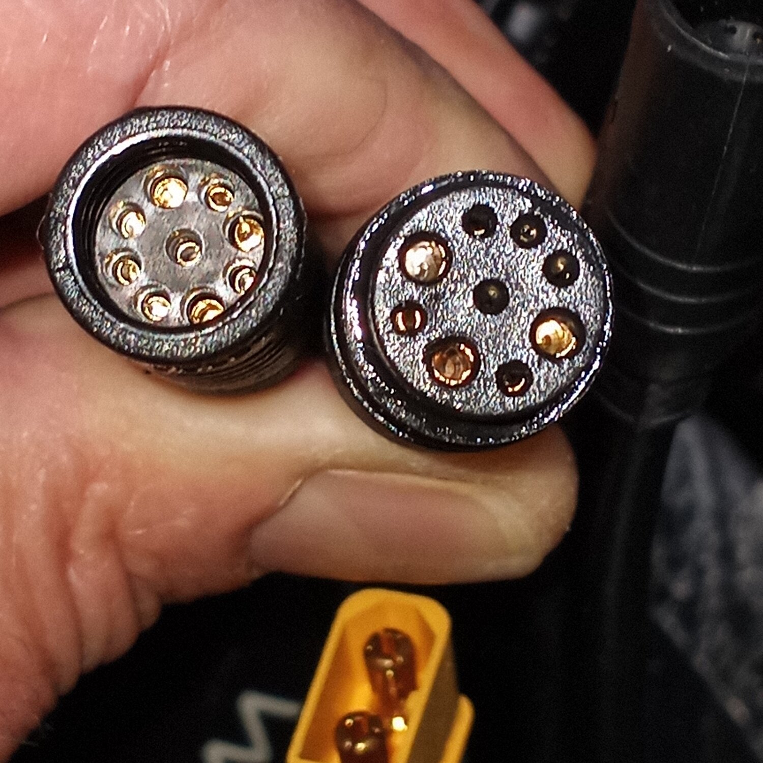

I'm no professional but I did manage to install a 25 amp KT controller on my e-bike.
The project turned into a Huge chore when my motor cable wouldn't plug into the KT controller, so I had to cut the cable off my old controller and solder it directly inside the KT controller.

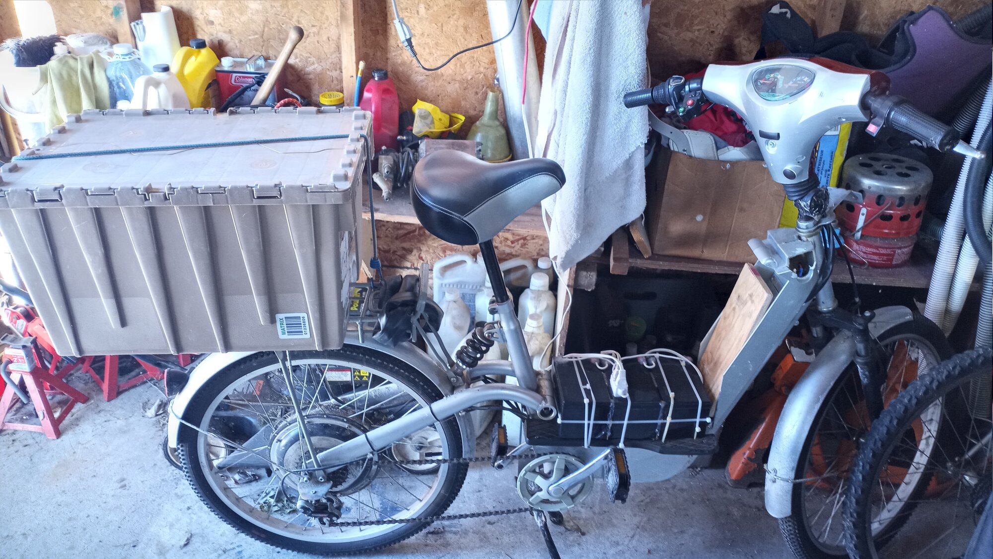

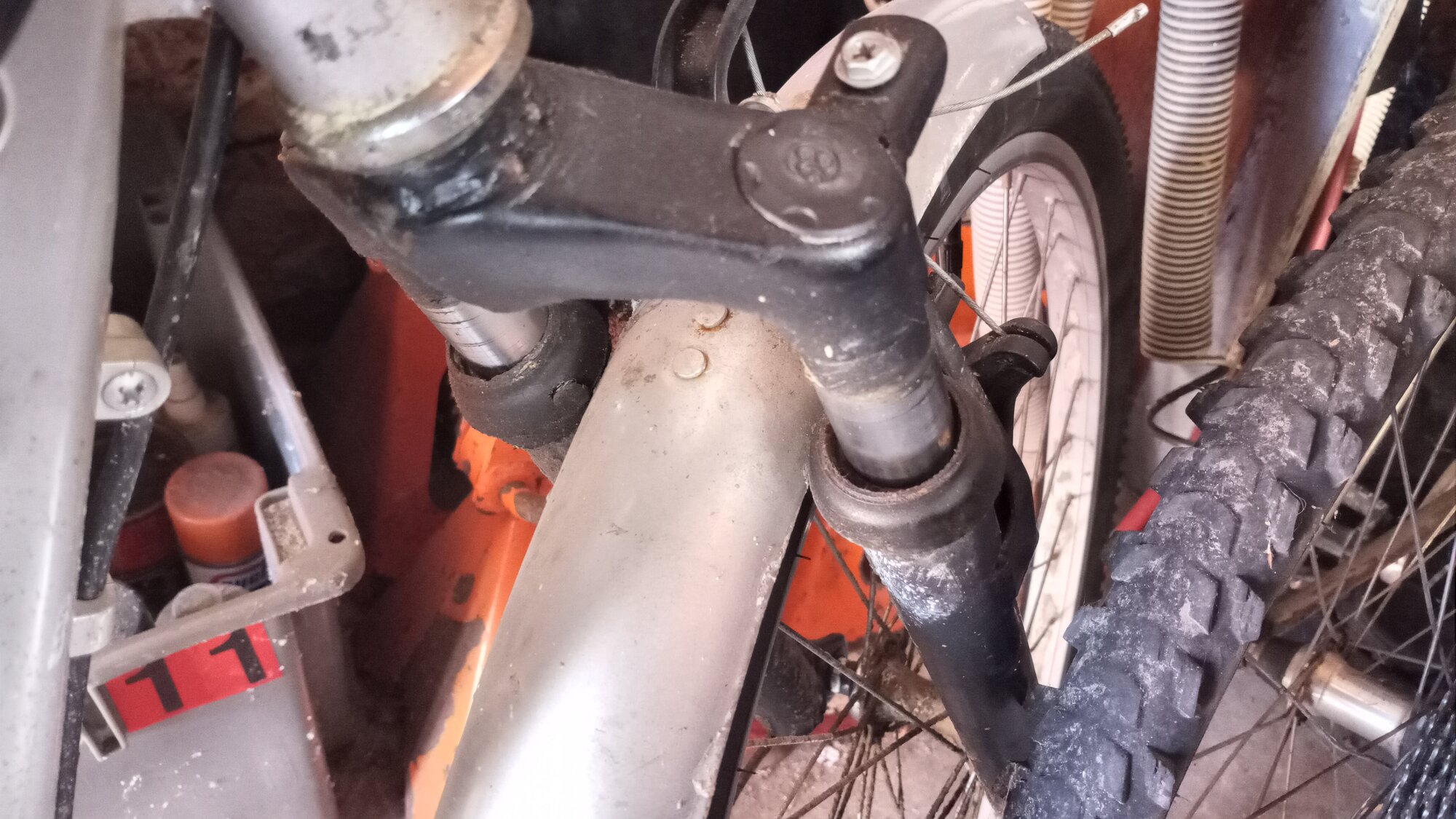

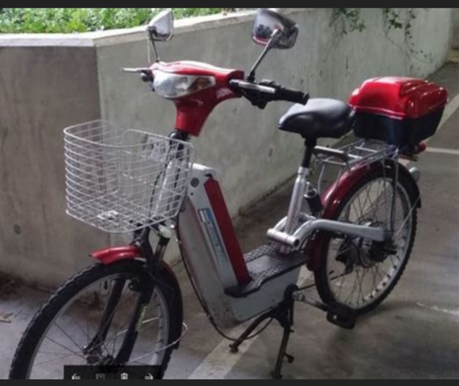

Coincidentally, I bought my first ebike about about ten years ago.
It was intended for the Dutch market,..
I got it for $400.
It was completely punched and worn out, but it came with new batteries (three 10ah 12V SLA), and it worked !!
The suspension forks wobbled front to back more than they moved in and out. 😂

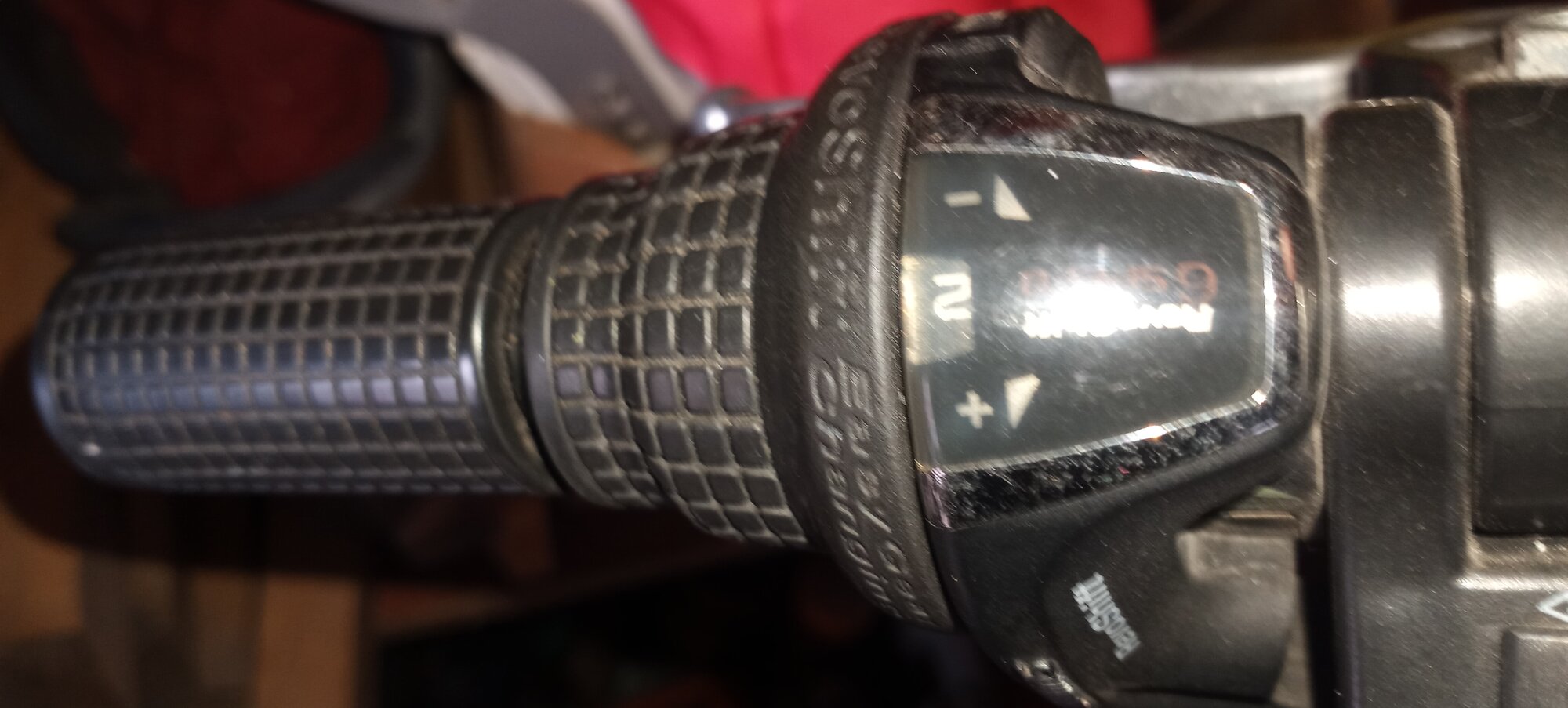

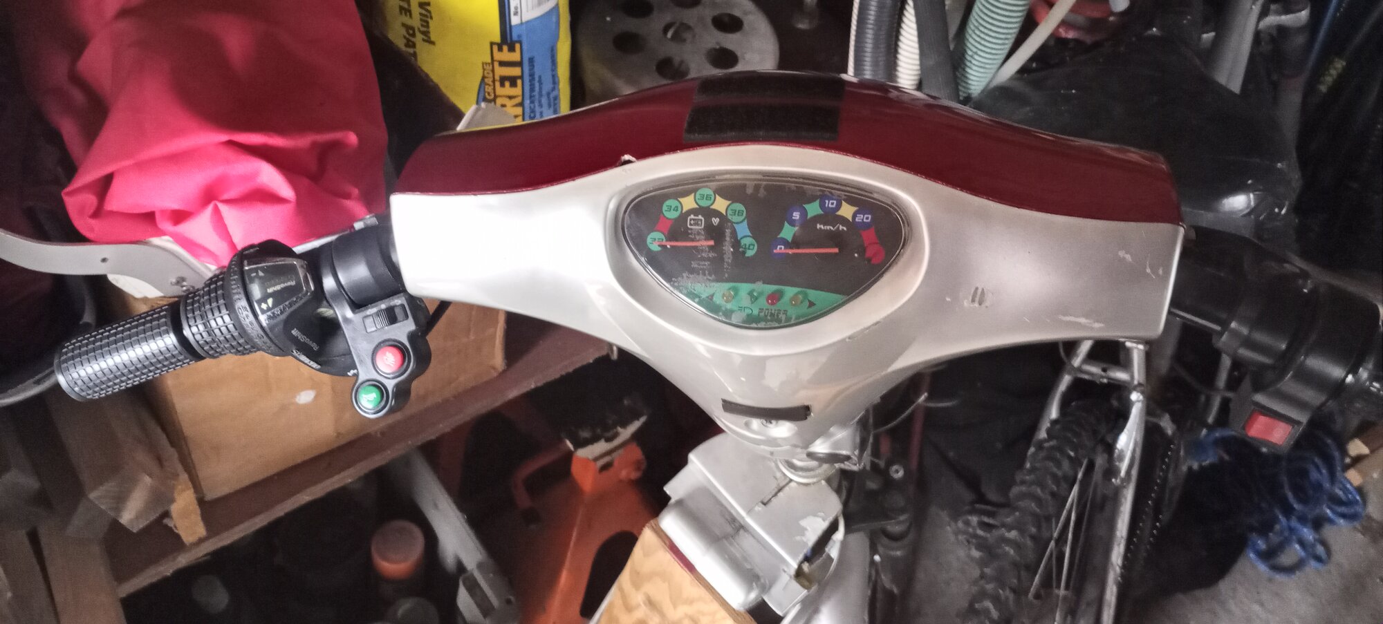

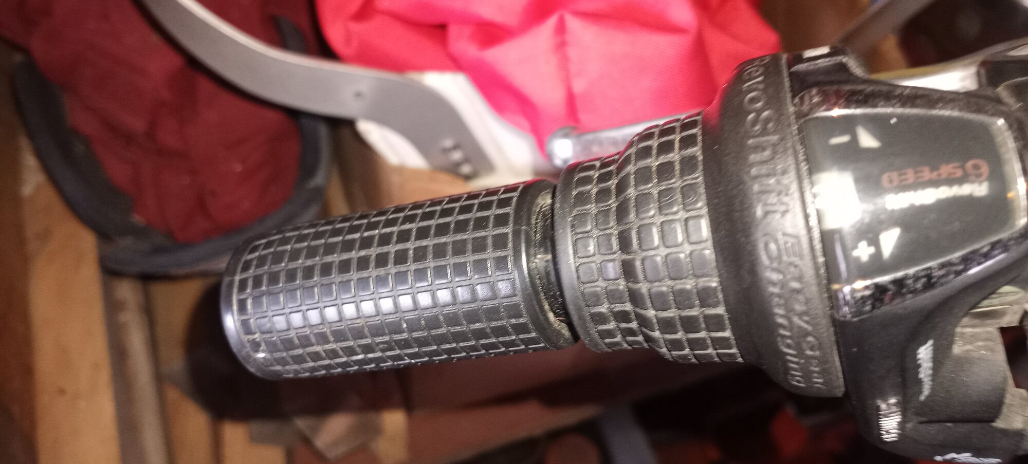

You guys over there on the other side of the pond put your throttle on the wrong side of the handlebars, so when it was imported to the New World, they just flipped the handlebars over to get the throttle on the proper side but now my gear shifter is Really Messed Up !!
So am I in 2nd gear or 5th gear??
Am I going slow or fast, or forwards or backwards or am I riding upside down??
The only way to know for sure what the Hell is going on is to look at it through a mirror, and that's really hard to do when riding along in reverse and don't know how fast your going.
The thing is a tank and just keeps going, but it WILL NOT Go faster than 25 kph.
The power cuts out at 22 kph, and when you hit 25 kph, the regeneration kicks in. The harder you pedal the more you pump your energy into the battery. The regeneration is progressive and automatic, so there is simply no way to go faster.

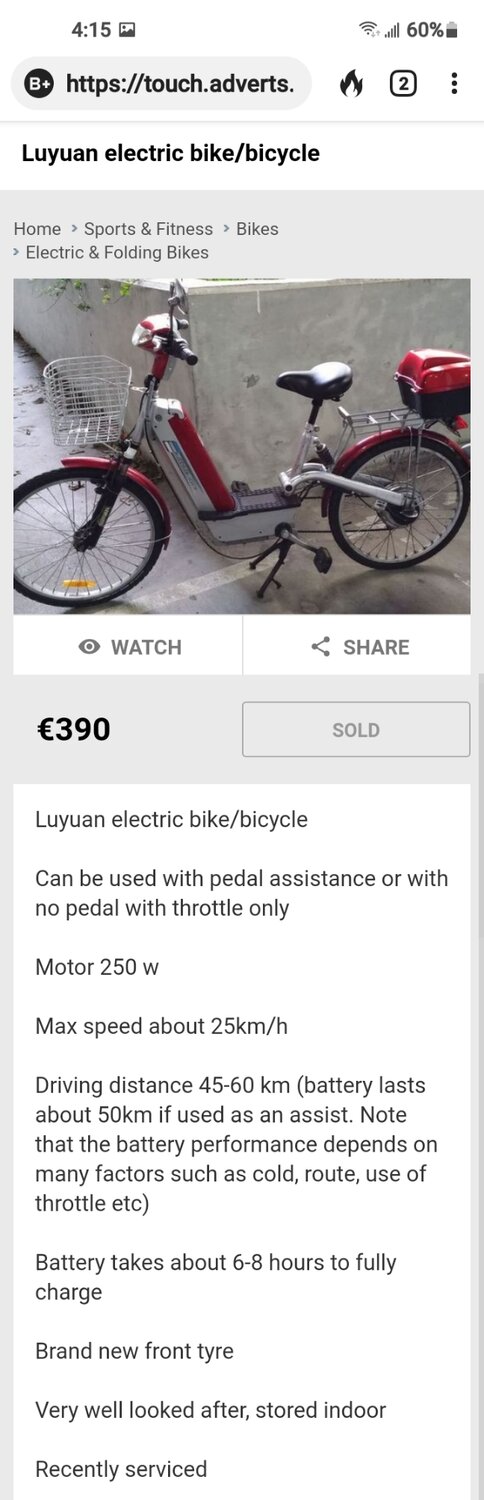

In my research attempts to find out how the hell to bypass that crap, I found this info,..

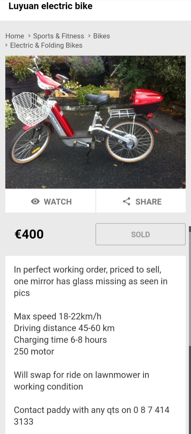

There was one for sale in England,..
Same price I paid. Bucks pounds, whatever?

I like this ad,..
"Willing to trade for a ride on lawnmower". 😂
I'd trade mine for a lawnmower too,..
At least it burns gas like a real "man machine" is supposed to. 😂

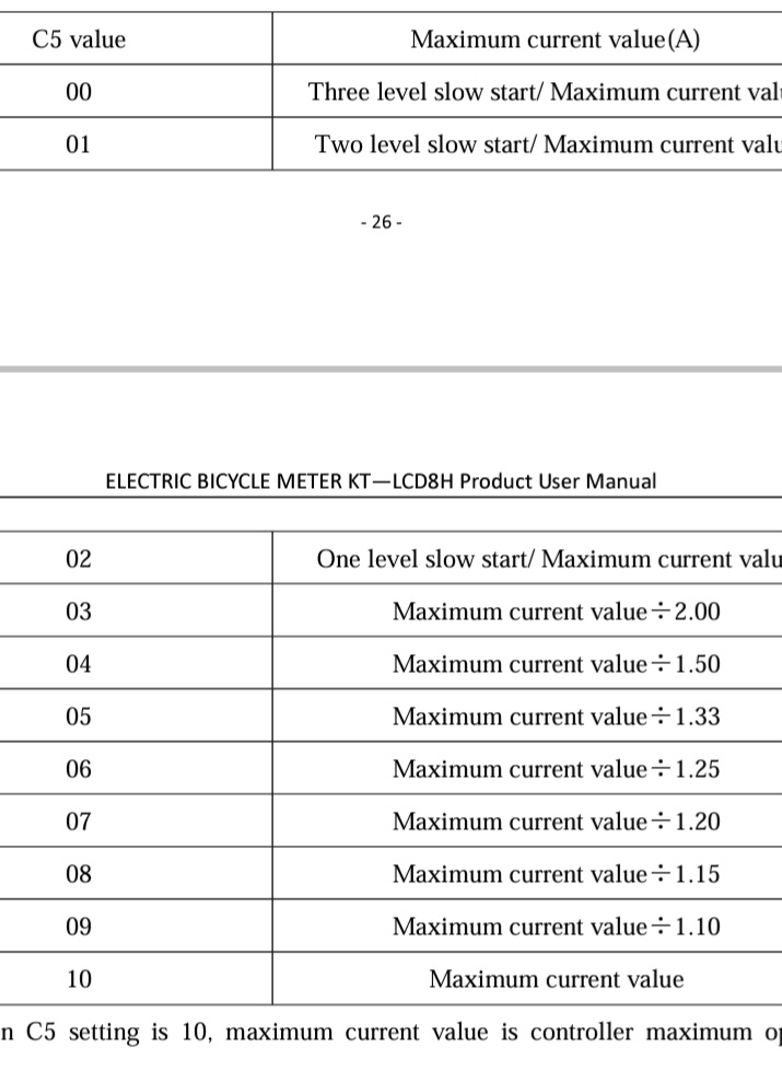

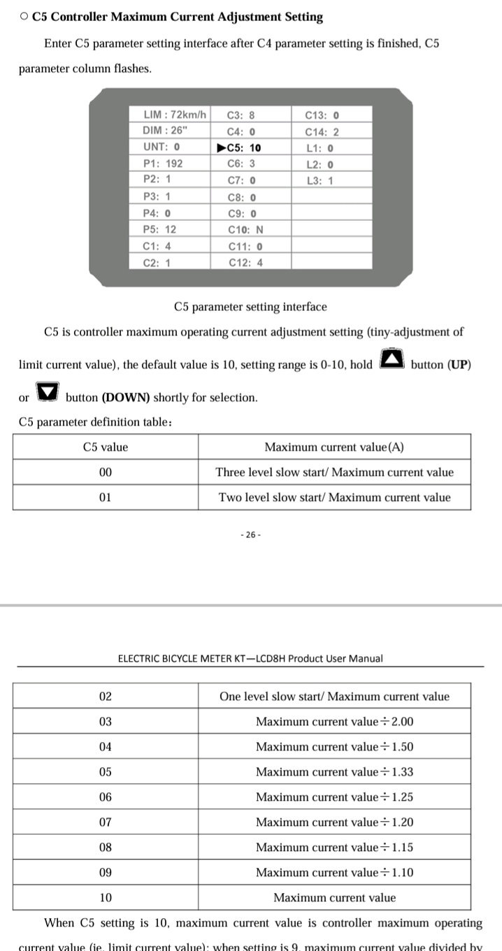

No on a more serious note I read you can turn down the AMP On the settings in the display.
Is that possible in the LCD 8 display that would be an option for me any Im sure someone will let know . greetings from the Netherlands.
Yup,..
And don't forget to turn on your imitation torque control if you haven't already.
Here's a link to a link to the User Manual,..
