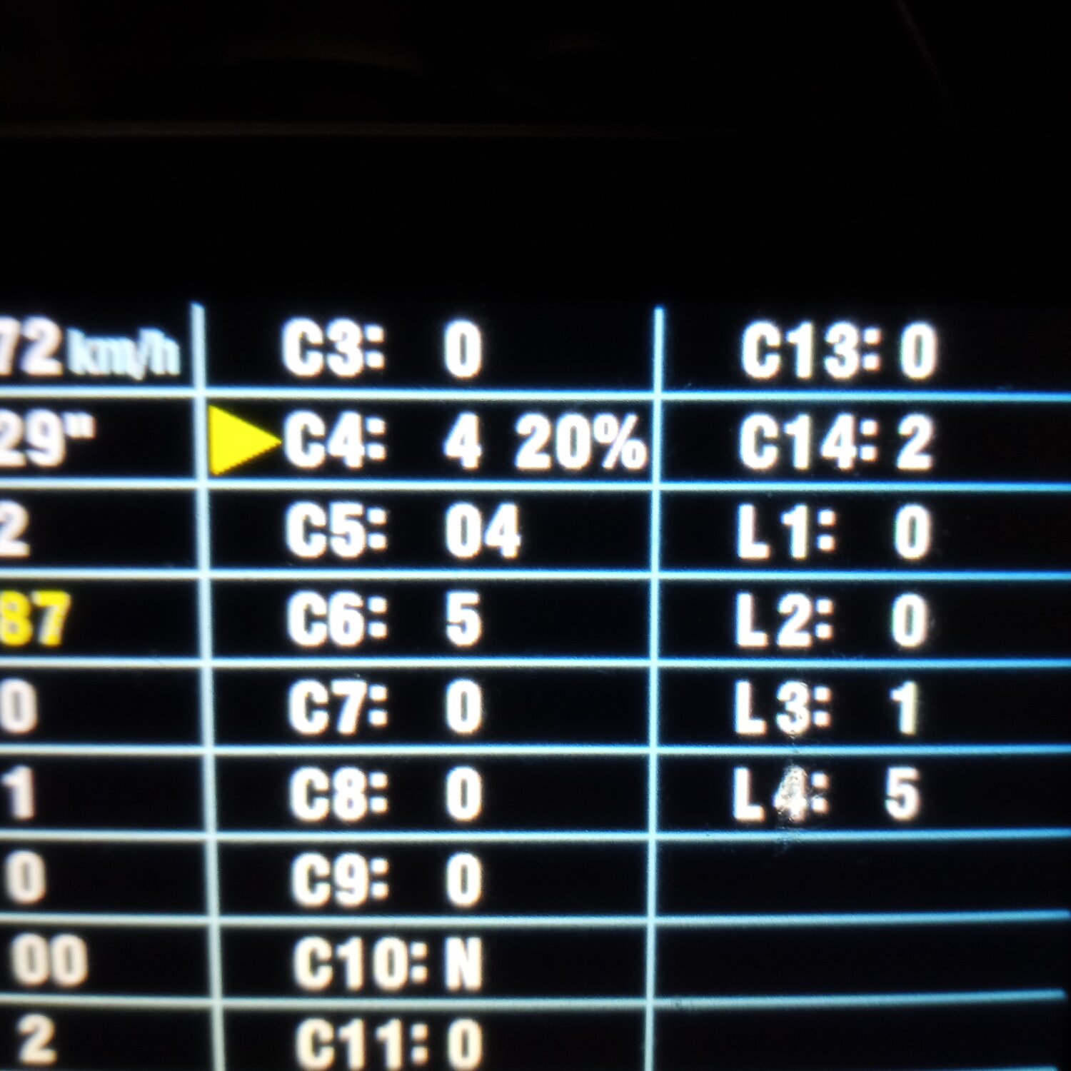

If I were you, I'd set up and use your KT controller around your 250 Watt 25 kph legal limits.
The LCD8 Display allows you to adjust your PAS modes, where PAS mode 1 is between 20% and 60% of full power.
I've turned my C4 down to 20%.
So now I get 20% power (25 amps × 20%=~250 Watts) in PAS mode 1
I go a maximum of 6 kph with the ~250 Watt limit and the higher PAS modes are proportionally more power, but I still get full power (25 amps) in PAS mode 5.
250 Watts would be around PAS mode 2 or 3 for your 22 amp controller and anything above that will make your ebike illegal with both speed and power, so you'll be well aware when you're in "Law Breaking" mode. 😂
You can see the maximum Watts being used in each PAS mode.

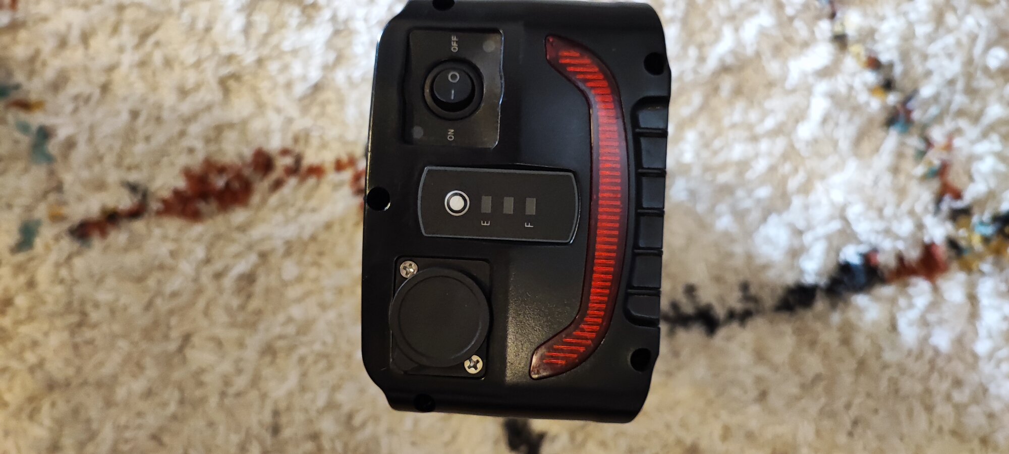

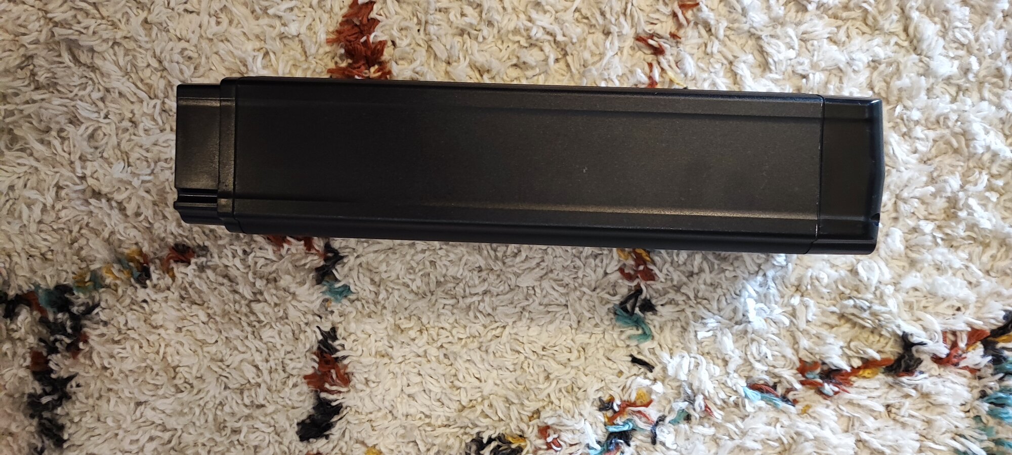

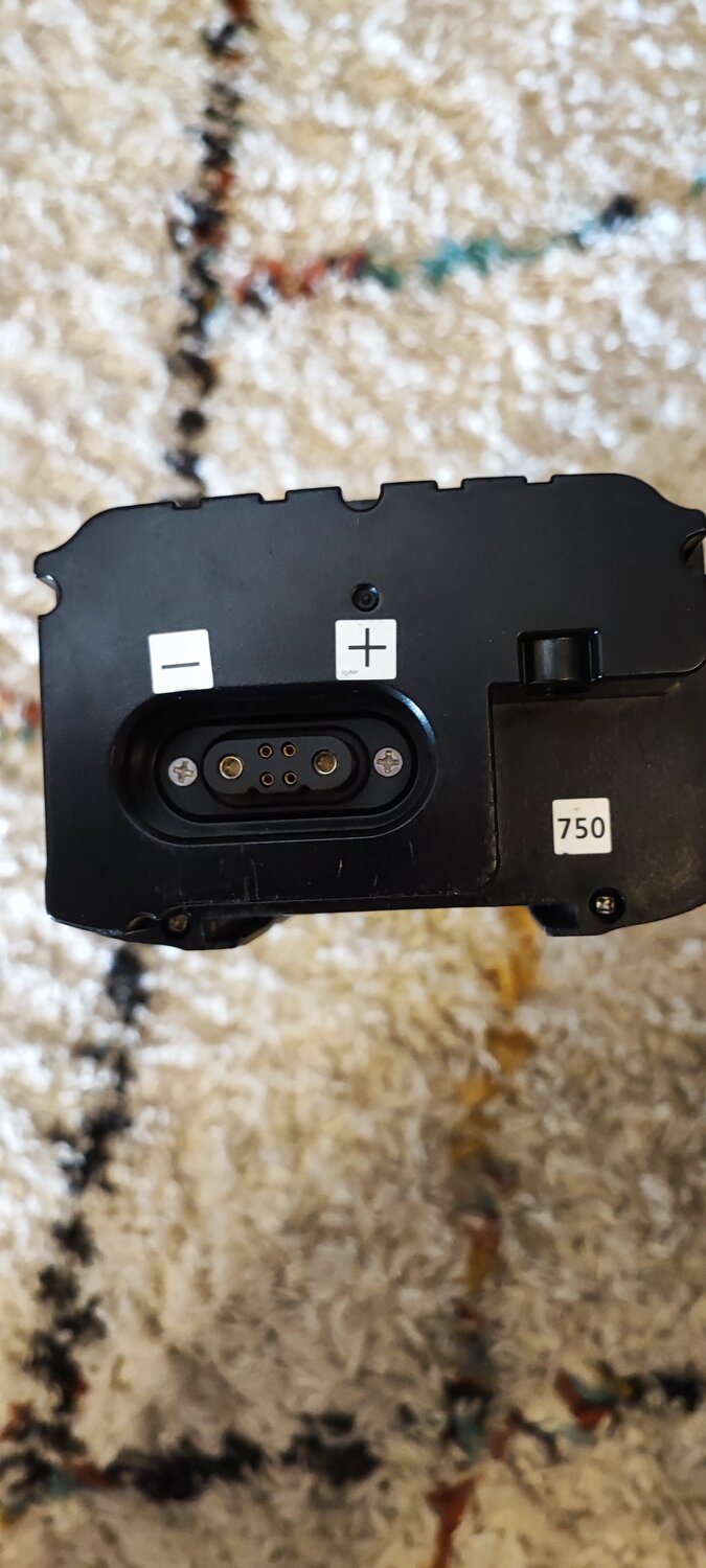

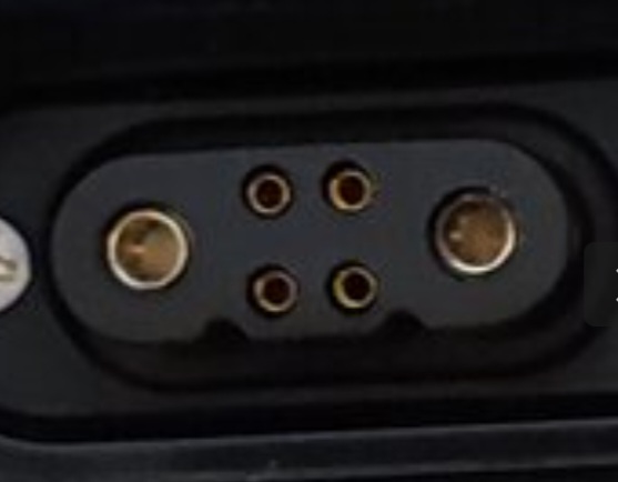

I just noticed this,..
You've got four pins in between your positive and negative terminals.
You may have a proprietary battery that only works with the ebike that it came with?
Those pins are usually used for the battery to communicate with the controller.
Sometimes the battery will not turn on unless it is connected to the proprietary controller.
Do you have any idea what ebike that battery came from?
Yes it's my ebike but changed the liushi controller that was stock for a KT controller 17a 36v48v my bike is knaap AMS
So the KT controller is installed on your ebike, and working with that battery?
OK then, you're good to go.
(Those four pins probably aren't being used)
And I found this,..

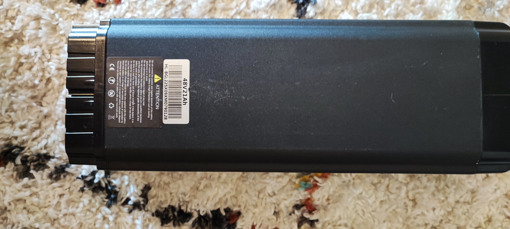

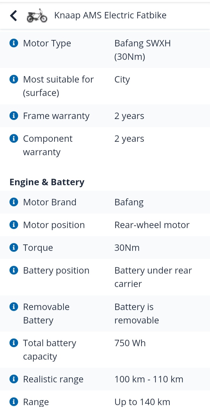

It looks like the 750 sticker on your battery means 750 Watt Hours, so it's about a 15 ah battery.

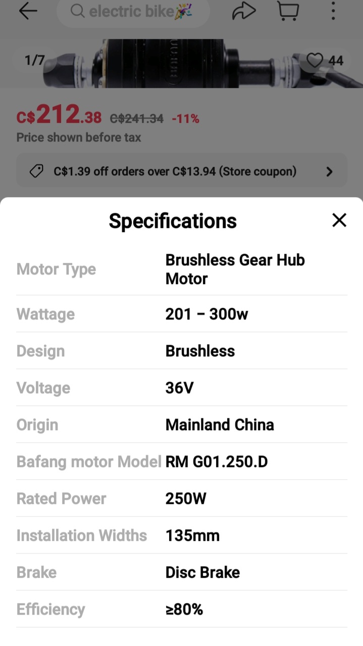

And I found this about your stock motor,..
You had a 15Ah battery powering a ~300 Watt motor.
There's a good chance that your battery has a smaller BMS, and it might kick out or blow a fuse if you pull 22 amps out of it?
And a 15Ah Battery has to work harder and gets hotter than a larger battery.
You are however currently running a 17 amp controller with that battery.
I'm thinking maybe a 500 Watt motor kit instead, or investing in new bigger battery where you know what it's got inside.
