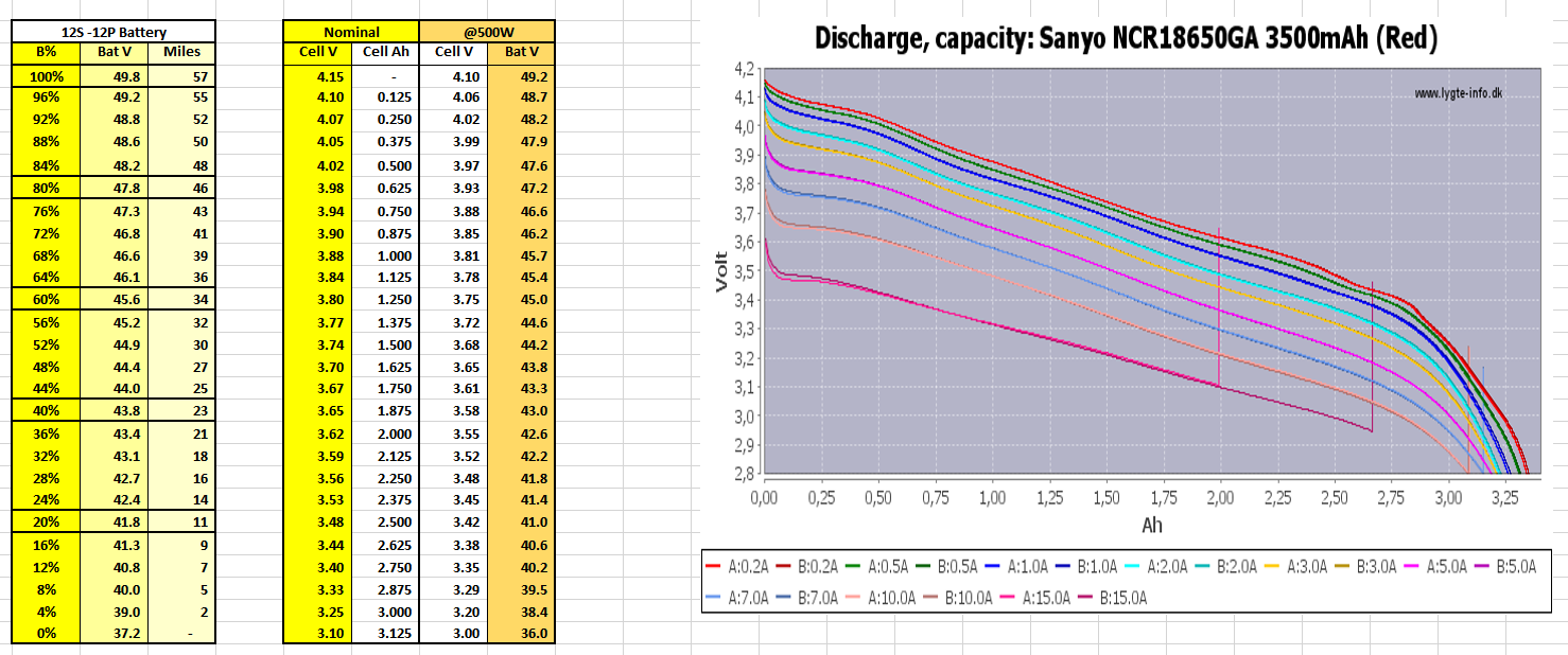

Do you know the model of the cells by any chance?
With the exact cell model, we can look for the cell discharge curves at various amp draw, and create the appropriate table to match voltage and capacity.

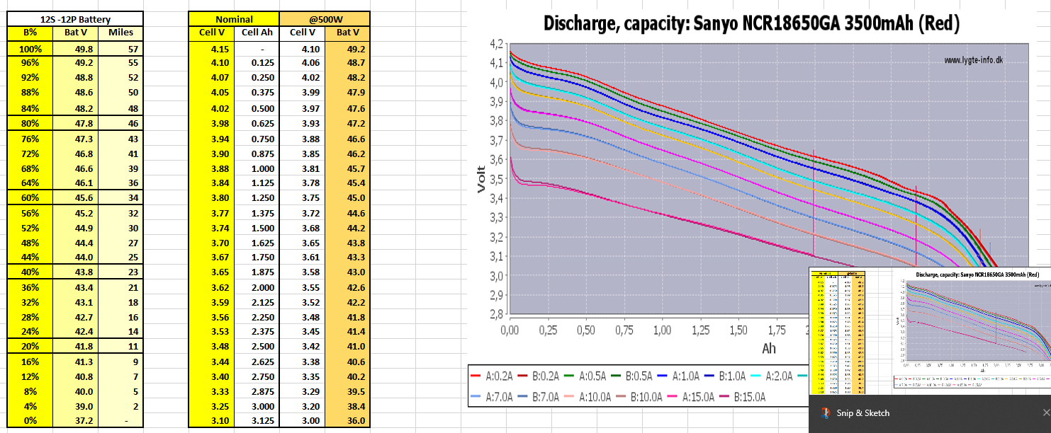

As an example, here is a table I made for my 12S 12P pack of Sanyo NCR 18650GA
