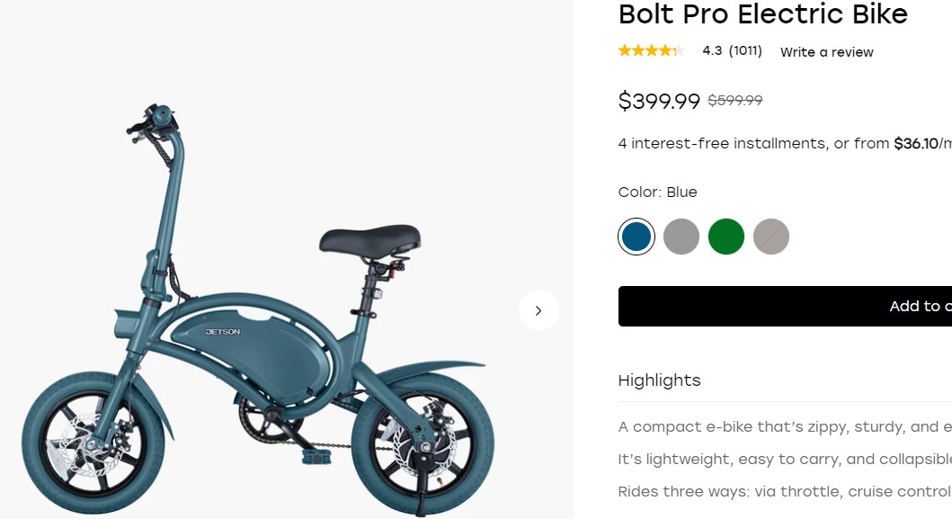

It sounds like the bike gave you a few good years of use, and now you want a bike with more power. More power necessitates better wheels, tires, frame, motor, brakes, etc. than the Bolt Pro has to offer. The bogus battery that you purchased equals 21% of what that bike cost new, and you have problems. Do not throw good money after bad.
You like riding ebikes? You want more speed? Cut your losses, don't spend any money fixing it, and very little time. Assuming you have the funds, I recommend you step up and get a bike that will give you better performance/speed.
