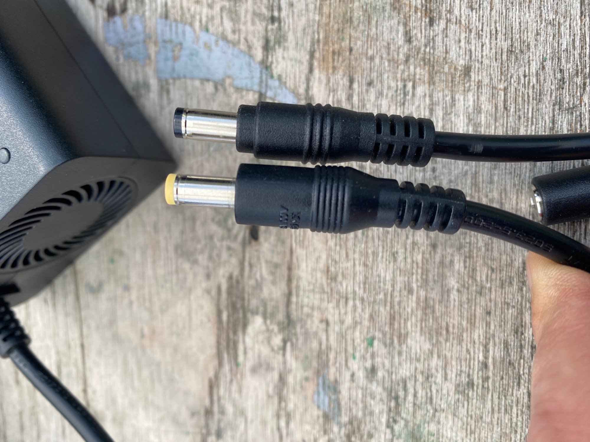

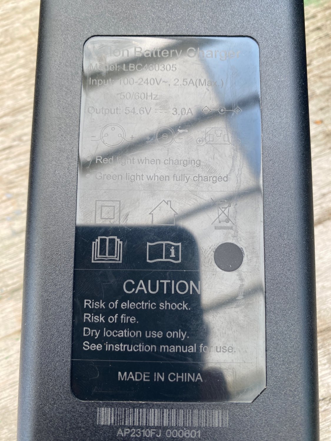

Hey all. Looking to replace my factory charger. Picked up the Grin Satiator and their DC 5.5x2.5/2.1mm barrel adapter. Appears to be a good fit, and feels like a good fit, but my battery isn't charging. I'm guessing the barrel on my battery is something else. 5.5x1.5mm? IDK. Not sure how to measure such things. The bike is a Mukkpet Ninja. The factory supplied charger appears to be unbranded but has a model of LBC480305. The battery is from LN Energy Tech Co Ltd and is the model LN-KT-E26. The yellow tip barrel is on the factory charger and the black tip barrel is from Grin (see images).

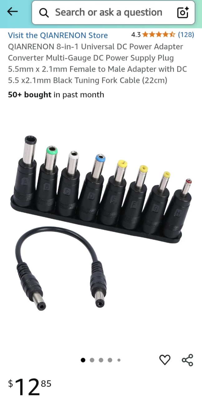

I've got 4 chargers with two different types of barrel plugs, but they all work with all three of my batteries.

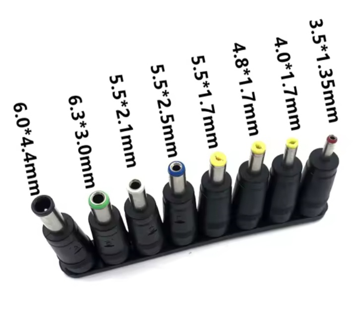

There are adapter kits available that should probably work for you,..

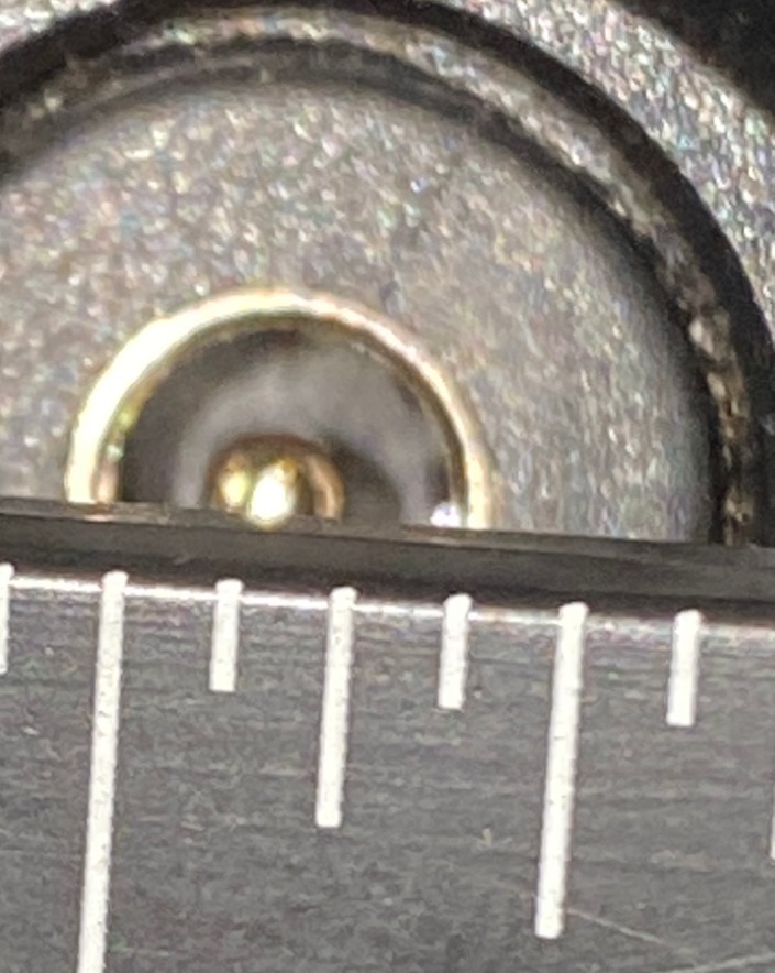

If I'm staring into my battery charge connector port, I can't see the 0.4mm difference by eye, and I found it impossible to accurately measure the internal pin.
I can't get my caliper into the port to measure the pin.

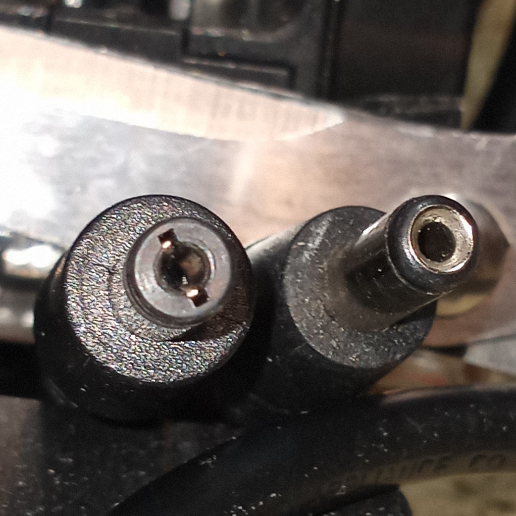

I don't know what size my internal pins are, but I have both a tuning fork type and hollow barrel type connector, and they both connect to all my batteries.
TY all! Yes the battery does still take a charge. I am able to use my factory charger. I was kinda wiggling the barrel from Grin the other day and for a moment the display shown 'charging' (or similar) so I'm pretty sure the unit works. Also, I have two, and they behave the same, so, hopefully unlikely I got two bad chargers. My battery is center pin positive and the Grin adapter is also center pin positive, so I think my polarity is good. I've attempted to photograph the pin on my battery next to a mm ruler. Given a bit of perspecitve distortion, I'm gonna guess that's a 1.5mm pin (each tic mark is a mm). Unless anyone thinks otherwise, I'll see about finding a barrel adapter that will downsize from center pin 2.5 -> 1.5. That would make it 5.5x1.5mm. Does that sound like a common sizefor the industry?

It could be camera angle but zooming in on your initial photo.. the yellow tip outside barrel might be slightly larger than the black
Quick search found this:
If that's your charger... maybe if you contact them, they may have a spec on it
I've mesured the OD on the barrel using calipers. The factory barrel and the Grin barrel are identical AFAICT. Using the drill bit size method, the OD is 7/32 which is ~5.5mm, so that checks out. The ID is 5/64 which is nearly 2mm!! o_O That 5/64 dirll bit is just a bit more snug feeling in the Grin adapter than it is on the factory adapter (probably a little looser due to frequent use). Now I'm really stumped!

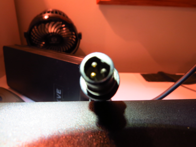

I'm running into similar issues. I want to by a satiator but can't find the plug that would fit my battery. Someone mentioned they make one called "other small three pin" but I can't find it on their website. My charger plug looks like an XLR but it is not

If you scroll down on this page, they have a list of adapters. Agree that I do not see one that looks like a perfect match. I'd reach out to their tech support, [email protected], with that pic and see if they can help. They're not too fast, but they are very helpful.
