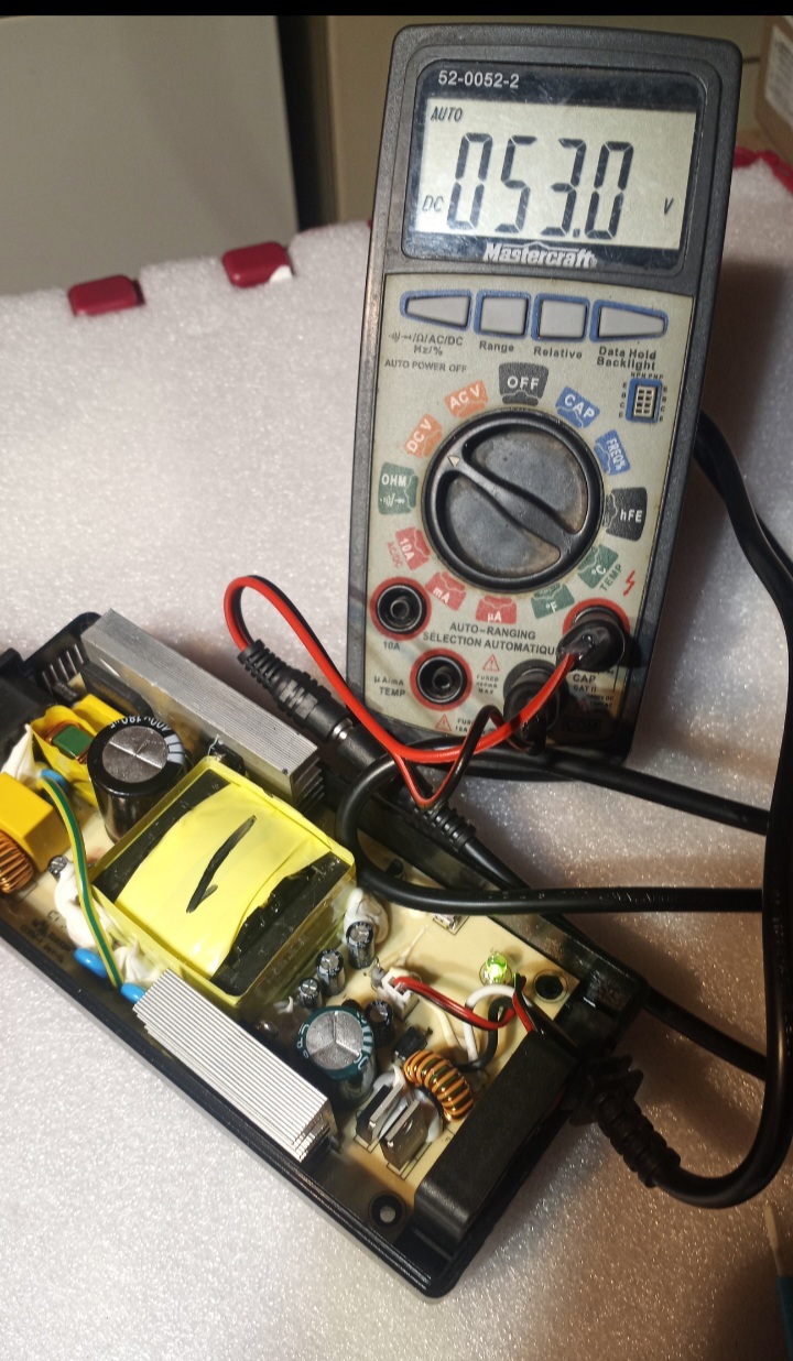

I turned my Das-Kit charger down as far as it will go (53.0 V),..
The screws are hidden under the rubber foot pads,..
I did want to turn it down further, but that's as far as it would go and I didn't want to bother changing the trim pot or adding a resistor to turn it down further.
I use it to charge to about 85% or whatever 53V turns out to be.
You should have accessible trim pots in your charger unless it's a fully potted brick charger without a fan, then you'll need a hammer and chisel to get it open. 😂

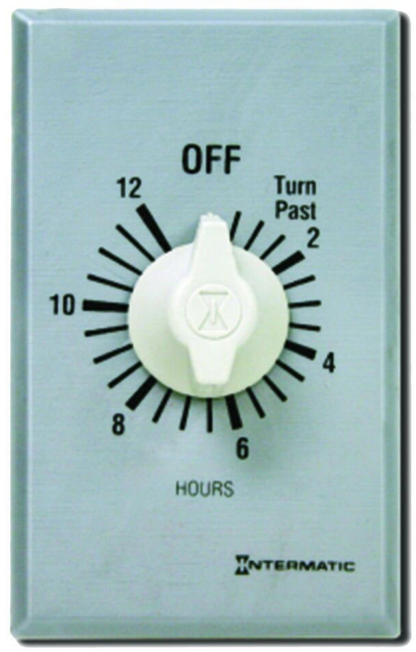

Timers are certainly a cheap and easy way to "custom" charge a battery. I used one a while back until I found the battery would self discharge back through the charger when the AC was disconnected. Only happens on one of my battery/charger combos though, but it might be worth checking yours. Of course it isn't an issue if you remember to disconnect the charger from the battery.
As a result, before I bought the Satiator, I used this 2 pole twist timer so both the AC and DC sides of the charger could be disconnected.
It's also mechanical and immune from AC line issues, which can cause unexpected results with electronic timers.
