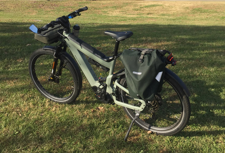

I just have the one pannier made by restrap.com, their smaller size. It clips on and is securely attached.
How can you know if a pannier like that will work with this rack? I don’t see any mounting system named. Is it standard so any clip type pannier will work?
That is the Superdelite rack (not the mudgard one). The pannier does not use the MIK attachment but if you look at the pannier on the Restrap website the video shows how it attaches. There are other makes which use the same style of attachment.

I just ordered a Ortlieb Velo Shopper. I don’t really need HD waterproofing, and prefer the easier opening top. I do like the look of their QC-2.1 attachment system.
