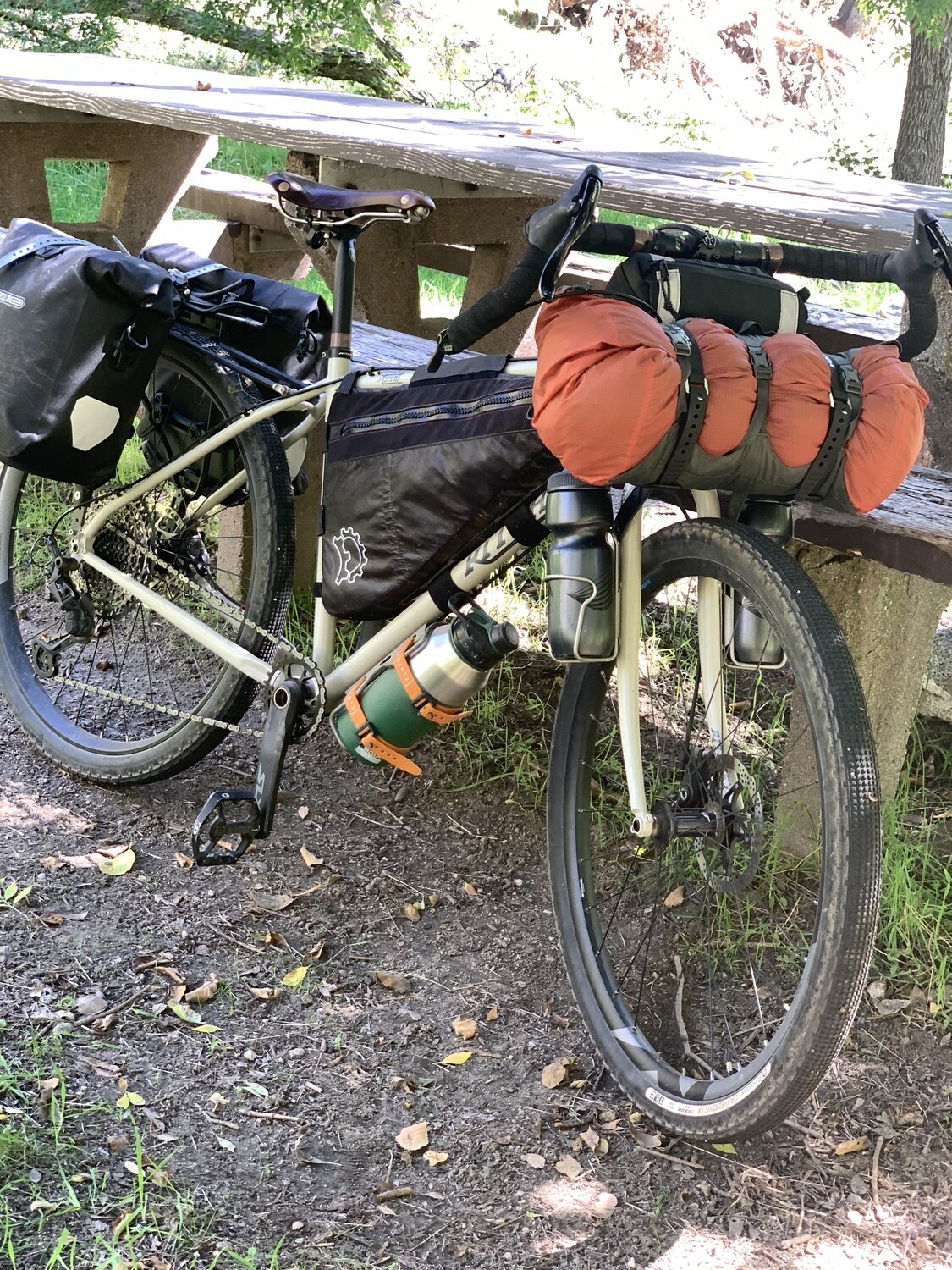

I'm in the process of changing my touring configuration. Right now my setup is:
Now this configuration has worked fairly well, but over time a couple of issues have came up. The biggest one is that the Roll Top Panniers are too big, too heavy, and they put way too much weight at the rear of the bike. Depending on the terrain this can make the bike handle poorly, sometimes very poorly.
So what I am thinking is going to smaller (about 10L to 12L) rear panniers, an overflow bag, and anything cage mounts and dry bags on the front fork.
I'm thinking of this anything cage mount from Wolf Tooth, mostly because it looks cool:
www.wolftoothcomponents.com
And I can put different dry bags on them depending on the kind of trip. For lighter trips I'll probably use these small Mountain Laurel Designs bags. I already have one of the 1.6L bags that I use as an overflow bag on tour or on backpacking trips, they are very light and very well made. So I reckon for fast and light trips I will go with two 1.6L bags.
mountainlaureldesigns.com
When I'm carrying heavy I'll probably use these bags from Tailfin.cc. The 3L bag seems to be about the right size for what I have in mind.
www.tailfin.cc
Now for rear panniers. I ideally want something around 10L to 12L. I've got some eccentric criteria as well from things I've learned from experience, but I have found three different panniers that all probably fit the bill. None are perfect and all come with tradeoffs.
These Junior Ranger Panniers from Swift Industries are probably the best all-around choice. But they aren't currently available and are far and away the most expensive. On the other hand, I 100 percent know those panniers will work out fine for me:
builtbyswift.com
Now this inexpensive pannier from REI looks very promising and will probably work. It lacks some features the Swift Pannier has (mostly the big rear pocket and the big side pocket) but I could more or less make it work:
I also found this very interesting pannier from Sim Works that could also work. Again it lacks some features of the Swift Pannier (it has a zippered closure unlike the roll top closure of the Junior Ranger and Link Pannier above). On the other hand, it has an absolutely huge mesh pocket which I think is a fantastic idea.
www.sim.works
I'm also going to carry a larger overflow bag, probably a larger version of the Mountain Laurel Designs dry bag that I carry on the cage mounts. The overflow bag rides on the top of the rear rack when in use, otherwise it gets stashed in a pannier:
Now here is where it gets interesting. The REI pannier is probably more weatherproof, but that usually doesn't matter much for me because I keep the stuff that absolutely needs to keep dry in plastic bags (sometimes I just use a laundry bag as a liner inside the pannier). Also interesting is that the REI pannier and the Sim Works pannier are both sold singly, and two of them cost a little more than half as much as the Swift Junior Ranger pannier set.
So I am going to do something weird. Something that will probably make all of the other bike tourers point at me and laugh.
What I'm going to do is have the REI pannier on one side and the Sim Works pannier on the other. I'll probably keep the Sim Works pannier on the drive side where it won't get as much road spray.
Those are my thoughts at least for now. If it doesn't work I'll be selling some used panniers online somewhere...
