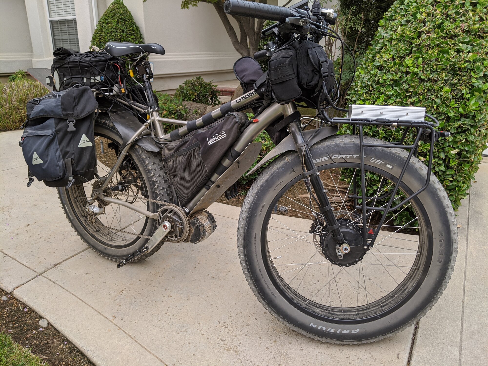

Man, you guys keep some immaculate fat bikes! Beauties, both of them.
HAH yeah thats what you're supposed to think. I take pictures when the bike is brand new, before I ride it for the first time. They're never that clean again.

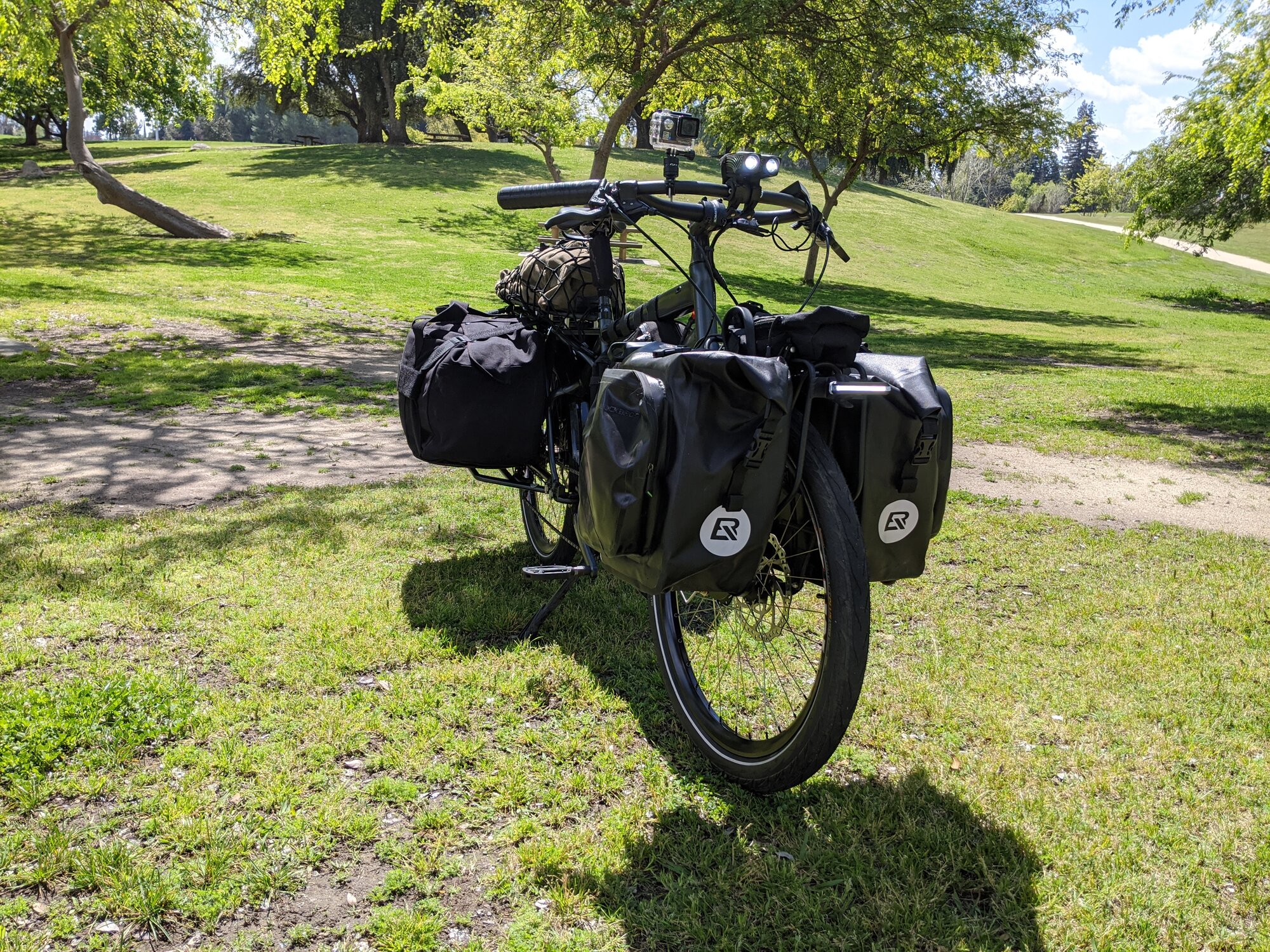

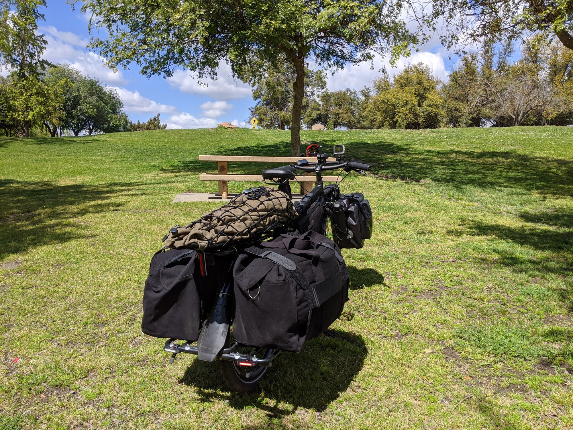

A couple of shots with the bags on front racks.
This one looks impressive carry but I was donating two old double sleeping bags and a couple of pillows, so not the heavy load it appears to be.

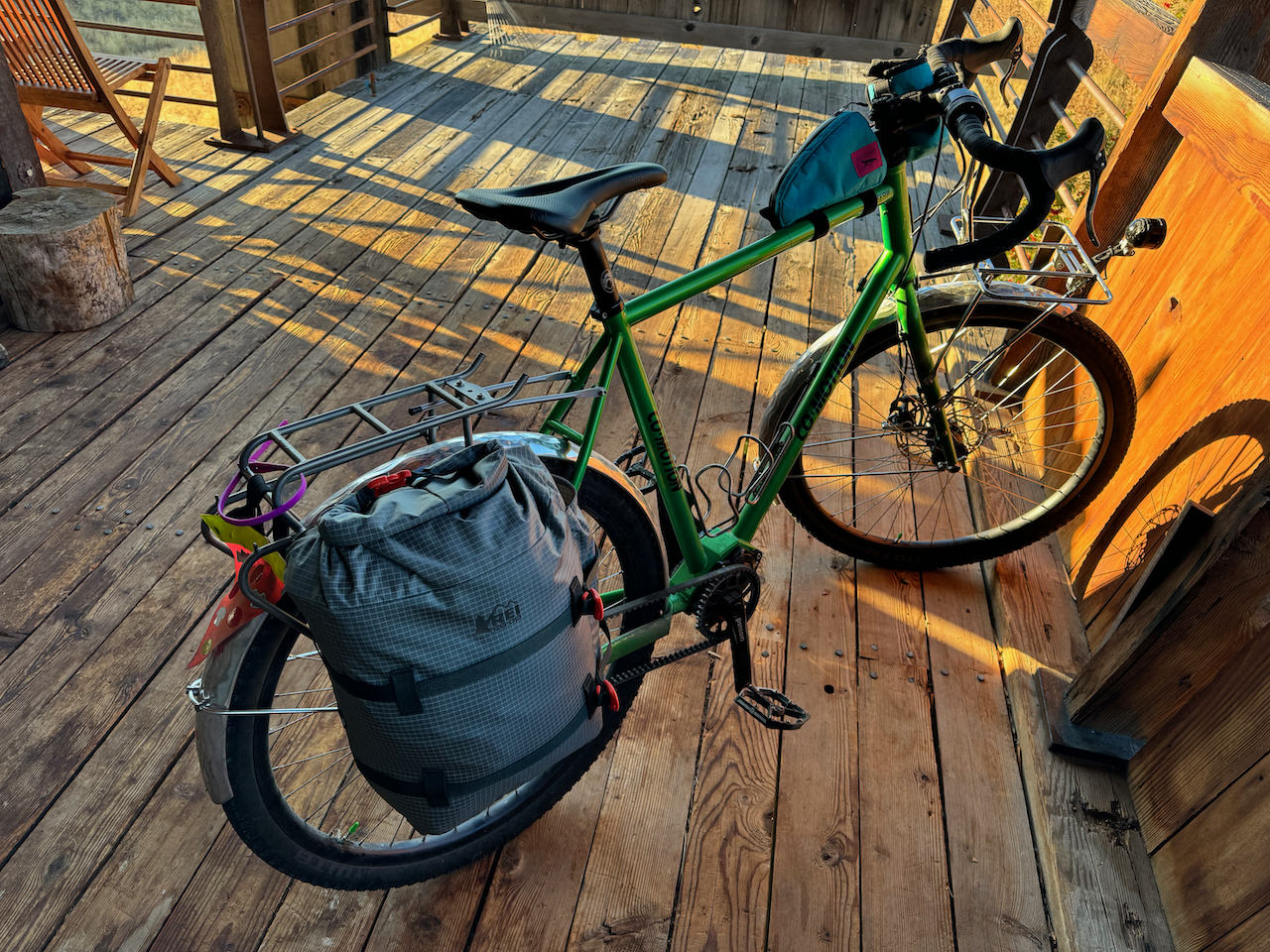

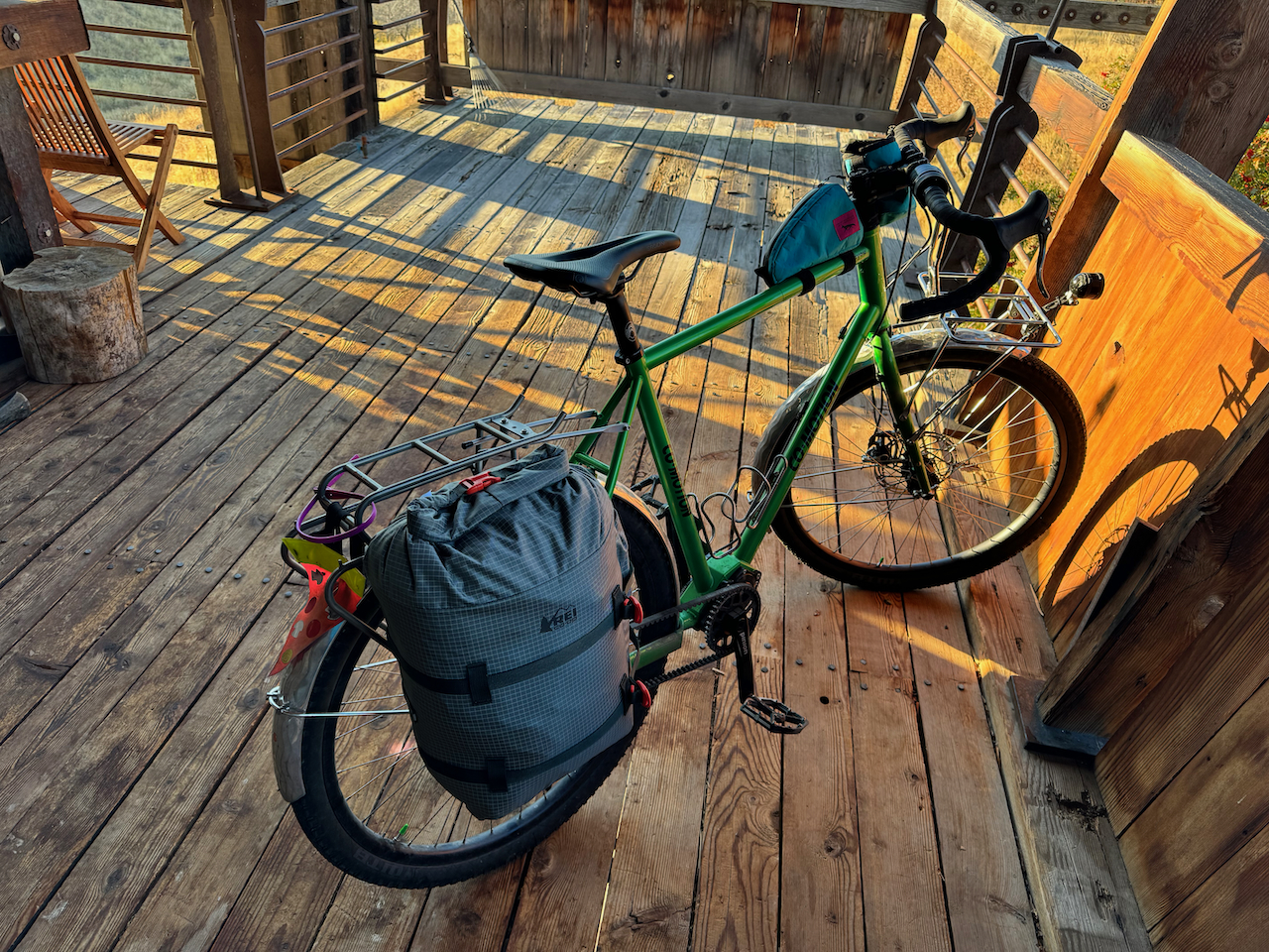

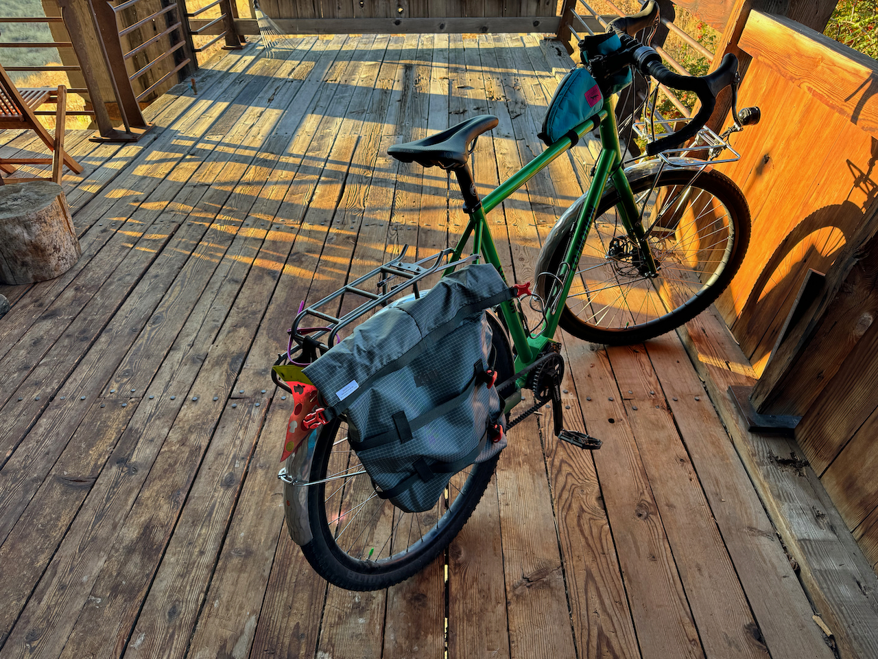

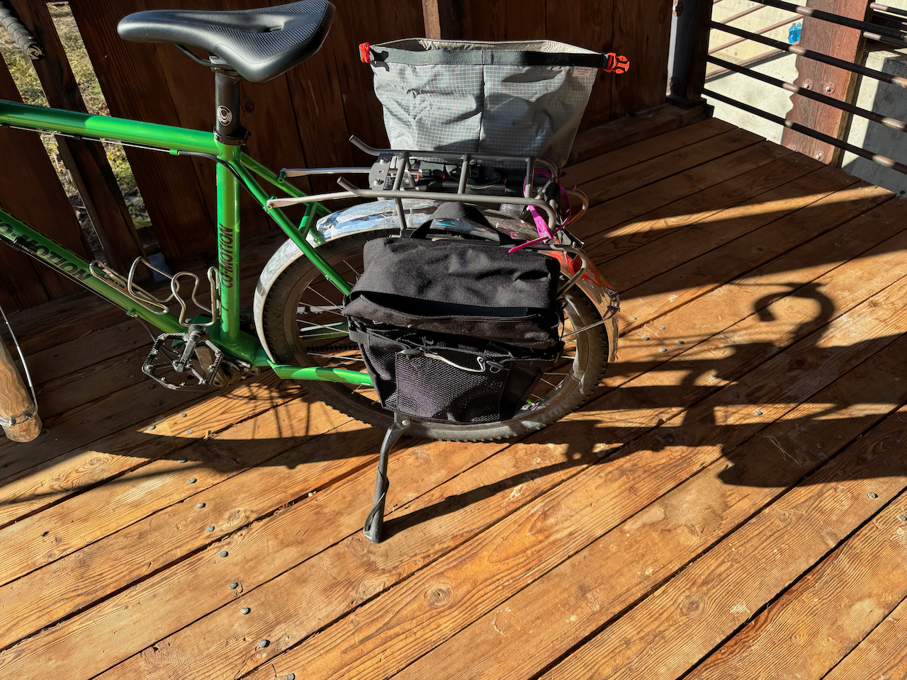

Okay, here is the new REI Link II Pannier empty and mounted on the drive side:
It is mounted on the lower pannier rails because (A) it fits there, (B) it gives me a lower center of gravity, and (C) it frees up the top rails for strapping an overflow bag and other stuff (e.g. soggy wet stuff). Since this is the drive side pannier I intend to put stuff in there that absolutely needs to be kept dry and is unlikely to be needed before I get to camp that evening. So things like my down quilt, sleeping pad, spare socks, inner layers, &c.

This is all of it overstuffed into that tiny pannier:
Now that was most everything, but it wasn't a realistic carry because I don't cycle just in shoes, a helmet, and sunglasses. I need to wear some of the clothes jammed into that pannier. This is what it looks like with typical ride clothes removed:
Hard to tell really but I was able to get a couple more rolls on the roll top.
Now in practice I will carry some of that in a dry bag on the front as well. Also in practice there might be some additional small items that ride along (the cable and charger bag is in there, but there might be some other small items).
With the 5L front drybag I can easily pack the sleeping pad and a bunch of clothes forward, which leaves plenty of room in that rear pannier.
The bag looks good but I'm not super impressed with the external pocket.

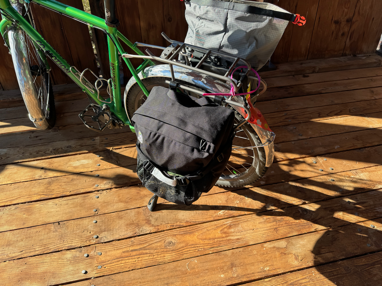

The Sim Works EX Loader arrived yesterday:
All this stuff just barely fit into it:
I had to put the tarp and tent stakes in the mesh pocket. Which is fine for these purposes.
My own feelings right now is that, yes, I could make this work. But I think I like the Link II Pannier better and think it will work better for my purposes.

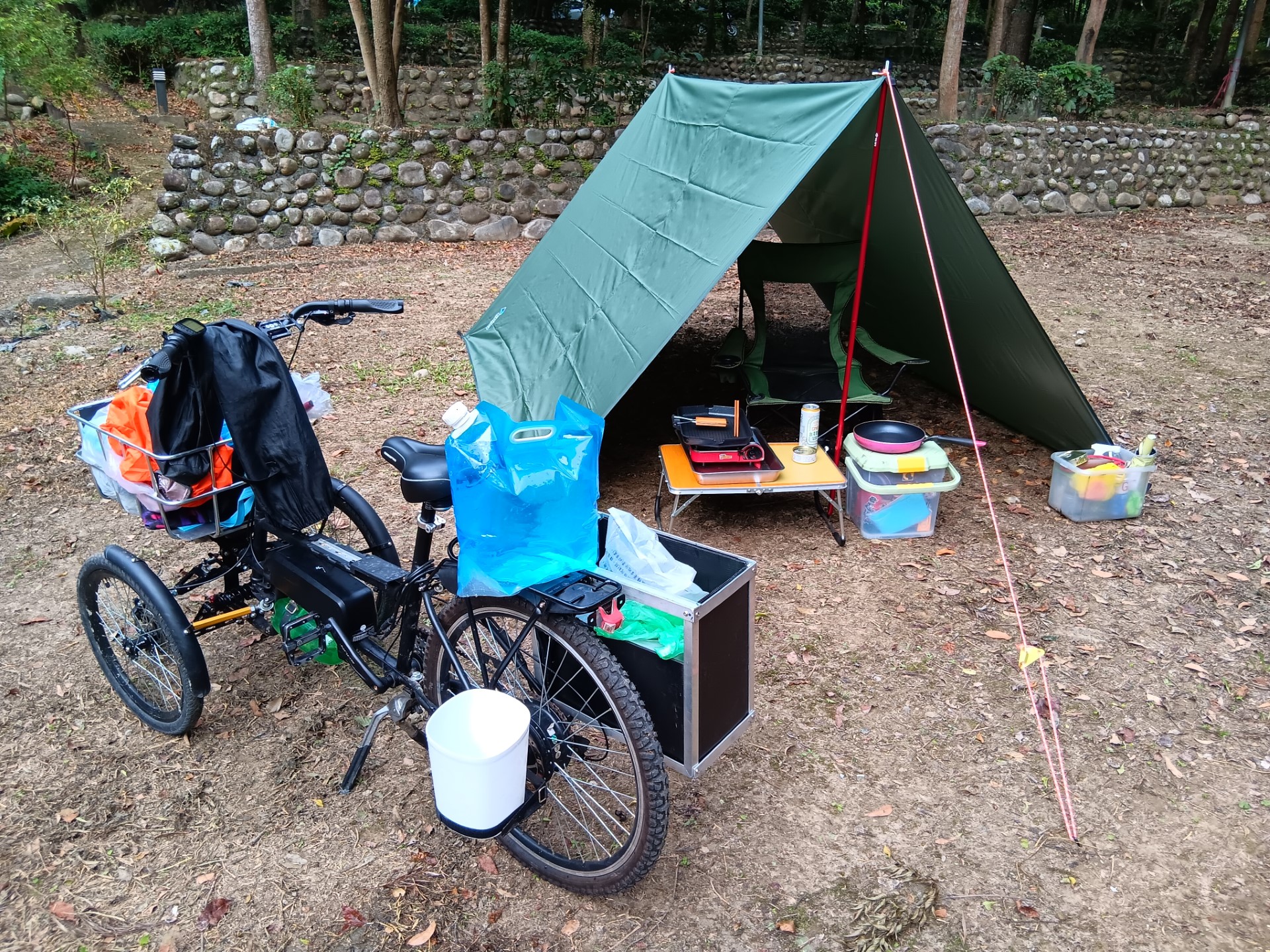

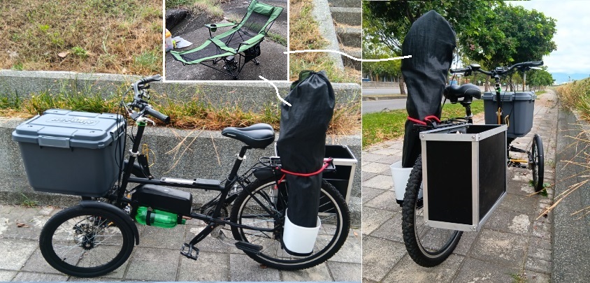

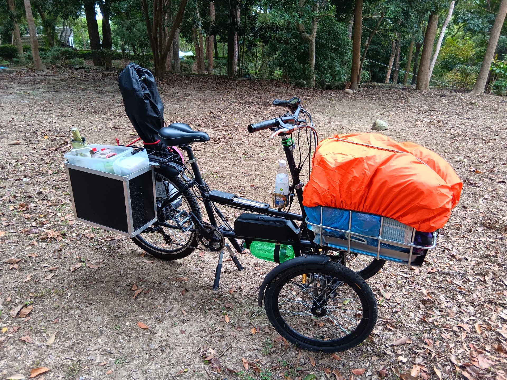

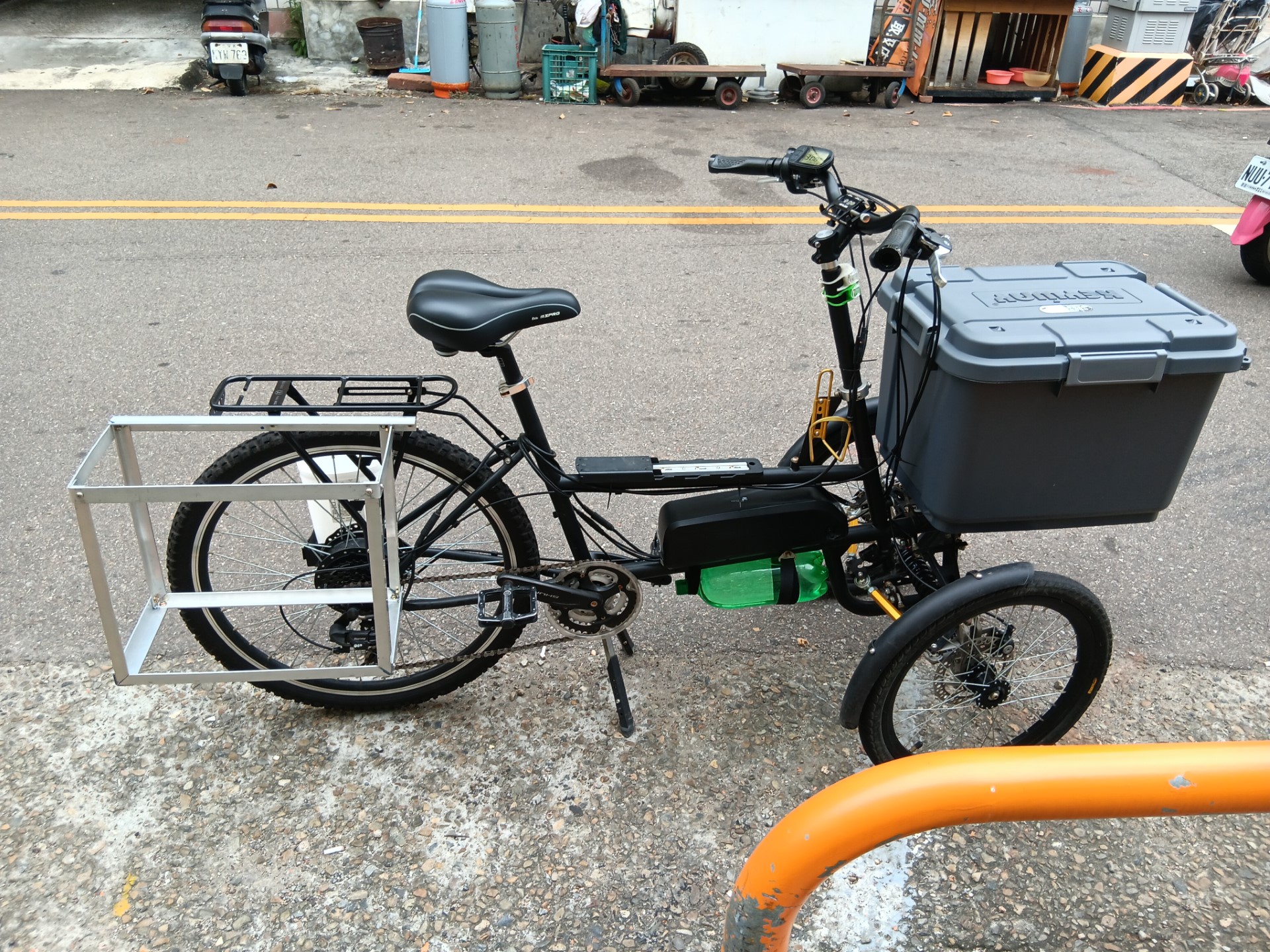

I built the box several days ago,use only hand tools and a electric drill
The box can carry a 800w mini generator if needed
