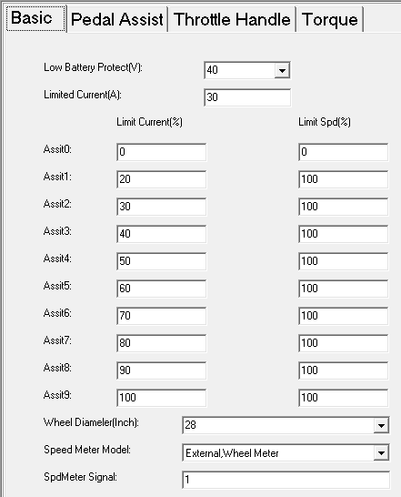

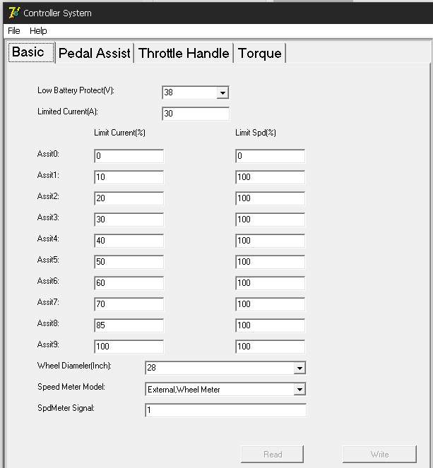

I compared the FREY stock settings from my controller (have a AM1000HT) and settings from here. I changed some values. The first rides where ok for me. I use the bike 99% on the street for work.

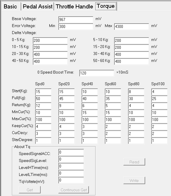

I read here that you should set the "Base Voltage". The lowest was 757mV and the highest I read was 1177mV, so I set it to 967mV - is that not to high?
My current settings:
I'll be honest, since going with the "Smooth" tune and riding that for a bit, I've stopped thinking about a lot of this. I do know that the earlier (BAFANG OEM)"torque" settings resulted in torque sensing that was pretty much turned off. My riding impressions confirmed that. After installing the "Smooth" tune, I am continually impressed by the overall "finesse" of this programming. Torque sensing not only very responsive, it works over a wide range of pressures. If the bike is in PAS 2 for instance, it's easy to see anything from less than 100w going to the motor, all the way up to something like 400w if I'm remembering right. That makes the Ultra much more forgiving to ride if you don't feel like being right on top of it - more of a brain dead cruiser?
My "Smooth" setting do vary from what you are showing, all across the board. Better or worse I have no idea. My base voltage (as shown in my notes) is still the default -0-, which could be wrong (not verified).
So the Smooth torque page would be what I would compare to your existing settings.

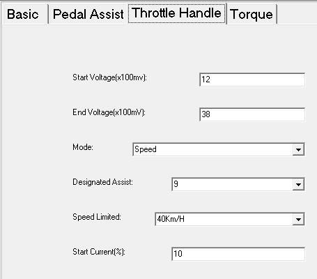

On the throttle handle page, I have my start and end voltage set at 10 (1.0v) and 40 (4.0v) for max throttle resolution.
The rest looks pretty close to what you have shown.
