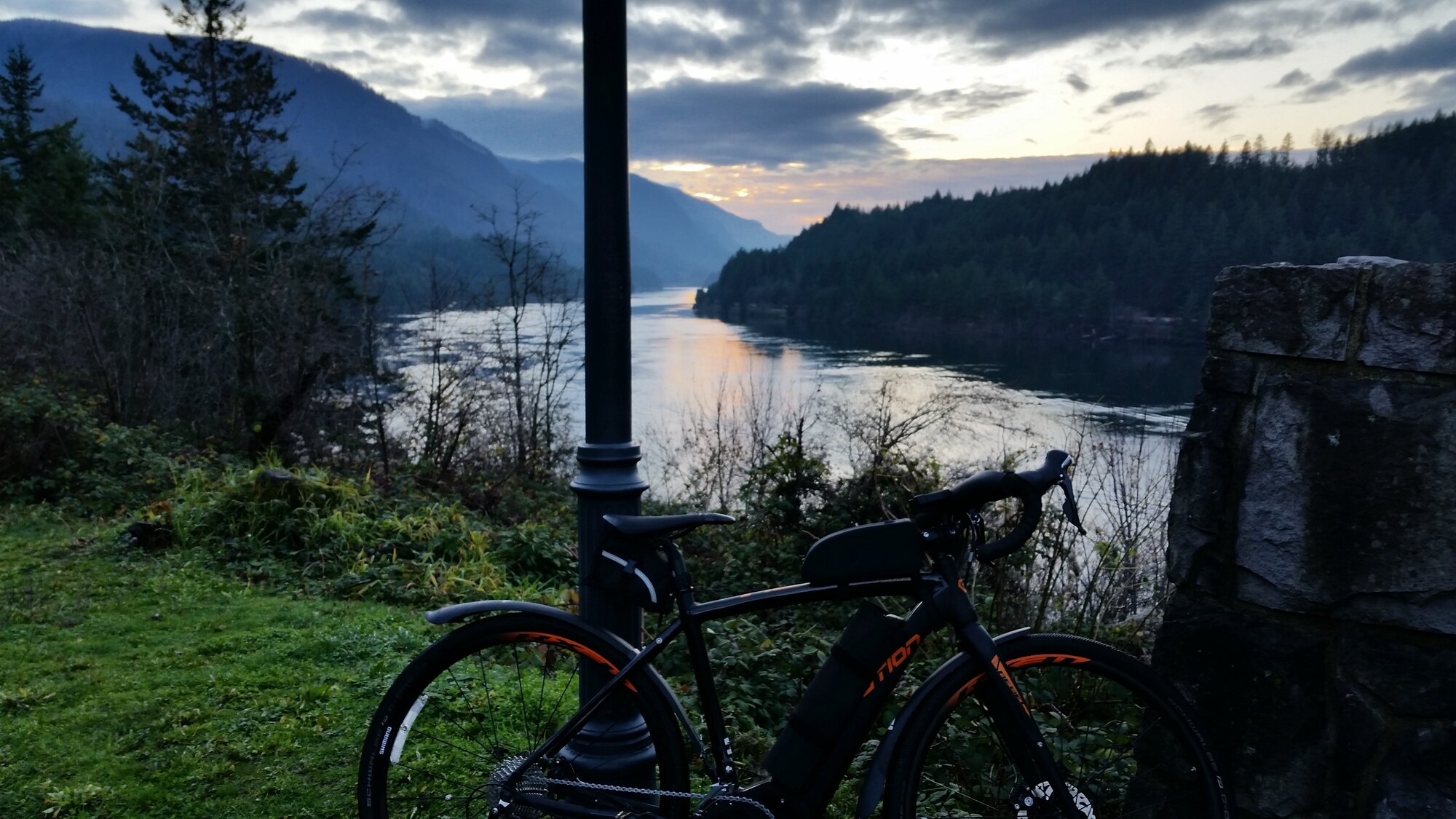

BH Gravel X that I bought on a whim deeply discounted from bicycle blue book when they were clearing out inventory after BH left the North America Market. It's really a great bike with 2x11 105 drivetrain and Yamaha drive unit. I've ridden it in Oregon, Washington, Utah and Arizona on pavement and gravel with the vast majority of miles on the stock Schwalbe G-One "Allround" version. I've made some changes over the almost 5 years that I've had it, mostly because I mess around with all of my bikes. No issues with the Yamaha drive (or battery) which I think provides powerful assist but also with very good range, especially when ridden in the lower levels of assist.
Here it is when I first got it Nov. '19 on a local(ish) ride. Ignore the neoprene wrap I had on the battery - it was a cold day in the 30s to low 40s and I thought it might be a good idea to insulate the battery some.
