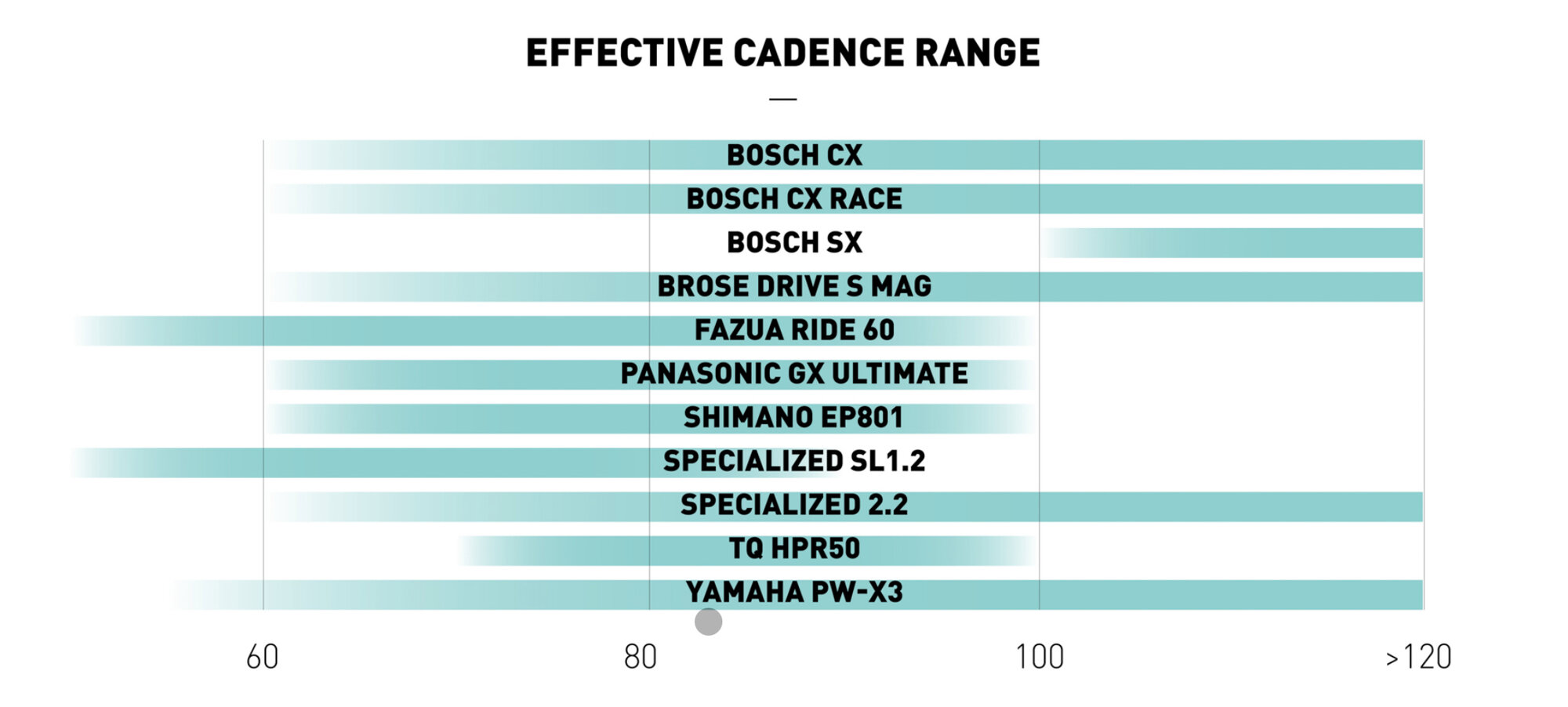

Fun info about motors: https://ebike-mtb.com/en/emtb-motor-comparison/
I have been using the chart about cadence and power production from the above url. I attached a screenshot for convenience.
I have ruled out the bosch SX line because I simply can’t keep pace with the rpm where it works well. I am concerned about fazua because of continued reliability reports. But I don’t have super current information. That motor is on a lot of interesting models including a few that would probably be an easy buy if I can get past the motor issues.
Bosch cx smart system, Specialized 1.2 and 2.2 (and brose), Shimano and TQ all have a reputation for a smooth and natural experience. All of them have ways to get data out of the system (Bosch finally integrates that data at least up to strava I think, but still trying to see that for myself). The tq support might be right on the edge for me. I tend to grind up hills not spin. But I also have no choice because my gears don’t go low enough to spin at a higher RPM. So, I will be grinding in my lowest gear.
