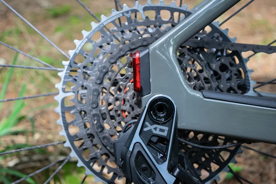

I think the Canyon Grizl:ON might be an option if Bosch is back on the table. I can't see anything about it being UDH, but the Trail spec sold in Europe comes with a X0 T-type derailleur which I think means Transmission?
I've been lusting after the CF9 with Force XPLR groupset, but if you are swapping the whole drivetrain the cheaper CF7 with GRX would might make more sense.
I don’t see any indication that the US model has UDH. IF it does, it’s a silent feature. Like the skitch comment below, short travel fork is an unknown.

Not so sure. I am concerned about short travel fork. It’s longer than future shock, but I have no way of knowing what travel is enough. Future shock is bad, and whatever is on the vado (80mm) is sufficient. I also haven’t seen any evidence that fazua has gotten over it’s reliability hurdles. Honestly, if that motor becomes a possibility, about a dozen bikes become viable. A lot of brands use it. I was eyeing an ari early on. They make a fazua based model and an ep801 based model (actually two).
