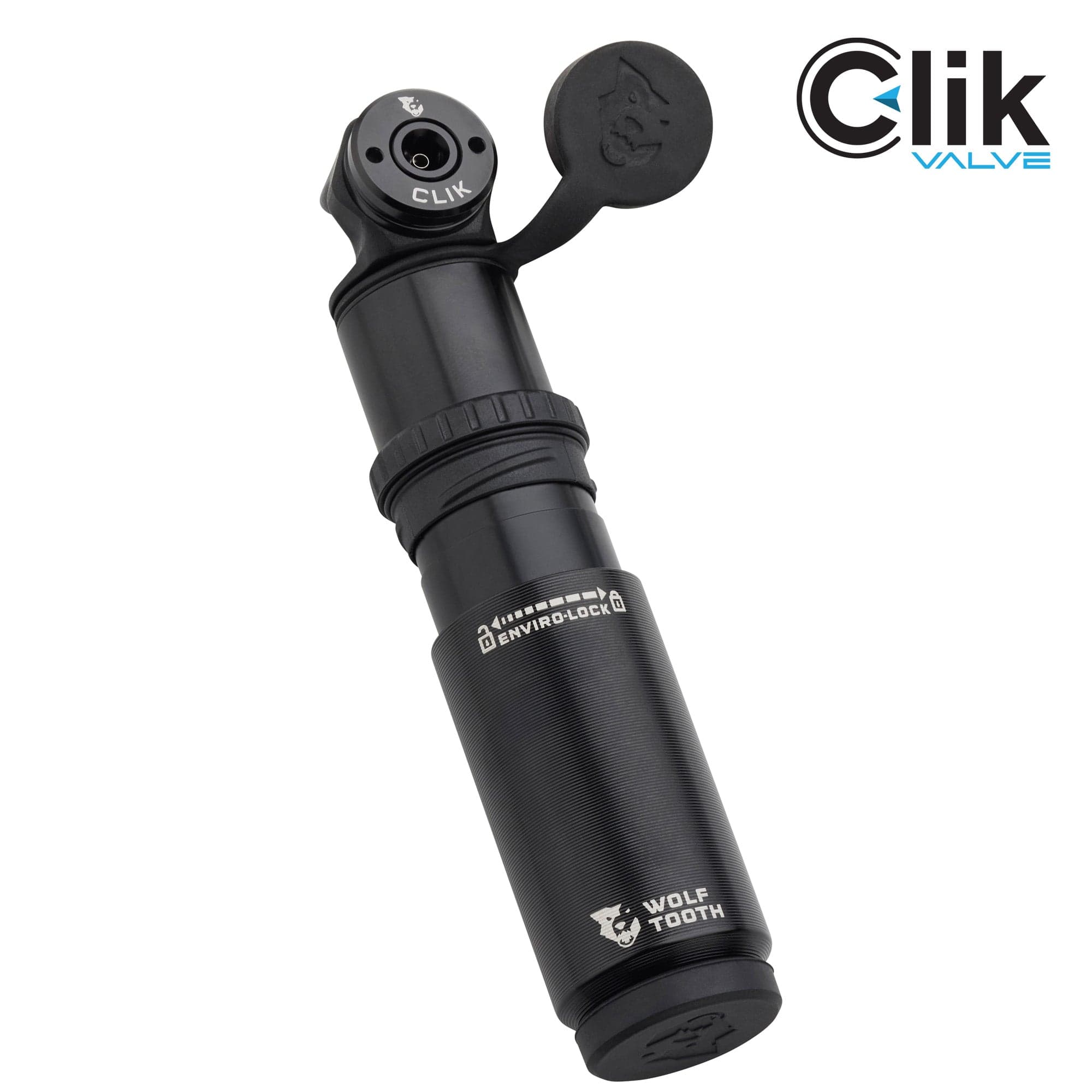

Awesome to hear about the customer support, and glad you have it sorted out!I got my Clik valves and after a glitch have them installed and working well. First, the glitch:
I got two valves and the pump head replacement with the adapter that can be used independently. I tested one valve out on my tubeless tire and it leaked at the pump head connection. I pumped the tire up but watched the pressure drop on my pump gauge when I stopped pumping. I removed and reinstalled the Clik, fiddled with the pump and pump head but still had a leak. I emailed Clik describing the problem and they replied within hours saying they were sending me two new valves, a new pump head adapter and some aluminum valve caps. A++ for customer support!
The new ones came today and I put them in and it works perfectly! I’m using the head adapter in my standard presta/schrader pump head - push it in, flip the lever up and use it that way. That makes it easy to use my pump on other presta or schrader valves - just flip the lever down and pull the Clik adapter out.
I’ll try the first batch of parts again when I get a chance but I think it may have been my error. The Clik valves thread into the presta body but then need a full revolution or so using the supplied tool after finger tightening. I’ve learned the hard way not to cinch presta cores in too much so I may have not put the cliks in tight enough.
My biggest irritation with presta has been connecting the pump cleanly so the tire doesn’t lose a bunch of air, either when I put it on or when I take it off. It’s always a pretty iffy process for me. First world problem.
The Clik adapter snaps right on without losing any air. And it unsnaps without losing any either. Seems like a winner!
