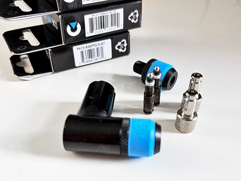

so here's what i got
one pump head replacement, one pump adapter, and then a bunch of sets of the presta valve cores (cores only) and schrader adapters.

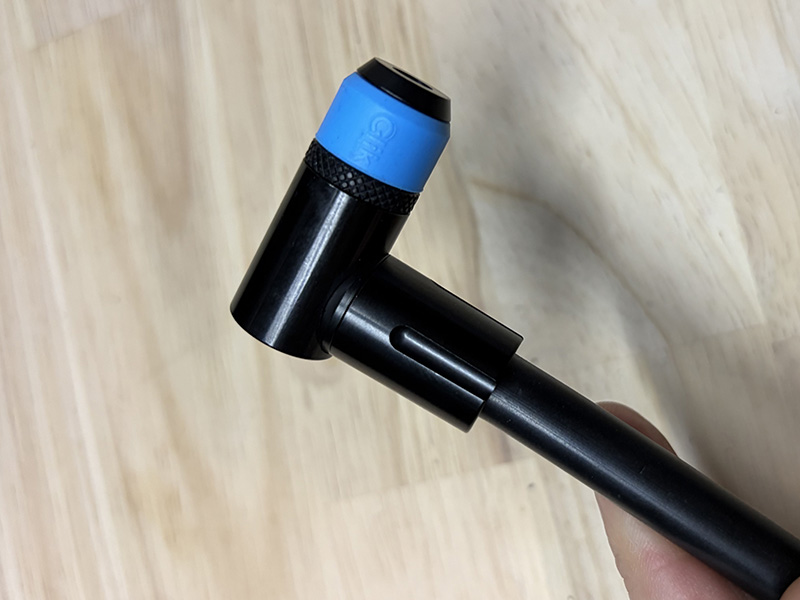

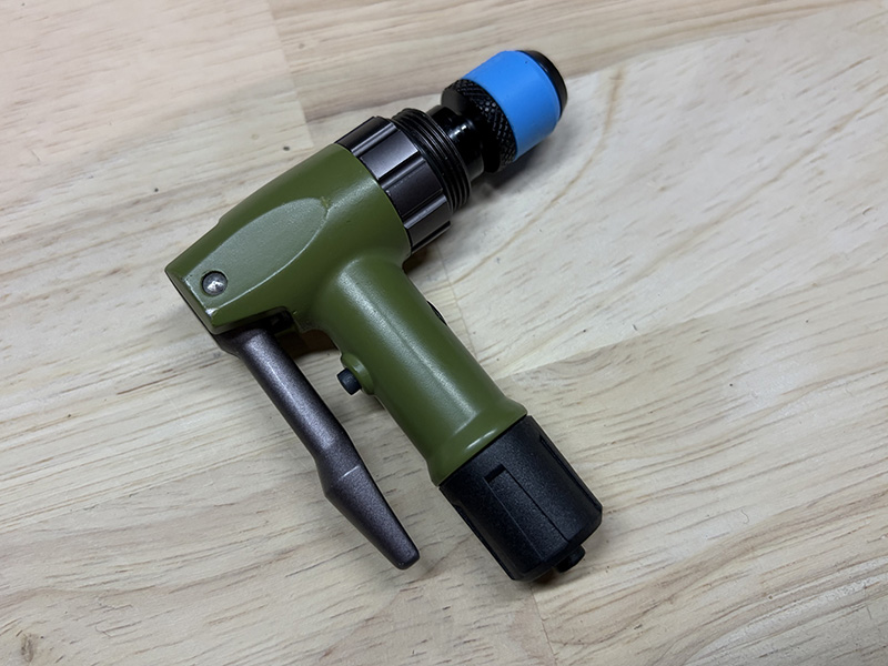

for those who even remotely care about elegance or aesthetics in the little things, do NOT do this. this is what my pump head with the adapter looks like. barf.
thankfully, the hose inner and outer diameters were the same, the stock one (which is super nice!!!!) removed easily, and the replacement also went on easily. very nice.

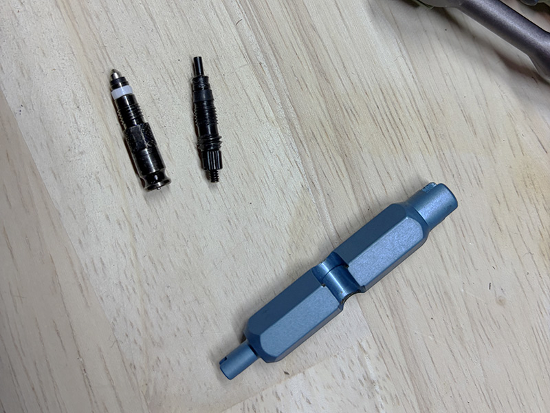

next step, remove existing valve cores. of course i took the opportunity to top off the sealant in the two tubeless bikes, which i always do with the cores out, so i have no idea if you could force sealant through these things and frankly don't understand why anyone would do that. here's a comparison of the clik valve core (left) and one of the removed ones (right). note the valve core tool i prefer.

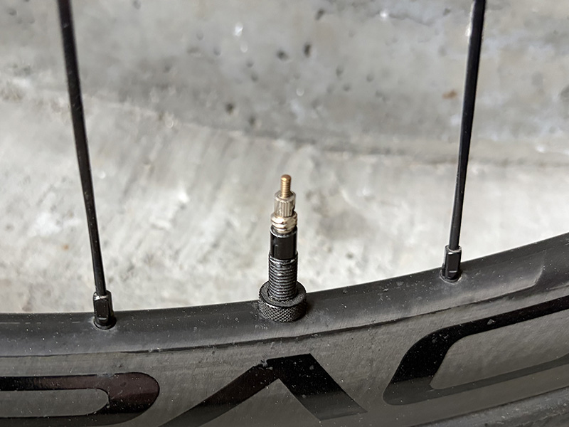

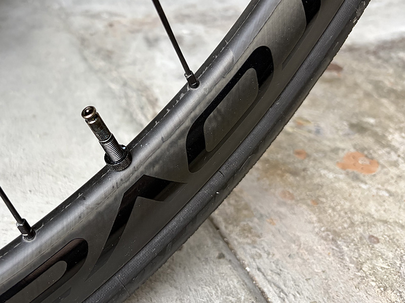

here's the alpinist clx ii rim of the aethos with the black clik valve core and whatever tubeless stem it came with. really clean, the clik threads all the way in, quite stealth! i will say that i much prefer using the barrel end of the valve core tool, which is so easy that you can do it in the dark, but with these you can't do that, you need to get at the flats from the side. a minor drawback and given the size of the park valve core tool, i probably won't use it any more. the clik valve cores come with a little tiny one.
for reference, same setup with the generic presta. i never put caps on stuff like this, and i will admit i've bent a few of these over perhaps 15,000 miles, and this brass on black look is certainly less aesthetic!

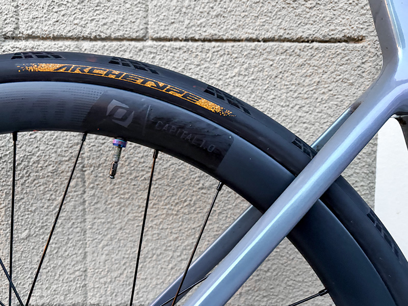

here it is on the scott. you can see here that it doesn't look quite as slick, the clik core does not go all the way in, and there would not be a reasonable way to thread it any further without just spinning around the tubeless stem. at some point i'll take out those oil slick stems (shop didn't have black ones in stock at the time) and it'll hopefully resolve the issue.

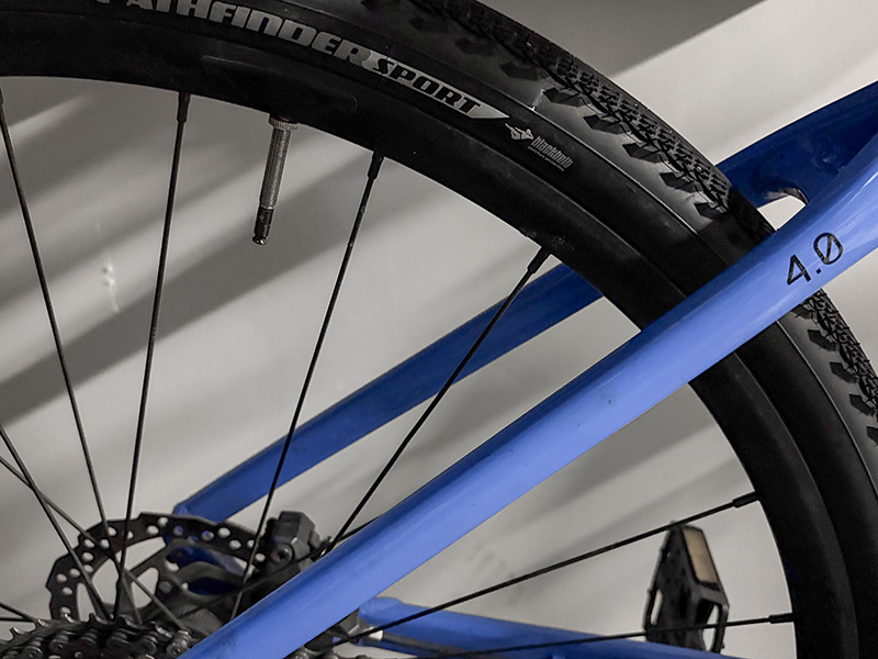

here's my daughter's sirrus. this is whatever cheap tube spesh ships these bikes with. no fuss here, and you can twist as hard as you feel like and no risk of breaking the seal of the stem. should get silver ones for this bike.

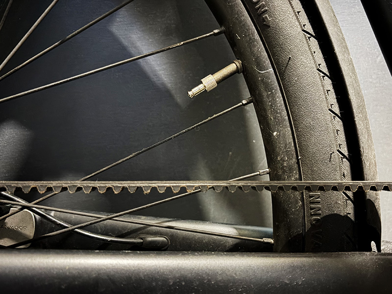

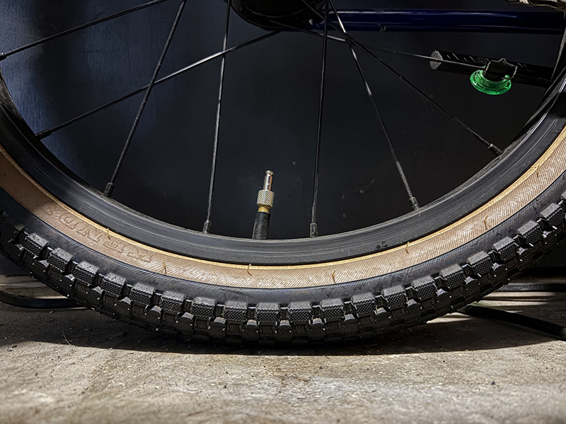

here's where things get a little less satisfying, the schrader valve tubes on the cleary. this is ugly, but the average 7 year old won't mind :) a tube with a shorter thread and a black adapter would look better.
looks better on my commuter, which is also using whatever tubes it came with thousands of miles ago. patched several times, of course.
the adapter for the inflator screwed right in, it sticks out a tiny bit (the grey space between the knurled black ring here and the body of the inflator) but not bad, pretty clean!

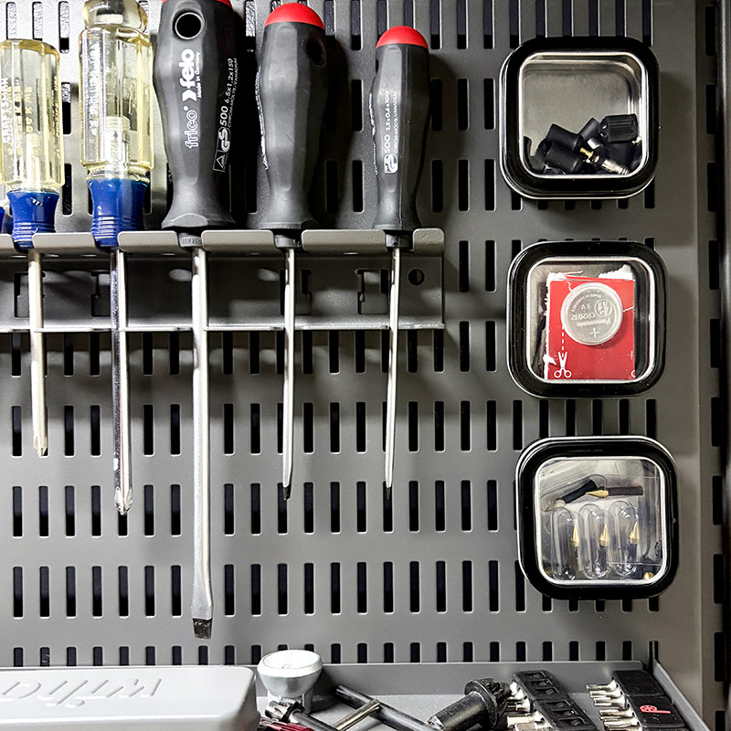

the top right little magnetic small part box on the work wall now has 10 never-to-be-used clik dust caps, a bunch of old but still good valve cores, a couple spare clik cores, the clik valve core tool, etc etc.
