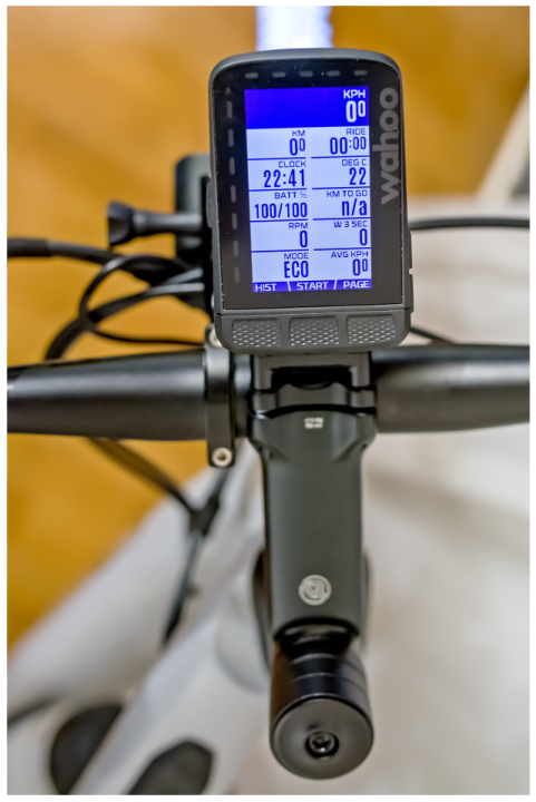

For how long did you say your iPhone could hold the battery charge? Screen on or off? (There actually were three reasons for me to go for a Wahoo: a. I typically needed to connect a powerbank to the phone in the middle of my long rides; b. Operating smartphone touchscreen was hardly possible when riding in winter gloves; c. The rain droplets falling onto the touchscreen were upsetting the phone operation).
I typically needed to connect a powerbank in the middle of my long rides; b. Operating smartphone touch screen was hardly possible when riding in winter gloves

Guys, another reason I don't want a smartphone on my bars. At freezing point temperatures or below, smartphone will charge dramatically slowly from a powerbank. Today's experience! While a Wahoo works as intended.
