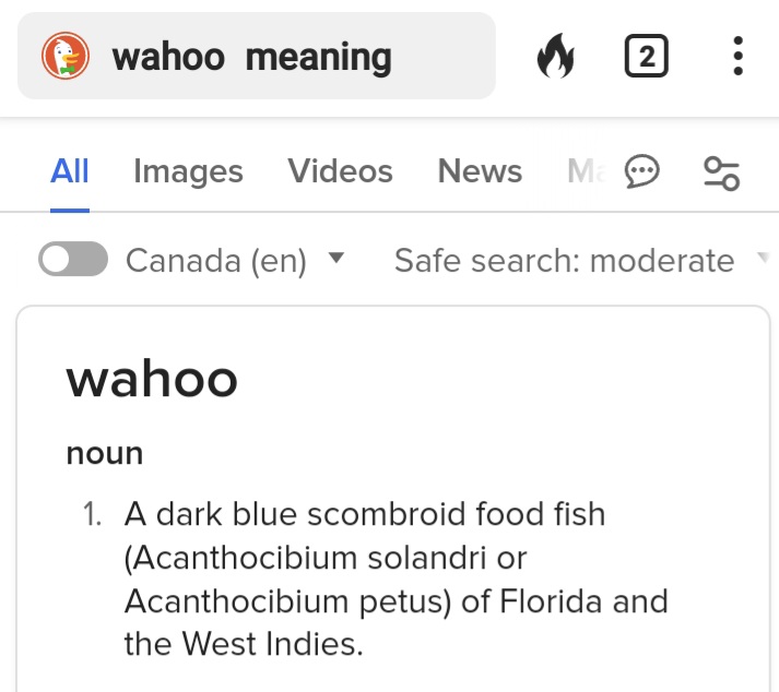

How does your pet fish receive notifications, and how does it tell your phone to ring ?? 😂
You've got a pretty smart fish !!!

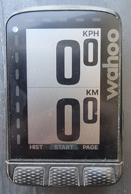

Of course. You could, for example, only have these two fields on the Wahoo screen if you wanted.
Wahoo with only two data fields visible (fully configurable from smartphone, you can put RPM and HR there)

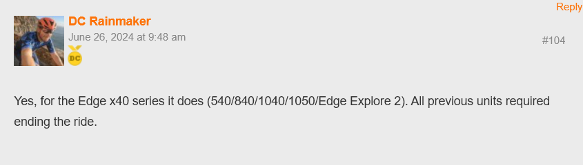

Allows loading any new route while the ride is still being recorded (not possible with Garmin; you have to end recording before loading a new route).
DC Rainmaker was as kind as to answer my question immediately. New Garmin Edge computers allow uploading a new route while continuing to record the ride
