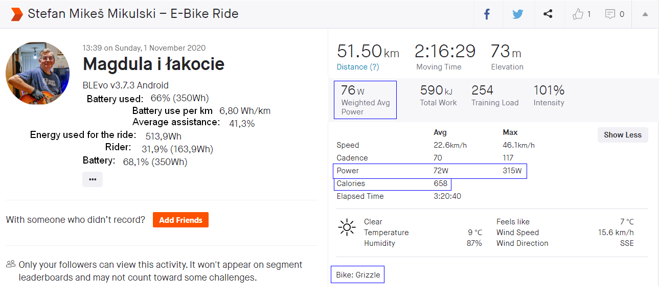

Some e-bikes precisely report the rider's effort and give the figure of kcal actually burnt by the cyclist... :) Should be easy because any mid-motor is torque based. Strangely enough, very few manufacturers make such data available to the user (Specialized, and the most advanced Bosch displays are capable to do it).
Specialized e-bikes with TCU controller (all since 2020) provide a lot of useful information. Here, BLEvo app could extract actual (not estimated!) ride data and feed them to Strava. Normally, you get actual measured kcal just on TCD e-bike display.
View attachment 71125Specialized e-bikes with TCU controller (all since 2020) provide a lot of useful information. Here, BLEvo app could extract actual (not estimated!) ride data and feed them to Strava. Normally, you get actual measured kcal just on TCD e-bike display.

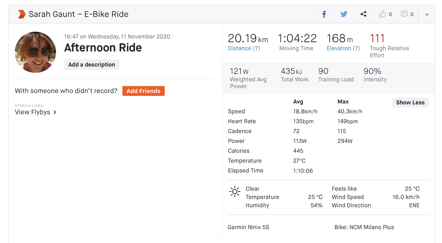

I finally moved my power pedals onto my eBike and have some of the same metrics. At least I have a baseline to start from now...

Ras, any Specialized Turbo e-bike equipped with TCU is both Mission Control and BLEvo compatible (but one app at a time). Specifically, Vado SL can use BLEvo (several Vado SL owners present in this Forum are delighted with the capability).
The chainring size doesn't affect the measurement at all! Let me explain why: In a mid-drive motor scheme, you don't drive the chainring directly with the cranks. Differently to a traditional e-bike, you are pedalling through the motor, and it is the internal gearing of the motor that actually drives the chainring. Therefore, the torque sensor measures your input at the cranks, not at the chainring.
Do a little experiment: Rotate the cranks backwards -- the chainring won't move.

That's called "pedal power meters". These are used by competing cyclists to measure their effort and are very expensive. While, any mid-drive motor does such measurement to determine the torque resulting from the rider's input...

You can also get power with power meter pedals! (My Vectors were on my spin bike until yesterday when I moved them onto my eBike). And actually the Keiser spin bike I have also reports all those metrics (including power). The pedals were from an old spin bike that didn't have that ability and I moved them to the Keiser as then I also had the data to send to Garmin Connect.
