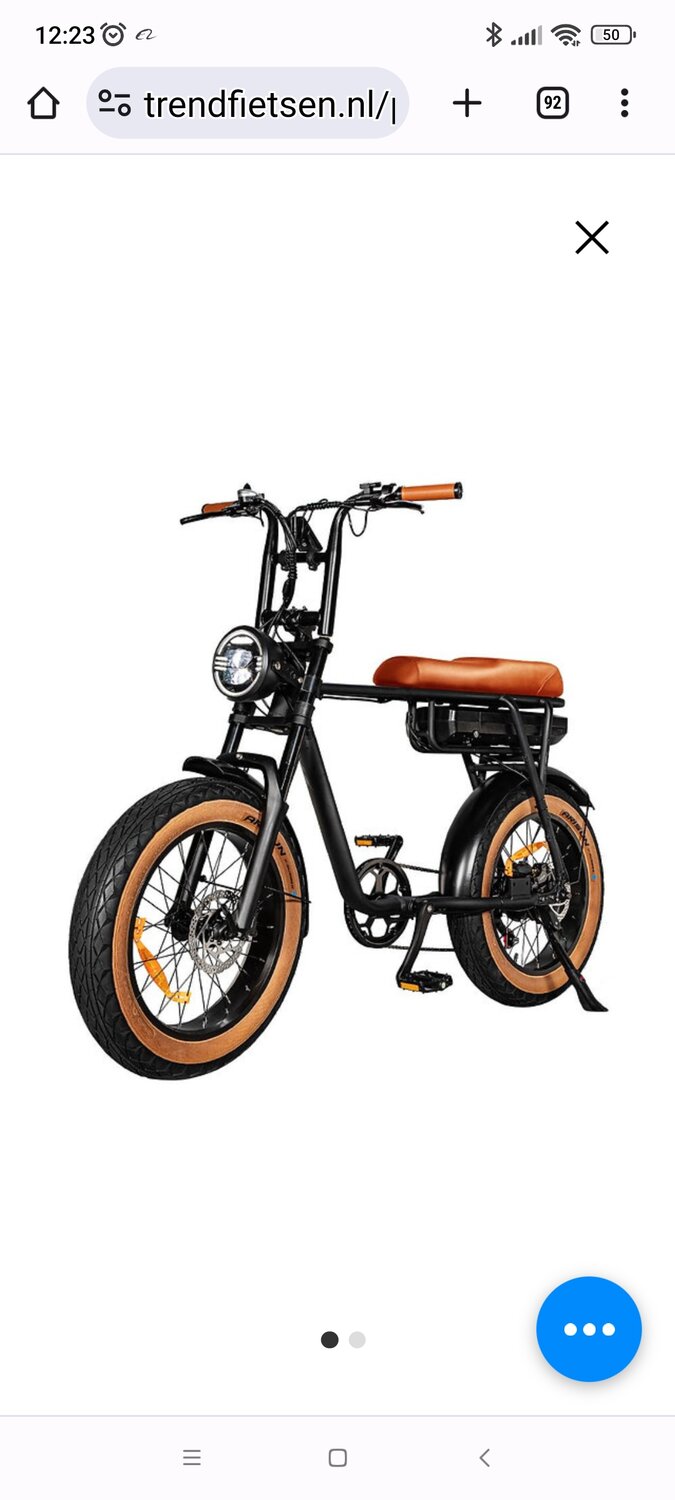

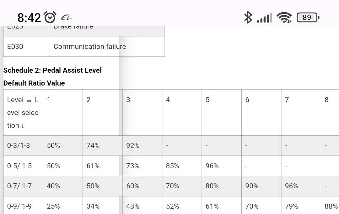

Hello everyone please could anyone help me figure out how to upgrade my EB 5 fat bike 250watt 48v 17ah 20x4 electric bike.i trying to find a different controler with display that will give me options in the settings to adjust the pedal assist percentage,at this moment I have yolin YL81F-V display but of course the controler will not give this option.the picture under is of the bike and the screen shot is what I'm looking for in a controller and display.

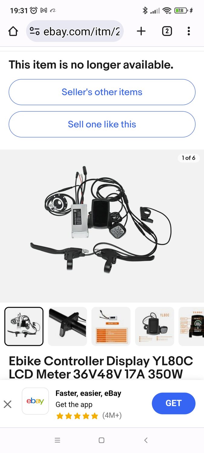

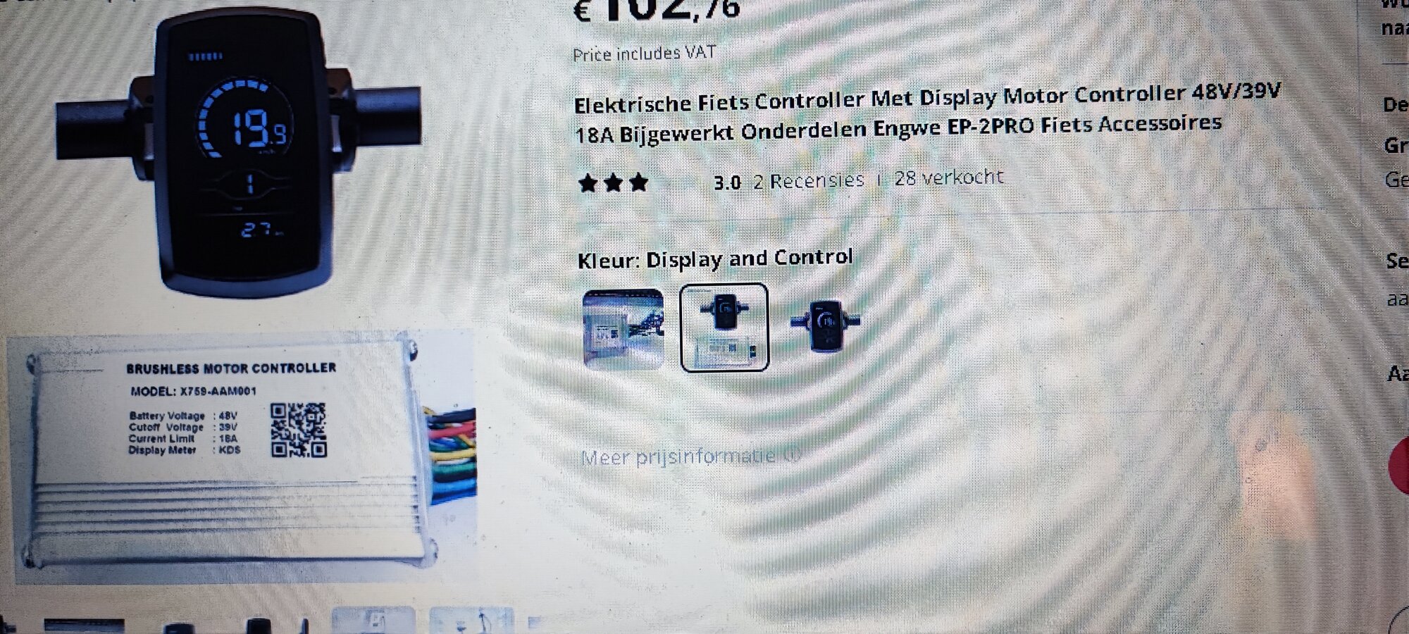

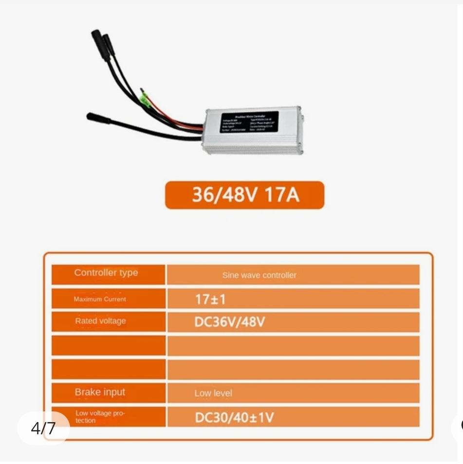

Will this work with fat bike

You're saying your display is the YL81F-Vm which has 3, 5, 7, 9 PAS levels with the ability to adjust individual levels, and then you say you can't do that? Surely, with 9 levels, your should be able to get one that is comfortable even if you can't adjust them,
Harry in each level of 1-5 I'm looking for a controller to adjust each one , example 1 =35% 2=40% 3=60% 4=80% and 5=100% that's why I'm asking would the controller and display fit my 250w 48v 17.5ah fat bike.yes I can change the pedal assist but not the percentage.

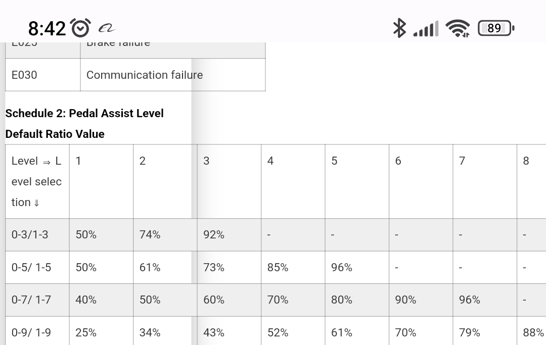

this is what I'm after a controler and display that will do this.
