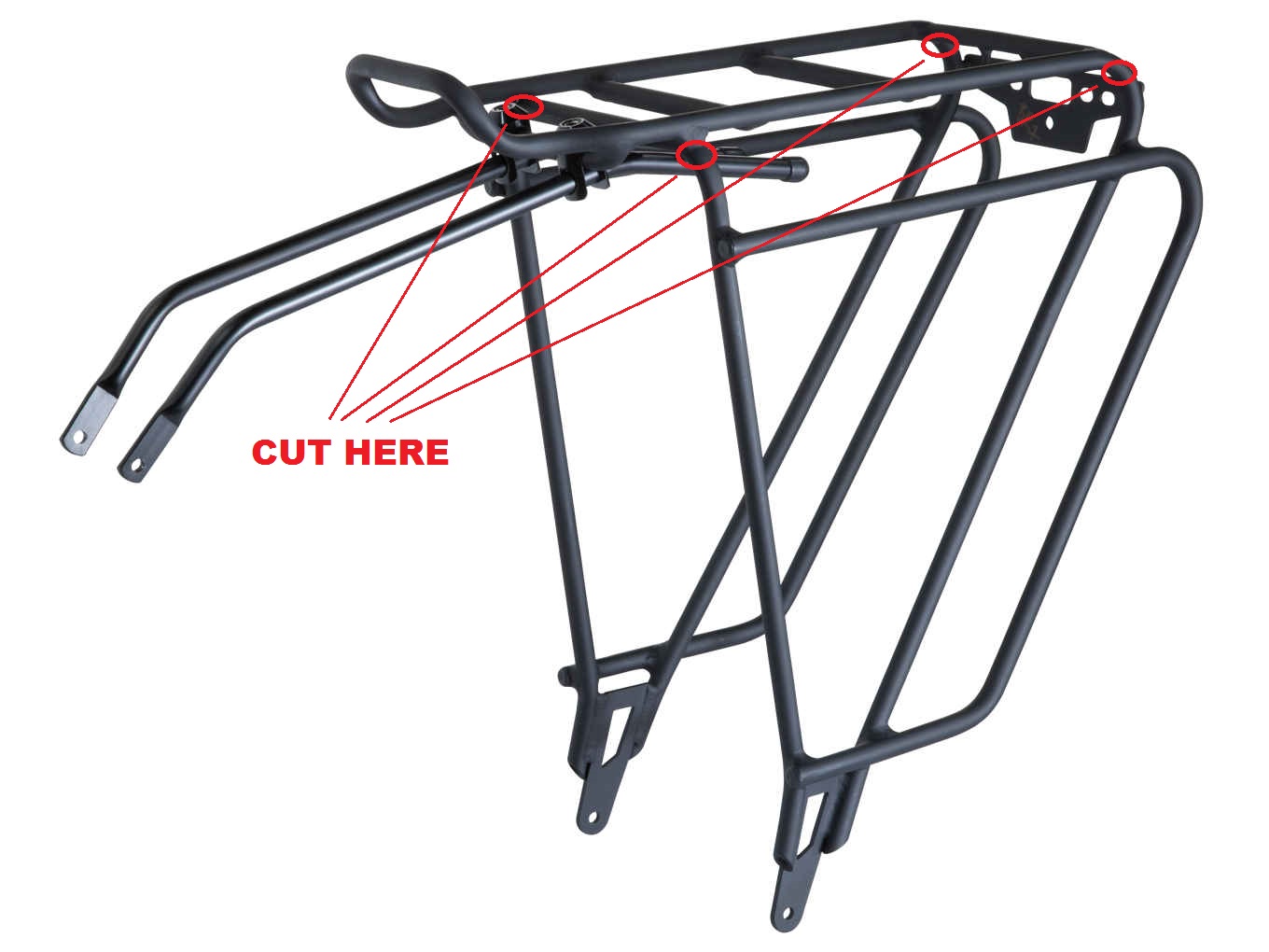

I bought a Bontrager / Electra rear rack assembly but almost any brand or style will work.
I cut the top off with a hacksaw as shown.

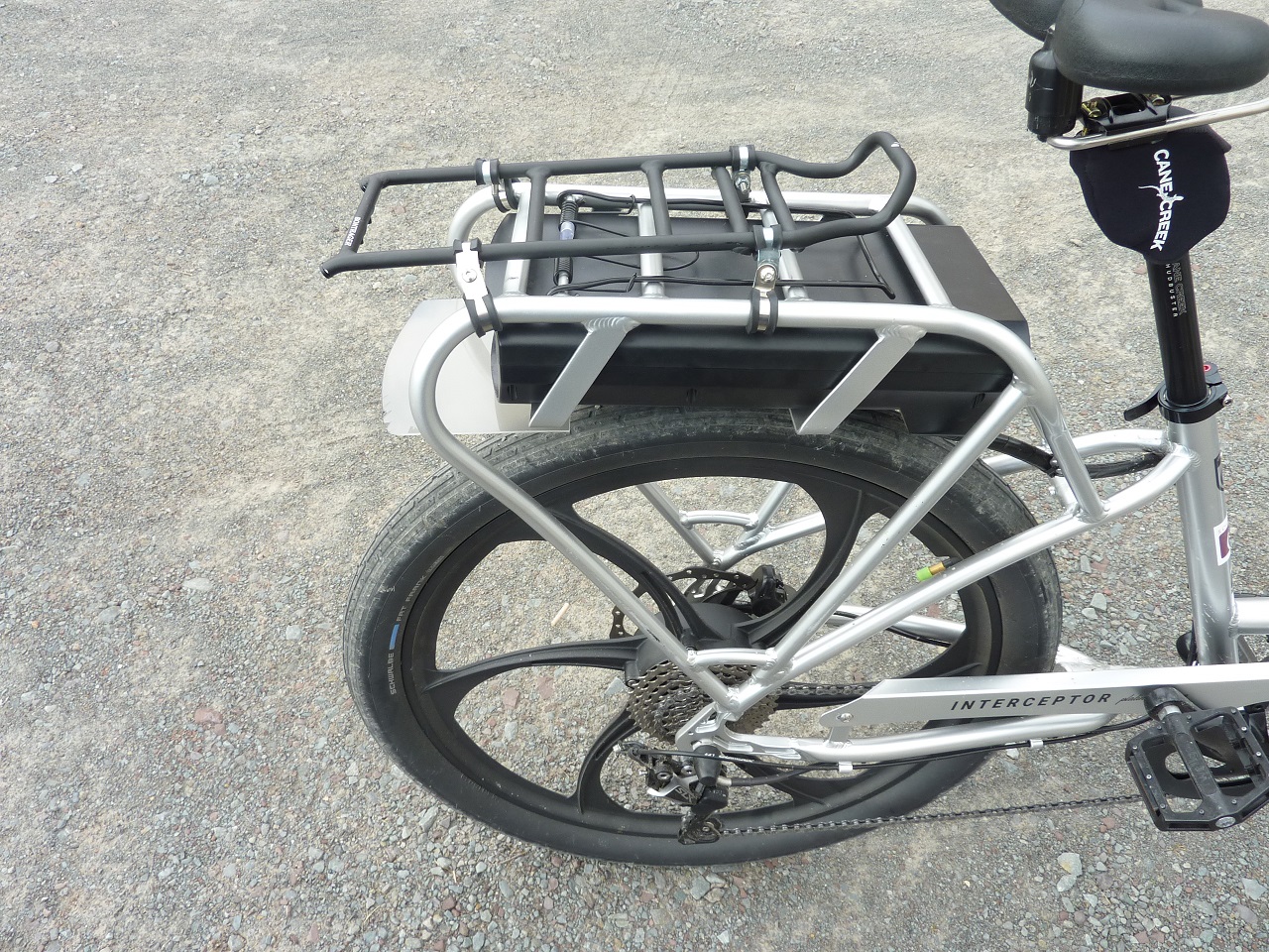

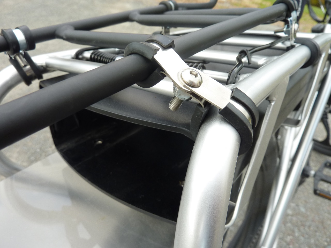

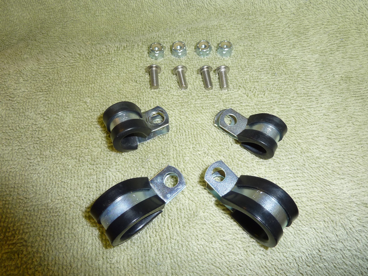

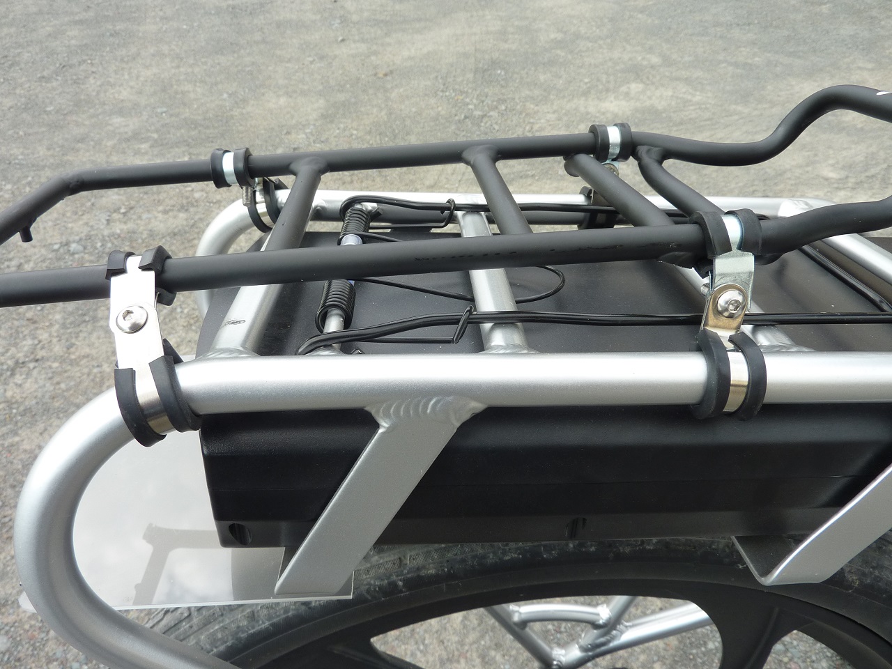

Then, using four 5/8" and four 3/8" rubber insulated cable clamps, I attached the rack top piece to the Pedego rack as shown.

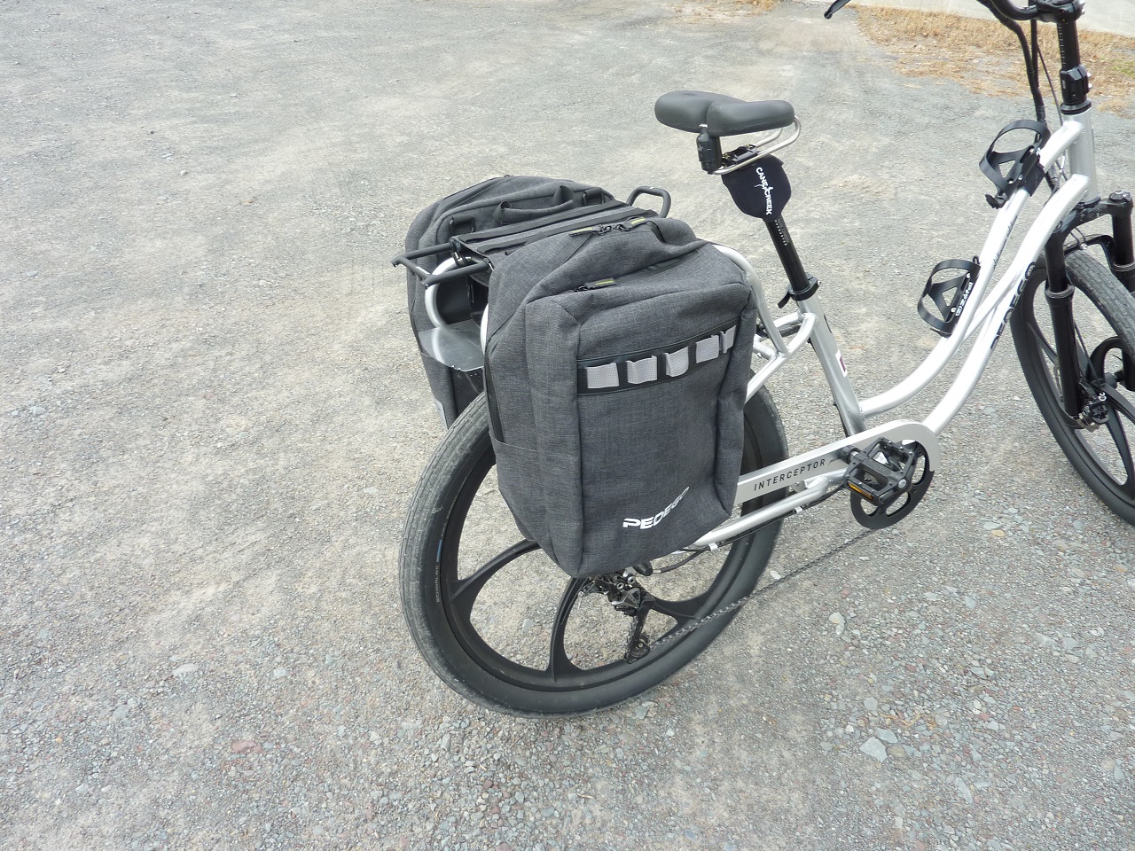

The modified rack still allows use of the Pedego pannier bags.
It also allows the use of various Bontrager / Electra interchange bags in combination with the Pedego Panniers.
