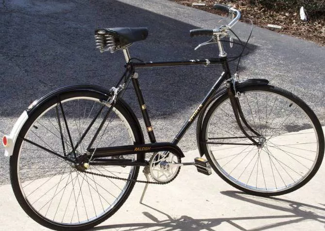

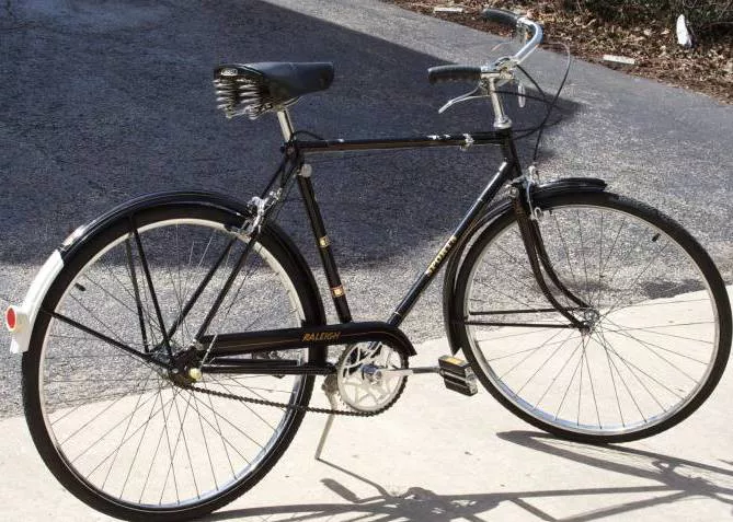

Sorry all I posted this and I have been busy working on the exterior painting! Yes that's a good looking Raleigh. I have attached a picture of the one I was thinking of adding some kind of a front electric Hub as the sterny shifter is three speed and works very well.
So I was looking for a hub type front wheel with a throttle and a midsize battery.

I wouldn't be confident with a front hub motor on skinny forks with what looks like forward facing dropouts in this Raleigh 3 speed.
It has a three piece bottom bracket which should fit a TSDZ2, I put one on a '70s Sears with similar cranks. Chainguard would have to be removed or mount modified but the TSDZ2 has a chainring guard anyway.
My bike is exactly the same as the one posted here. When you say TSD Z2 what are you referring to? Is that a mid-drive motor? And if that mounts I think somebody mentioned that a powerful motor like that would probably blow out that sterny rear hub
Tongsheng TSDZ2 is a reasonably powerful torque sensing mid drive. Probably similar performance as the TREK 50nm that I think I read that you have. Similar to my Yamaha 70nm mid drive anyway. Depends on which power version you get. Not sure about the Sturmey Archer 3 speed but the Nexus 3 speed is supposed to be a good hub for mid drive conversion. I'd expect them to be similar but maybe not. It'd be a shame to alter your nice Raleigh bike so keeping it stock might be a good choice if you have uses for it.
