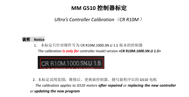

I should also say as I didn't really make it clear earlier but ANYTIME you change the rotor gear you risk the chance of having to recalibrate... Because its not easy to tell which way the magnet is pointing on the shaft and it'll mess up the hall sensor position!
You might get lucky, but chances are you'll find it running rough! To fix you need a buy a special C961 "Calibration" display, and compatible controller - and chances are your existing controller won't be compatible - so you'll be replacing that too.
So try avoid this issue... ;)

Yep its annoying but you need a controller with the model number CR R10M.1000.SN.U 1.5 or it won't work. It'll just keep throwing an error when you try.
My bike came with a later version so I had to purchase another from GreenBikeKit.
