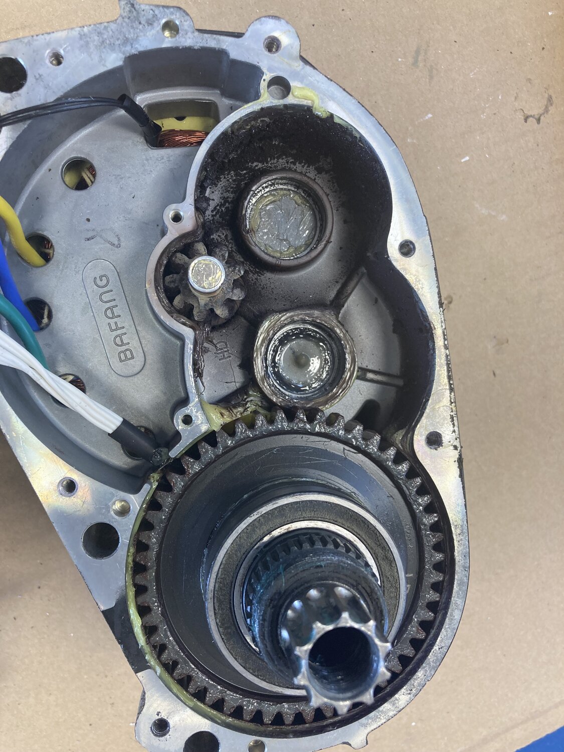

I took my ultra apart when it had less than 1500 miles on it because I thought the motor was getting noisy.
To my surprise I found very little grease surrounding the gears and there was a noticeable amount of gear tooth wear.
I ordered three new gears from GBK, but didn't order the motor rotor, with the small gear, because mine, at first glance, didn't look worn and mine also has the X1 controller, which is a whole other problem.
Taking a closer look I realized that the motor rotor gear was also worn.
I ended up not replacing the gears, thinking that the old, worn motor rotor gear would, over time, damage the new gears. Instead, I adding corn head grease and put the motor back together.
I had the exact same experience as @Deacon Blues , premature wear on the rotor gear due to a lack of factory grease.
But I did change all the gears, and done a "quiet gears" upgrade at the same time.
(I don't really advise others do the "quiet gears" upgrade, its a PITA, requires a new controller and calibrating... this will add a few hundred dollars to your bill. And it doesn't make it THAT much quieter by itself. It still needs grease!)
But yes, even steel gears can wear down in just hundreds of miles without grease.
It may sound silly on a new motor, but for piece of mind open it up and check how much grease is there, and add a generous amount for good measure. Use SHC100 or Cornhead Grease.
It would be worth purchasing the gaskets from GreenBikeKit before you do this in case you break them during the regreasing.
The only thing I'd add is buy an extra gasket, because sh*t happens. ;)
I should also say as I didn't really make it clear earlier but ANYTIME you change the rotor gear you risk the chance of having to recalibrate... Because its not easy to tell which way the magnet is pointing on the shaft and it'll mess up the hall sensor position!
You might get lucky, but chances are you'll find it running rough! To fix you need a buy a special C961 "Calibration" display, and compatible controller - and chances are your existing controller won't be compatible - so you'll be replacing that too.
So try avoid this issue... ;)

Yep its annoying but you need a controller with the model number CR R10M.1000.SN.U 1.5 or it won't work. It'll just keep throwing an error when you try.
My bike came with a later version so I had to purchase another from GreenBikeKit.
