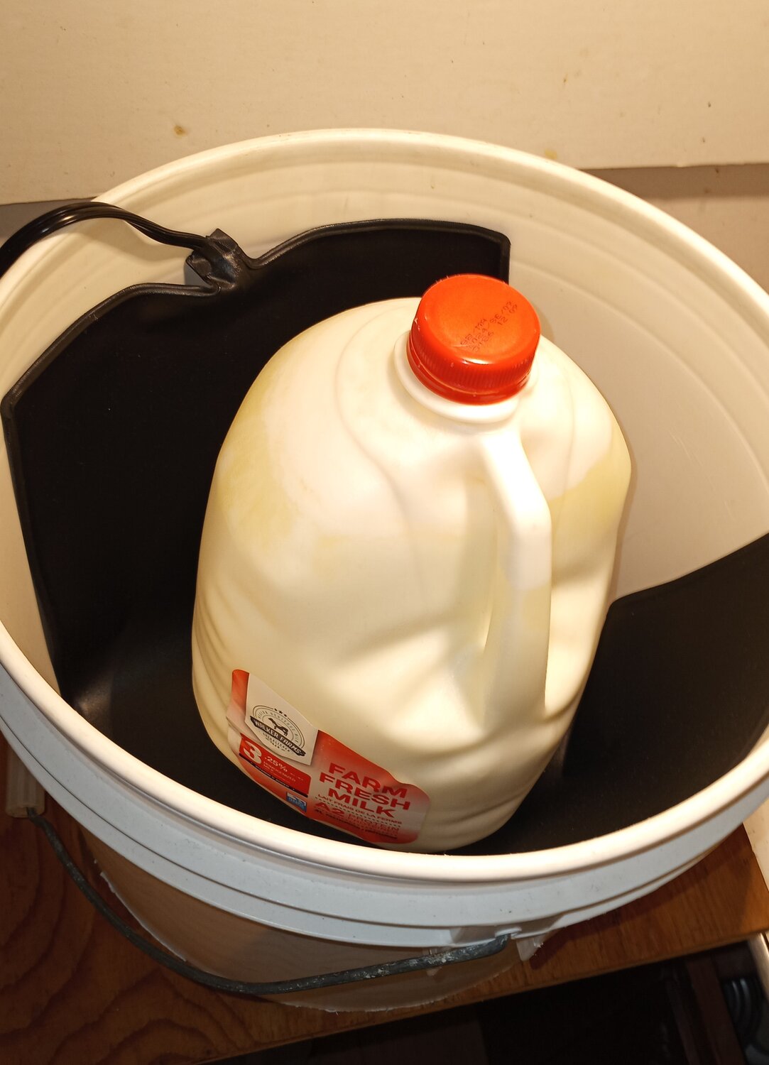

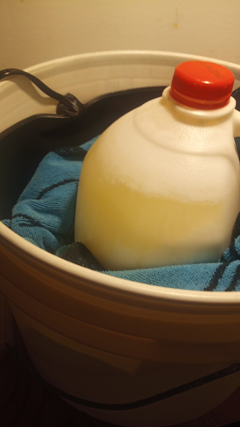

Coincidencidentally, I just bought a waterproof heating pad to make yogurt,..
It would work great as a battery warmer.
It came with a thermostat that the heating pad plugs into, but I didn't use it.
It's a 20 Watt heater pad that I have plugged directly into the outlet.
It can only overheat if I have the pad completely insulated where the heat can't escape.
I just adjust the towel around the pad and milk to keep the milk around 100° F
Waterproof heating pads are available in different sizes and Wattages.
I prefer to run the pad without the thermostat/timer because they have been known to fail.
