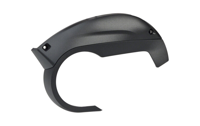

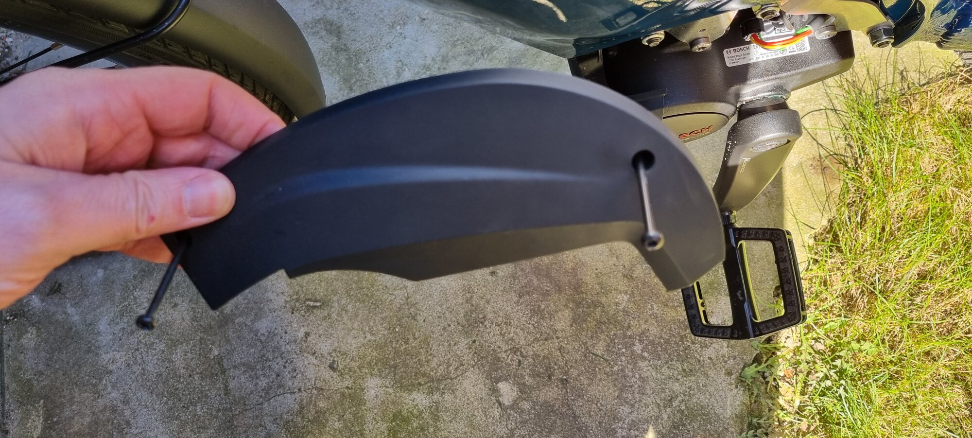

When I google the design cover it looks very different from the Gazelle engine cover. I have attached my engine cover and a photo of the bosch design cover
The bulge is quite substantial, I’d estimate 1+ inch where the module mounts. I have confirmed with both Bosch and Gazelle that a new cover is required. Bosch gave me the part number EB11.200.03X and Gazelle confirmed this part number will fit. It does look quite different and the one you posted is, I believe, the correct part. Also note that it must fit the left side as there are two other parts with very similar part numbers for the right side. However, I was not able to find a supplier online that had stock available but Gazelle assured me that one of their dealers would be able to source the part. Will find out once I call my local Gazelle dealer.
