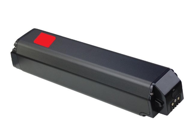

- Installation of a (35mm X 35mm X 5mm) foam pad on the upper part of the battery solved below problem along with prying the battery connectors closer together to make contact with the cradle pins.

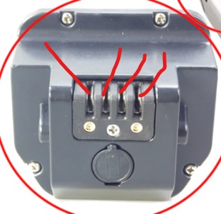

1. I removed the battery, and using a tiny screwdriver I pried the female slots closer together so they would envelop the 4 rectangular pins in the base of the battery cradle. They seemed at first to be spread far apart to maximum distance. They look more tight now like the image below.

3. I added a piece of foam on the upper part of the battery where it meets the upper inside frame wall. Previously , there was some tiny amount of play in the battery once it was locked in place. There is no more play, it seems pretty tight.

I've taken the bike out for about 3 hours and it did not shut off after going over bumps and pulling G's that would normally cause it to shut off. Seems like the problem was solved. After speaking with the Luna Cycle Tech, it was most likely the foam pad that solved the problem.

Update 1,700 miles. The installation of a (35mm X 35mm X 5mm) Dense foam pad (red square) did solve the problem. No cutoff problems since.
Had the same cut off problem today that I did back in November 22'. Power shut down over rough terrain. The solution was the same as in post from November 16. I used a small screwdriver to pry the receiver connectors inward to make better contact with the battery cradle pins.
Worked like a charm.
