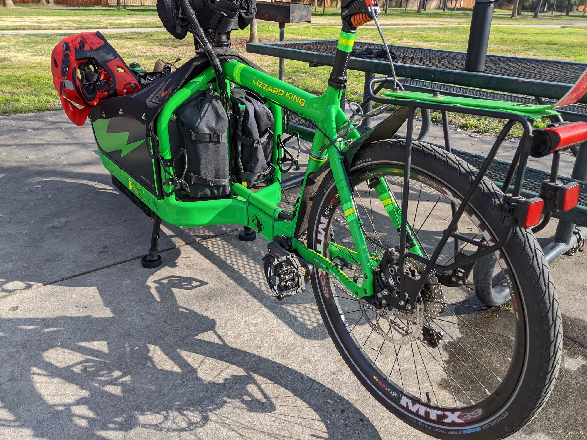

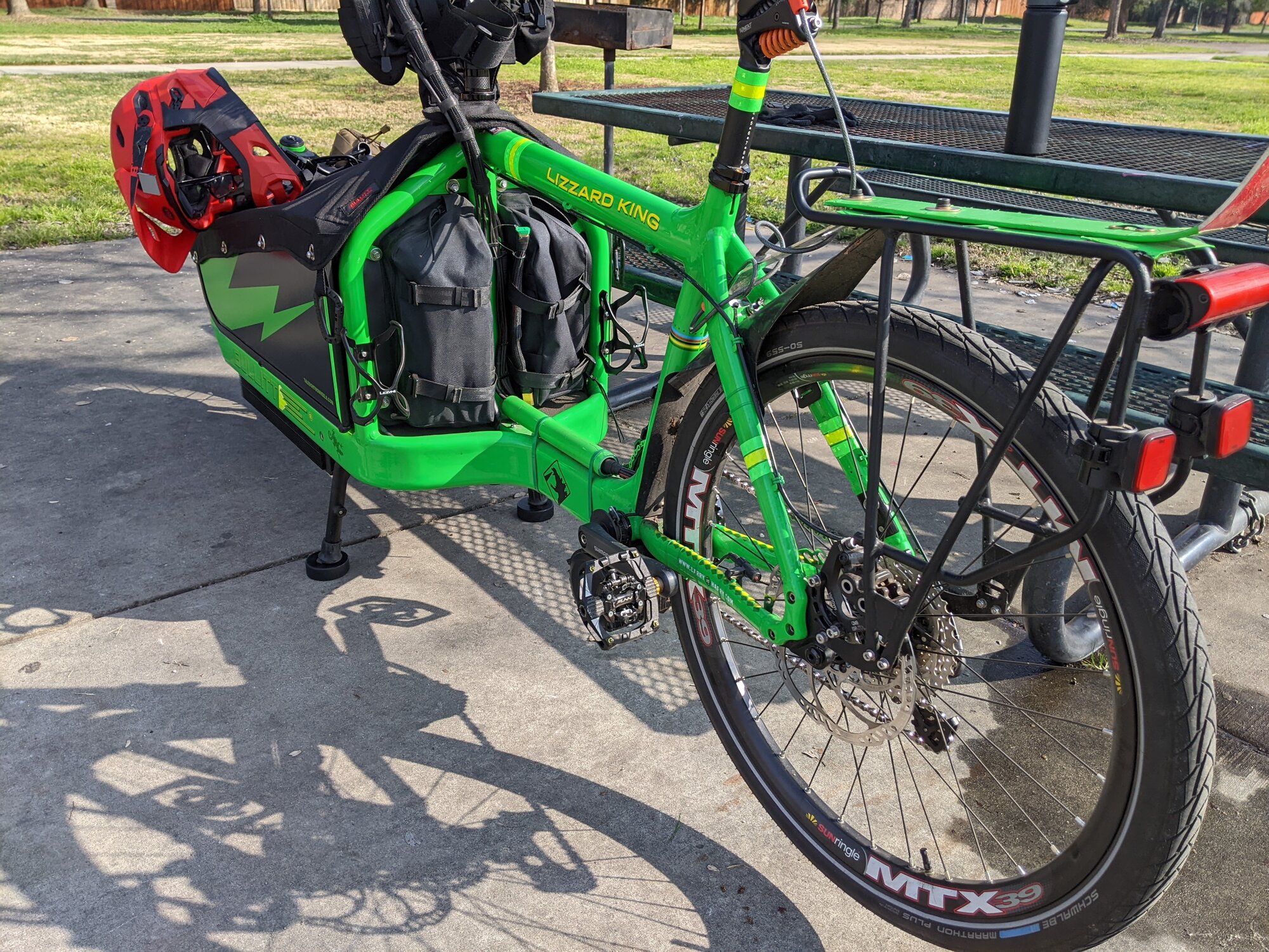

I like to do my chain lubrication out at a city park as its such a simple job and I'd rather do it outdoors than penned up in a hot garage. I am not the guy who uses 'lasers' to zap the chain clean ,and then sends it to the Vatican to get blessed by the Pope. I use an old towel and squirt Rock and Roll onto the chain links with that towel under the squirtees. Then I wipe. Then I move to the next segment of chain. 10 relaxed minutes later I am done. The chain is lubed and silent for a couple more weeks of daily riding.
Despite this shockingly care-free methodology, my chains last for roughly 3000 miles. So I could wash the thing in holy water and sing it a lullaby... and get ... 3200 miles? Screw that. Its just a chain.
