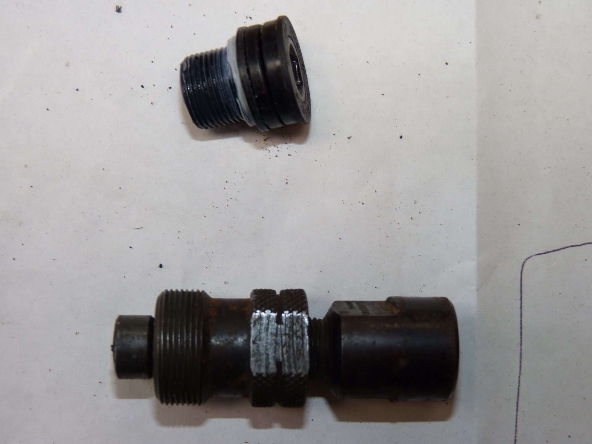

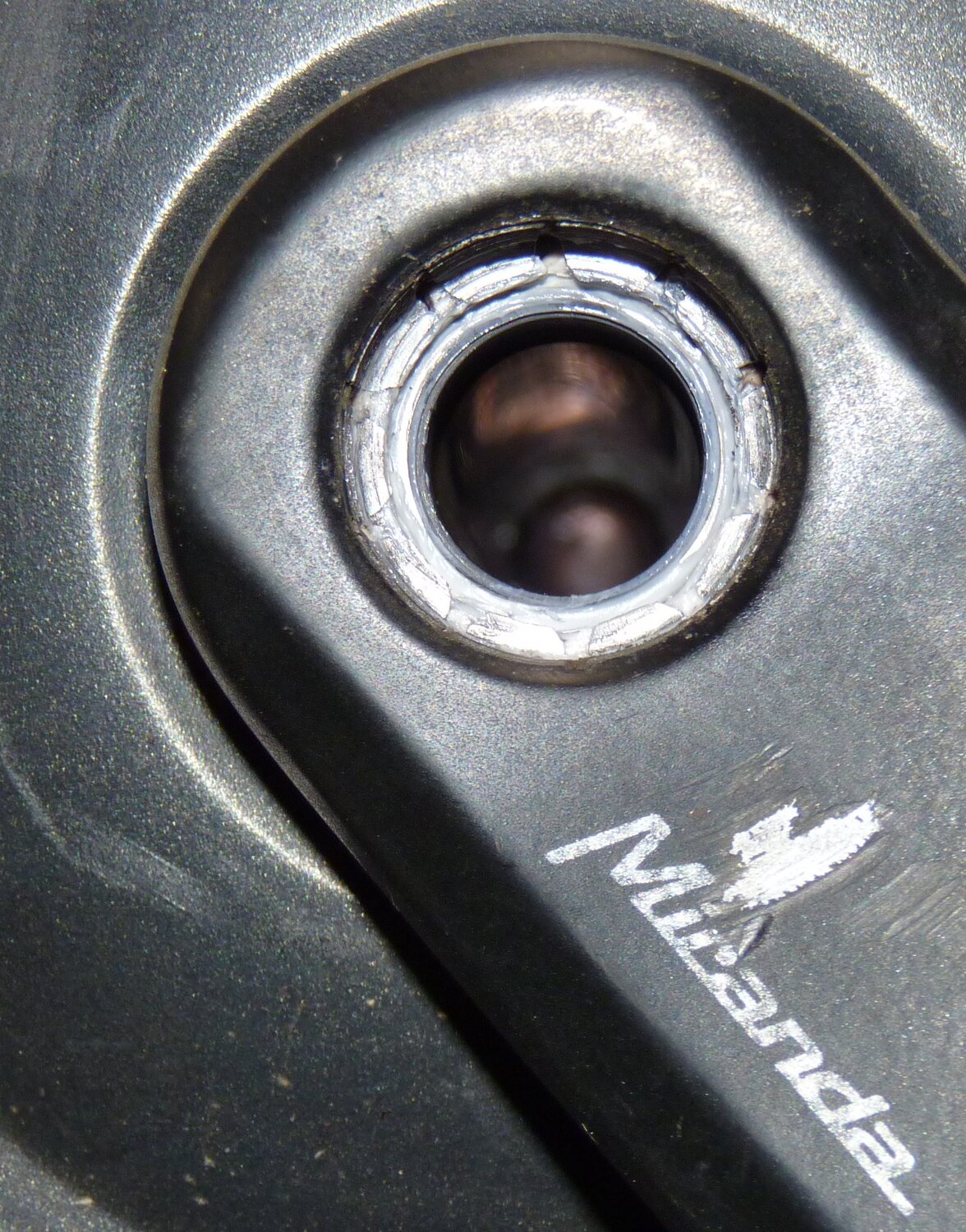

My collection of bike tools is 20-30 years old and so far I have been unable to get the Miranda crank arm off. It has an 8 mm hex bolt which was easy enough but my crank extractor does not work. I am lookin for advice as the which Park crank arm removal tool and a bosch lock ring removal tool, is suitable?
Also my eyesight is not as good as it was 50 years ago and can you please look at pic of crank arm and advise if it is ready for new crank arm removal tool to be used or is there a washer in there that I need to remove?
