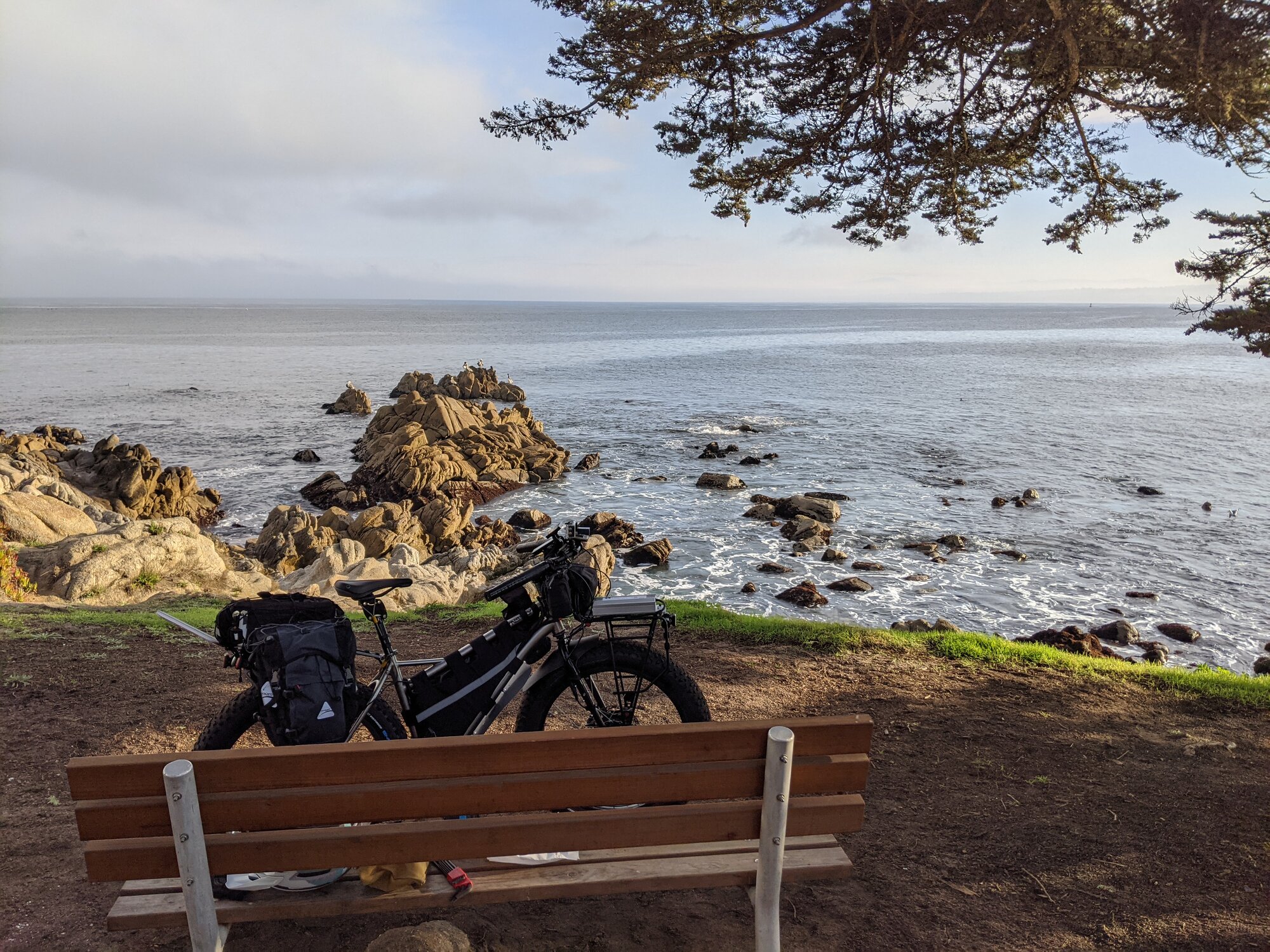

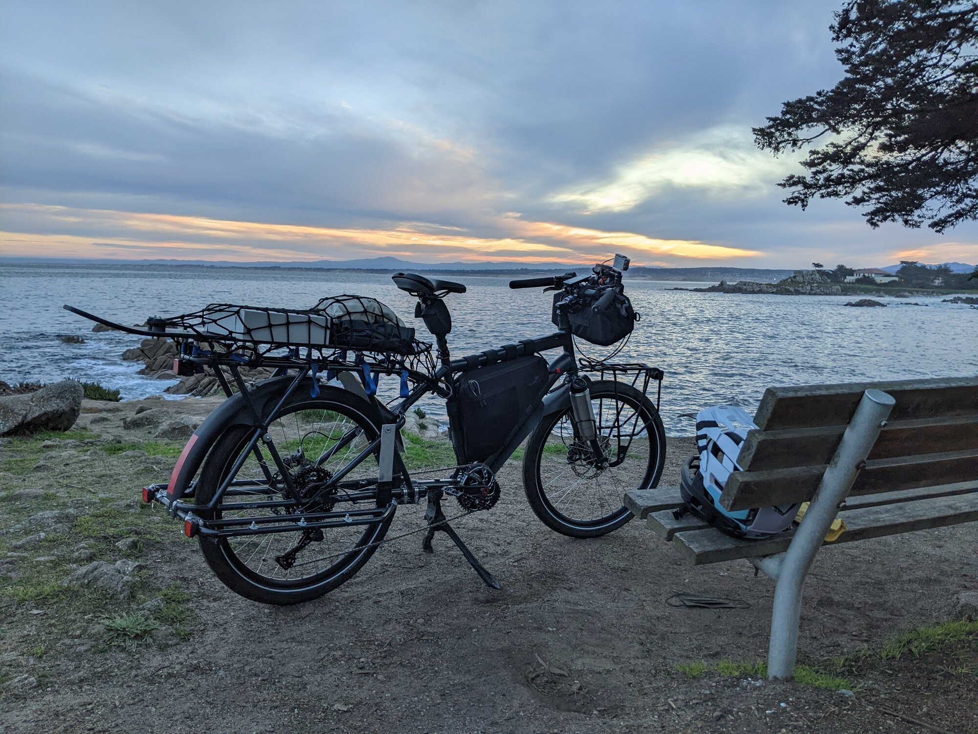

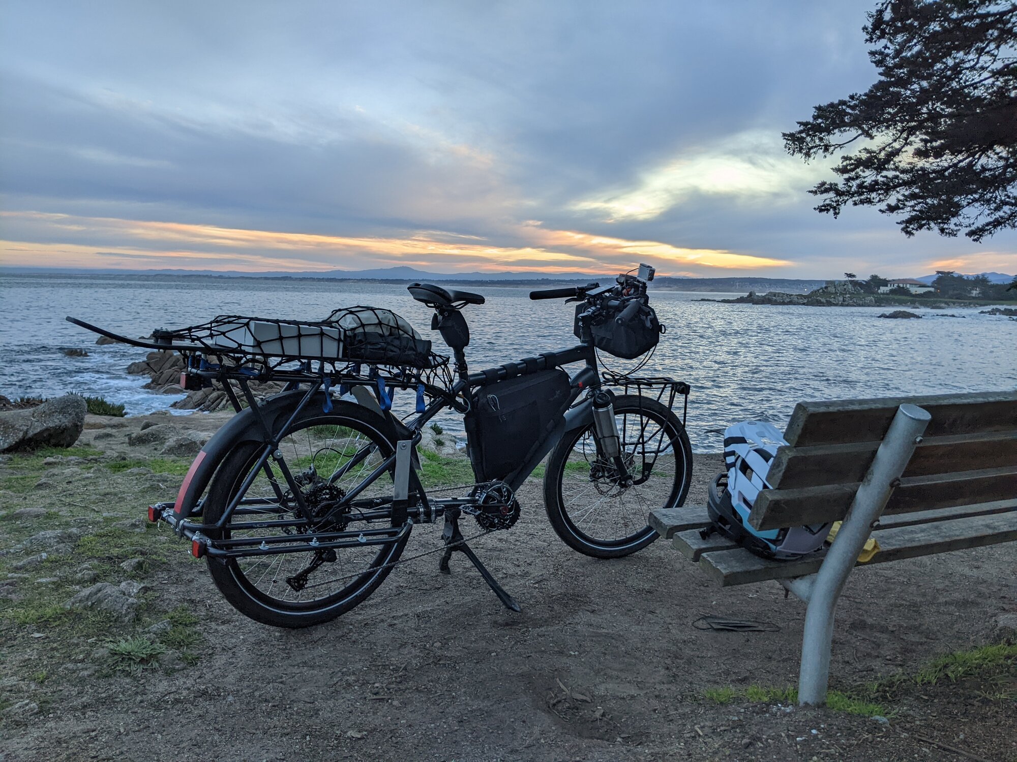

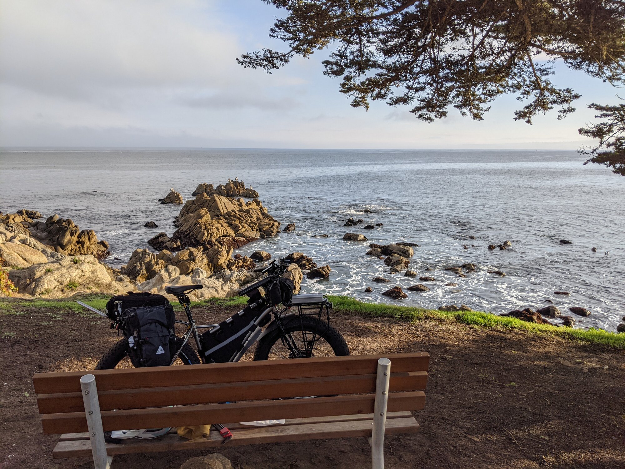

I sit on a park bench and don't always have that great big cargo bike with the dual leg kickstand. But I still do my chain maintenance - with zero tools to move the chain. I am still using the simple Rock and Roll+towel method described earlier.
- Sit on the park bench, facing the bike which is pulled up right next to said bench, lengthwise. the drivetrain is facing me and the kickstand is on the side of the bike opposite me.
