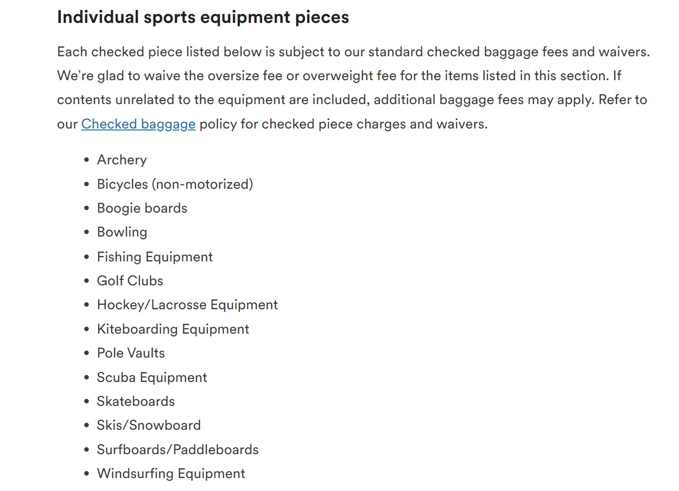

Hope this is helpful. I have also attached a screen shot from Alaska Air showing that most sports equipment (including bikes) have the oversized and overweight fees waived.
