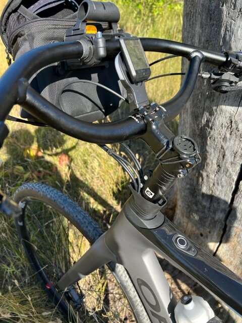

I just had that problem and it was solved by the mechanics Curtis and Sean at Cycle Logic in Kamloops. Here is what they came up with. I said I needed two inches back and three up as the Orbea, even with Jones Bars was just too low for my neck. So, I camn be done. Not as pretty but I did not buy to hang on the wall! Let me know if you want more information.
Can I ask what stem you used? I am having the same issue. I can go shorter, ie from 100 to 80 but would like a riser as well.
'I used a Ritchey 4-way adjustable stem. It comes in three different lengths and I used the shortest one which was 90mm. It also came in 105 and 120mm I believe. The 90 mm was all I needed but any would fit. With the 90mm I didn't need to change the hydraulic brake lines.
Sorry for the delay in responding. I have not been on the forum in some time. I hope this information can help you.
