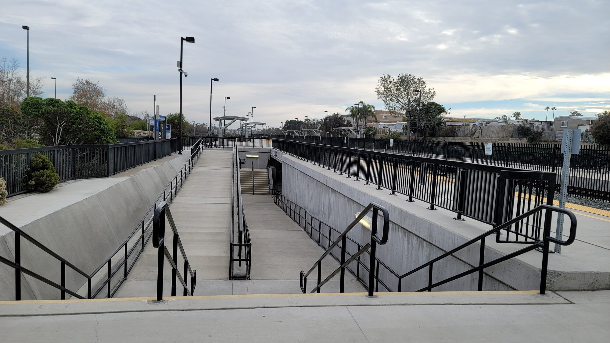

Still getting my low-speed balance back after 25 foolish years of little cycling. The local commuter train station is a good place to get across — or more precisely, under — the tracks on certain rides. But the ramps down and up include 180° turns that I have yet to master.
