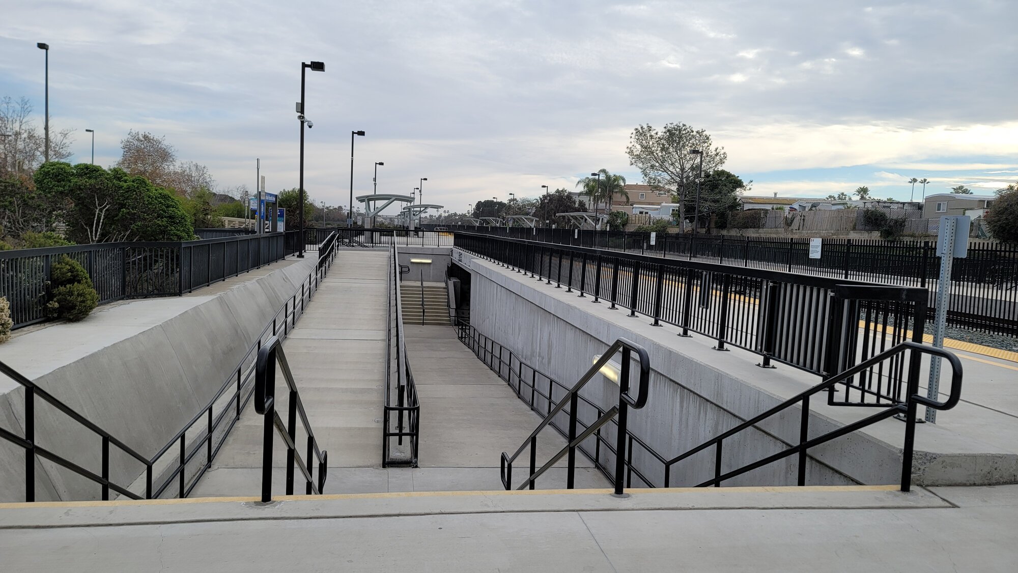

Still getting my low-speed balance back after 25 foolish years of little cycling. The local commuter train station is a good place to get across — or more precisely, under — the tracks on certain rides. But the ramps down and up include 180° turns that I have yet to master.
As suggested above, it's useful to lightly drag the rear brake and counter weight or counter lean while making a tight turn. Weight the outside pedal and the inside grip. And always look where you want to go. Practice, practice, practice.
