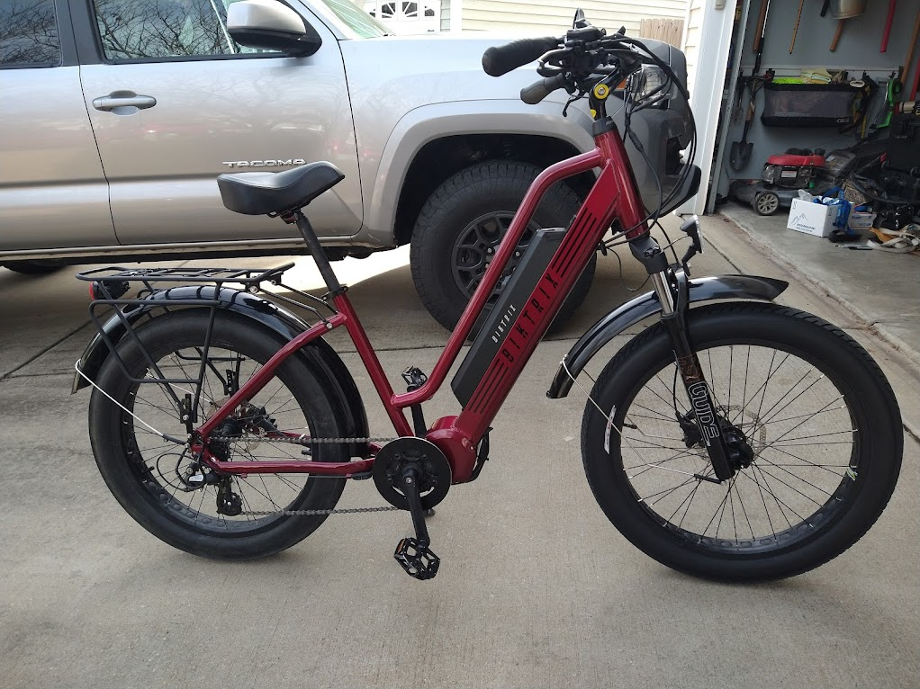

I bought a used Stunner X today, it's in excellent condition and was ridden very little. It is the 24x3 tire model, with hydraulic brakes and the base 17.5ah battery. I also own a Rad Rover Step Through, here are some random thoughts. Obligatory picture first:
  • I adjusted the front fender so it looks better. :)
  • Initial riding impressions:
    • I can see doing long rides on it. It's very comfortable, the power is quite nice and the way I ride, the range should be excellent (generally lowest PAS and no throttle, except to cross streets).
    • Love the hydraulic brakes! They feel great, work very well, and are silent.
    • The frame appears quite stout, I could not detect any flex.
    • The freewheel is loud. Wow.
    • The assist is very jerky, not smooth at all. Already having a cadence sensor ebike, this one will pitch you forward (when you stop pedaling) and back (when you start) and is just not refined or smooth.
    • The tires are quite hard. I dropped pressure from the max 40psi to 37 then 34, still trying to find the sweet spot. Combined with no suspension seatpost or seat itself, it's rough on bumpy terrain.
  • Some curiosities:
    • The stock front headlight seems like a total afterthought/hack job with the spliced cables. The previous owner said she couldn't get it working, and that was because the spade connectors had come loose from the light.
    • Disappointed the rear light is stand-alone, and no brake light.
    • No frame protection - the downtube or the lower rails to the rear wheel. Already has several scuffs and scratches.
    • No reflective anything on it. Yes I will address, but do Canadians not ride at night? ;)
    • Gearing is terrible. I'll hopefully upgrade the front chainring; as it is now, I use gears 4-7. Or would it be better to upgrade the cassette?
    • No predrilled bosses/holes for water bottle holders (or any other acesssories) - really?
    • What's with the mix of hex head and philips head hardware?
    • Really wish the front fender extended down lower. As it is, the front tire throws water and small debris right at the frame and the grommets. I'll fix this.
  • All of the paint and glop in the handlebar clasp == handlebars pivoted up/down on their own. Some sandpaper and a good cleaning solved that problem.
  • The machining of every hole from which I've removed bolts or screws appeared to be done by someone who was in their first day on the job (or a new robot that hadn't been tuned). I had to chase every hole, and expect to chase every subsequent hole. There is also plenty of aluminum bits and shards from each hole.
  • Quick releases for both wheels and the seatpost will require replacement to afford any security w/o having to carry 3 locks.
I think this bike will work out fine, I expect my wife to ride it quite a bit and I'll do some longer weekend rides on it. I really enjoy tinkering, maintaining, and modifying things, so in the end I suspect it'll be great for us. That said, I am very happy I got it for less than half of retail; had I paid full retail, I would have sent it back, it's just too unrefined for the price.
