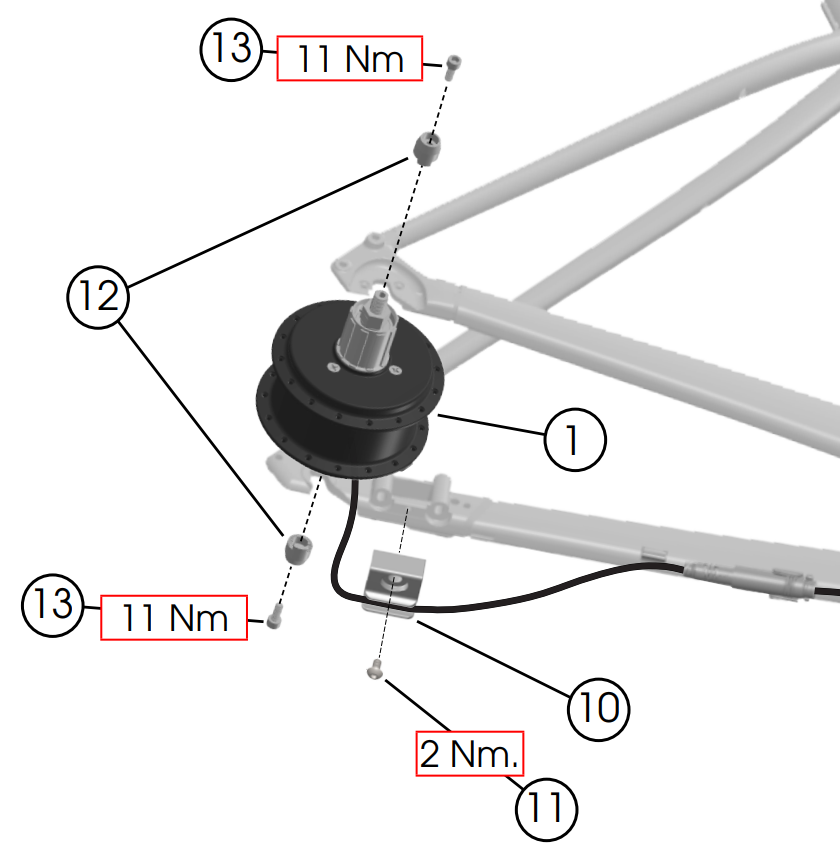

Removing the rear wheel is certainly a little more complicated than usual, but not too bad once you know what to do. The rear hub has hex head bolts either side, with bushes to match the frame dropouts which prevent the axle from rotating under motor torque. These bolts require a long 5 mm hex key to get sufficient leverage. Prior to wheel removal, a plug and socket must be disconnected just in front of the hub motor and a bolt removed which clamps the motor cable to the frame. There was also a cable tie on the motor side of the plug and socket, which I had to cut off. I didn't replace the cable tie as the cable was fixed well enough to not get caught in any moving parts.
When re-installing the rear wheel, make sure the plug and socket are fully engaged. It took me a couple of goes to get it right.
The front hub is described as QR and appears to be a standard QR type but, instead of a QR skewer, it has long bolt with a 5 mm hex socket to fit the thru hole forks, which are non-standard.
It would pay to practice removing the wheels before riding far from home base.
The diagram below of the rear hub is from the Trek Maintenance Manual - See https://retailerassetsprd.blob.core...=UogJIteiFltPX66np2M0a3esSu1uZzABYHTFInUlT/o=
