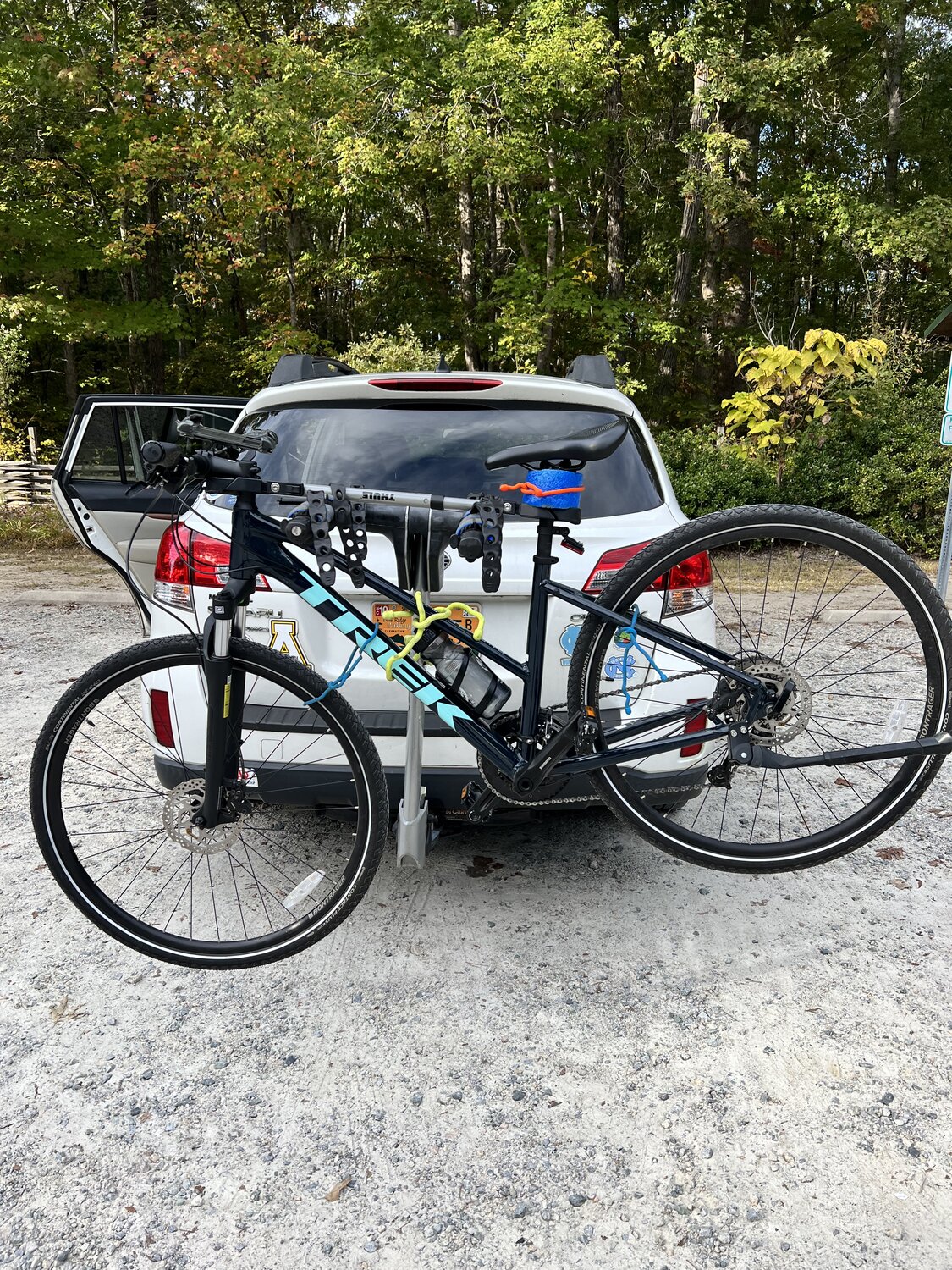

If weight is issue loading on bike rack, consider upgrading to platform rack. We bought Thule XT EasyFolder 2 bike rack few years ago. Very expensive but worth every penny, makes transporting bikes a breeze. Fitting and loading is a quick as shown, being folding easy to store. I don't use ramp but always option assuming they still sell them for my model. I don't trust locks for overnite, add cable or remove bikes but great for travel stops eg lunch.
See video
