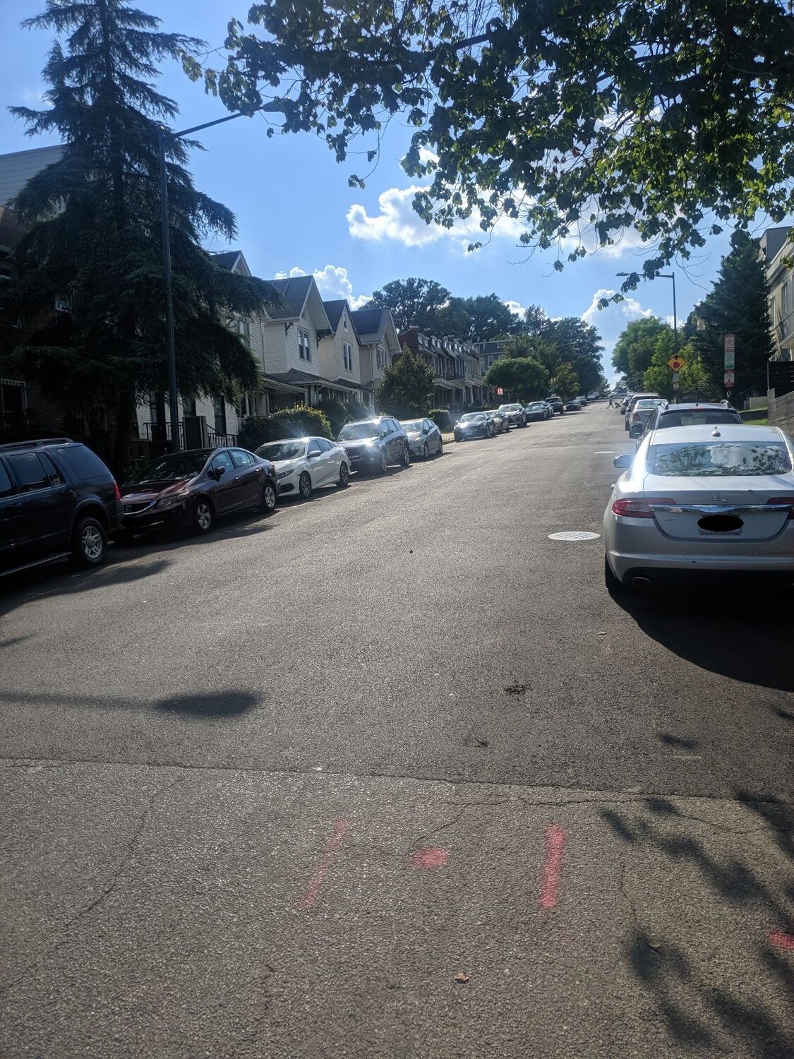

Edit: FWIW Took this hill no problem on 3 bars and some effort on 2 bars. Not sure the grade, but its as steep as it looks (or steeper than it looks lol)

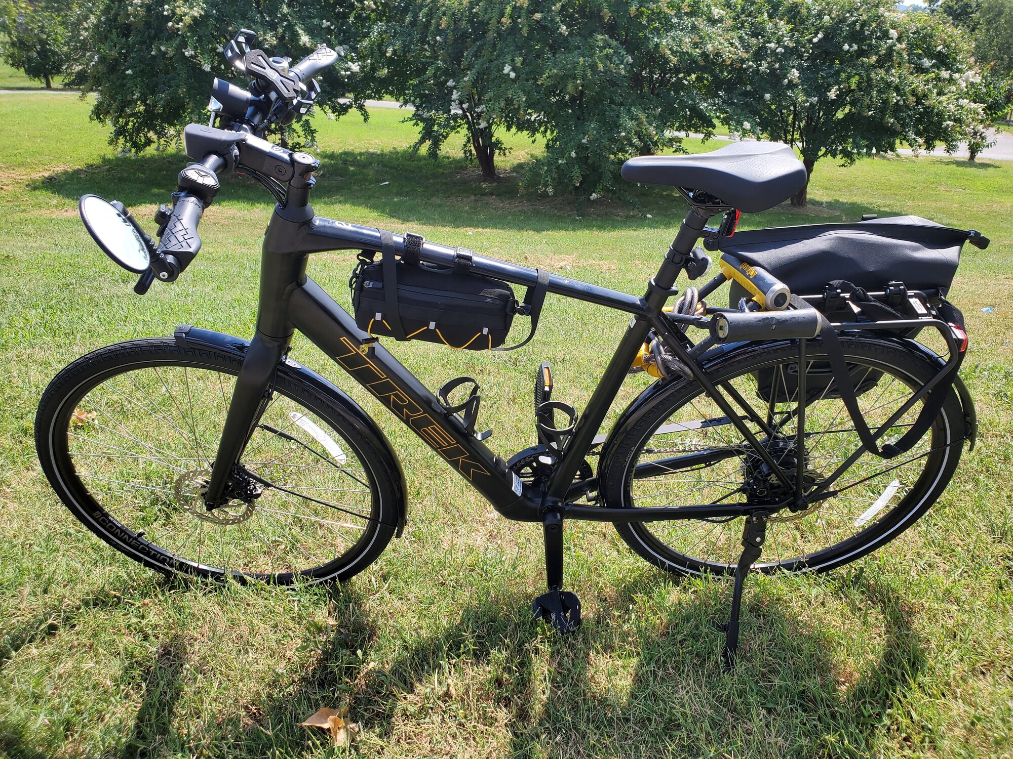

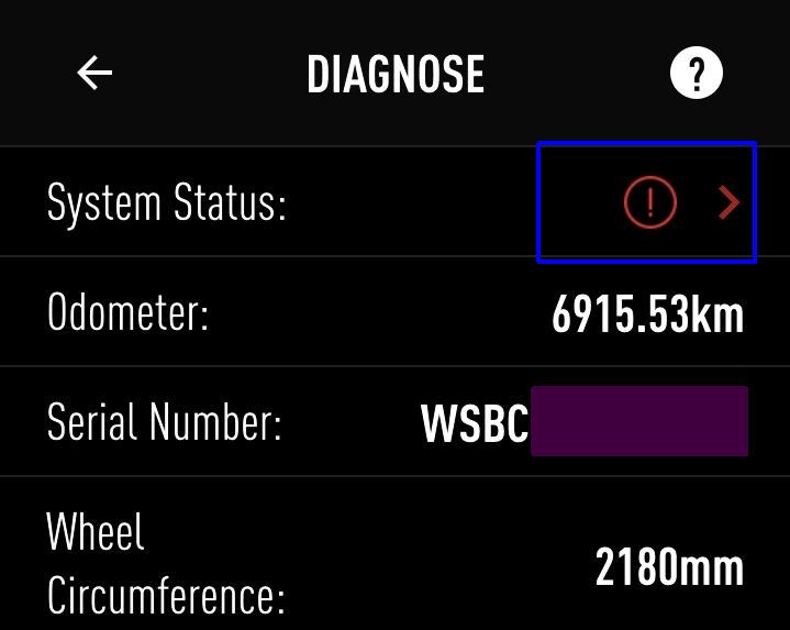

Hardly. The Odometer state and the number of cycles are stored with the TCU controller (the odometer data belong to the specific identifiable motor). If someone shows you both parameters in Mission Control app (and the Your E-Bikes page shows that e-bike with a proper Serial Number), it is rather improbable the data could be faked. The e-bike market is not in that state of development yet.

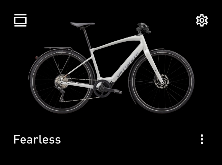

For your reference: Mission Control for my Vado SL shows these data:
The looks of the e-bike (especially the frame shape and colour) should resemble the e-bike being offered ("Fearless" is the name the user gave to that e-bike and it can be changed).
Odometer and Serial number. Pay attention to the red warnings: (In my case, I have a trouble with the speed sensor that I actually ignore). If you wanted to buy the e-bike from me, you should be very cautious of course!

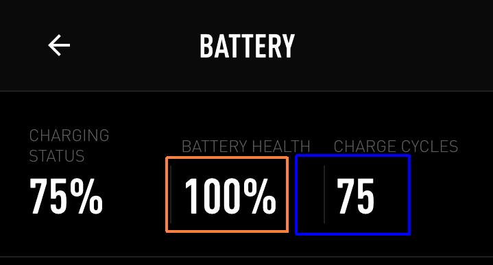

Look at the Charge Cycles field (blue there). Specialized say the main battery could be used up to 300 cycles without problems. Ignore the "Battery Health" field (red) as it always reads 100%. For your information: I have owned the Vado SL for 15 months and am a dedicated rider. I should not be worried about the battery for at least 3 years more.
