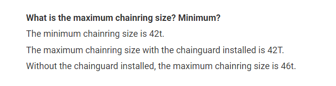

@Richard Stallard You seem fairly knowledgeable on these bikes thus far.. Do you know if the FX will take a larger chainring? It comes with a 42T, but something like a 48T may be ideal
Edit - Largest size without chainguard is 46t per Trek

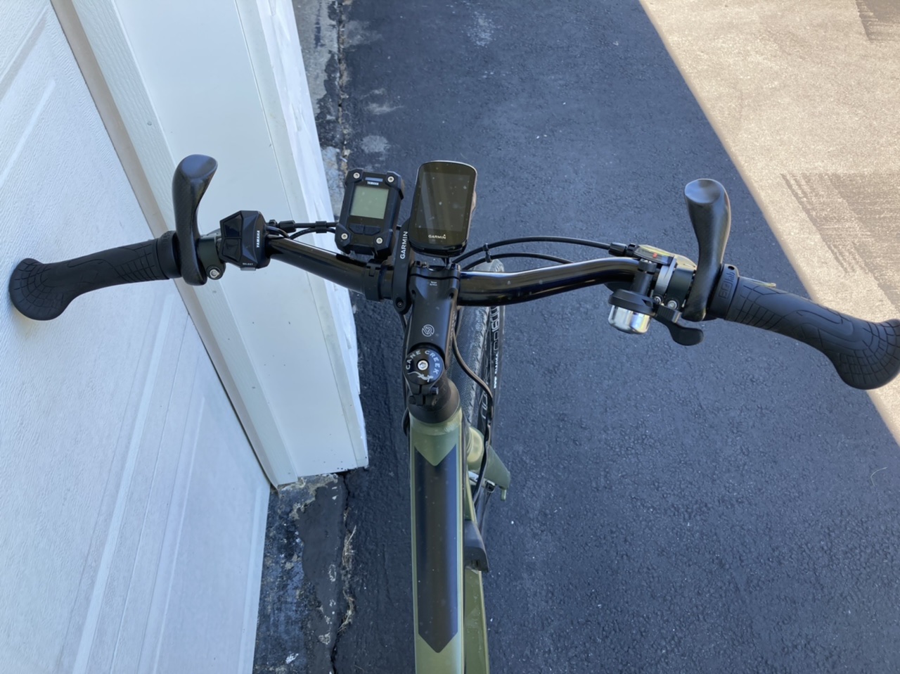

If I were leaving it as a 1x9, I would probably leave the 42 to preserve the 42-36 low gear and avoid big steps. Our Cross Cores began life as 2x9, but being 1x11 lessens the steps, so mine has a 46t chainring and 11-42 cassette, (a little lower than the stock 50/34 x 11-28). I could spin out if I really pushed it, but I don’t see the need, (I recently hit 46.6 mph going downhill and didn’t spin out, but I was getting close). This gearing eliminates the redundancies of a 2x while providing all the gears that I want.
I changed my wife’s Cross Core over first. We are both longtime cyclists, but she was having trouble getting used to the 2x9 in conjunction with the four assist modes, so I suggested the 1x11. She loves it. I took hers out for a shakedown ride after changing it over and found that I liked it better as well. The 1x11 changeover to SLX came to a little over $400.00 USD including Wolf Tooth Chainring Bolts, a KMC 11e chain and SRAM 1x11 chainring.

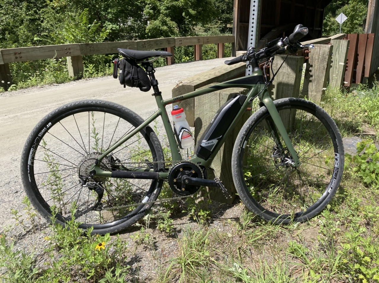

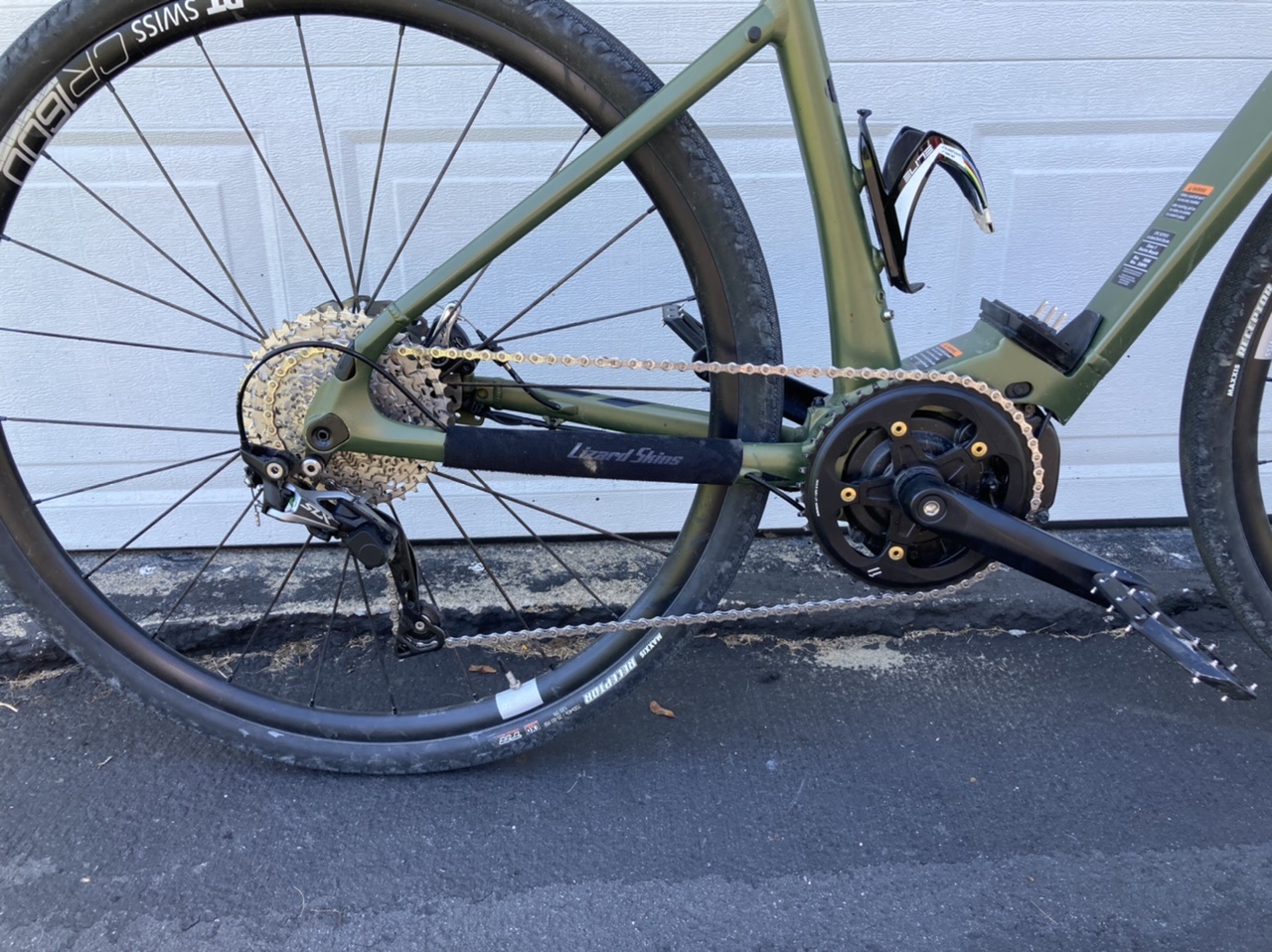

The Yamaha Cross Core has been great. I regularly ride gravel/dirt roads with grades over 20% and rarely use more than eco. It’s a mid drive with 70 Nm of torque. The motor is quiet and the stock bike with 500 watt battery was 44 pounds. Due to drivetrain, tire and wheel changes, mine is now a bit lighter despite the addition of a Cane Creek eeSilk Carbon seat post and Red Shift stem. Nothing too fancy. Just a very capable and enjoyable bike.
I don’t want to hijack the thread too much. I see the Trek as having similar potential, or as I said earlier, it is a good platform for other modifications. The internal-not-removable battery on the Trek is a plus and a minus, (it can actually be removed, but not for everyday charging or storage). The hub motor may or may not be a plus as well. Being six pounds lighter and having equal battery when desired by use of the range extender could be a plus to some, (of course when using the range extender you will have a weight penalty and the extra battery is fairly expensive and is a bolt-on style). The Trek dealer network is a plus as well and Trek generally has very good build quality from top of the line to the bottom. I think that either would be a good choice for someone looking for a good class 1 bike that they can personalize to their liking.

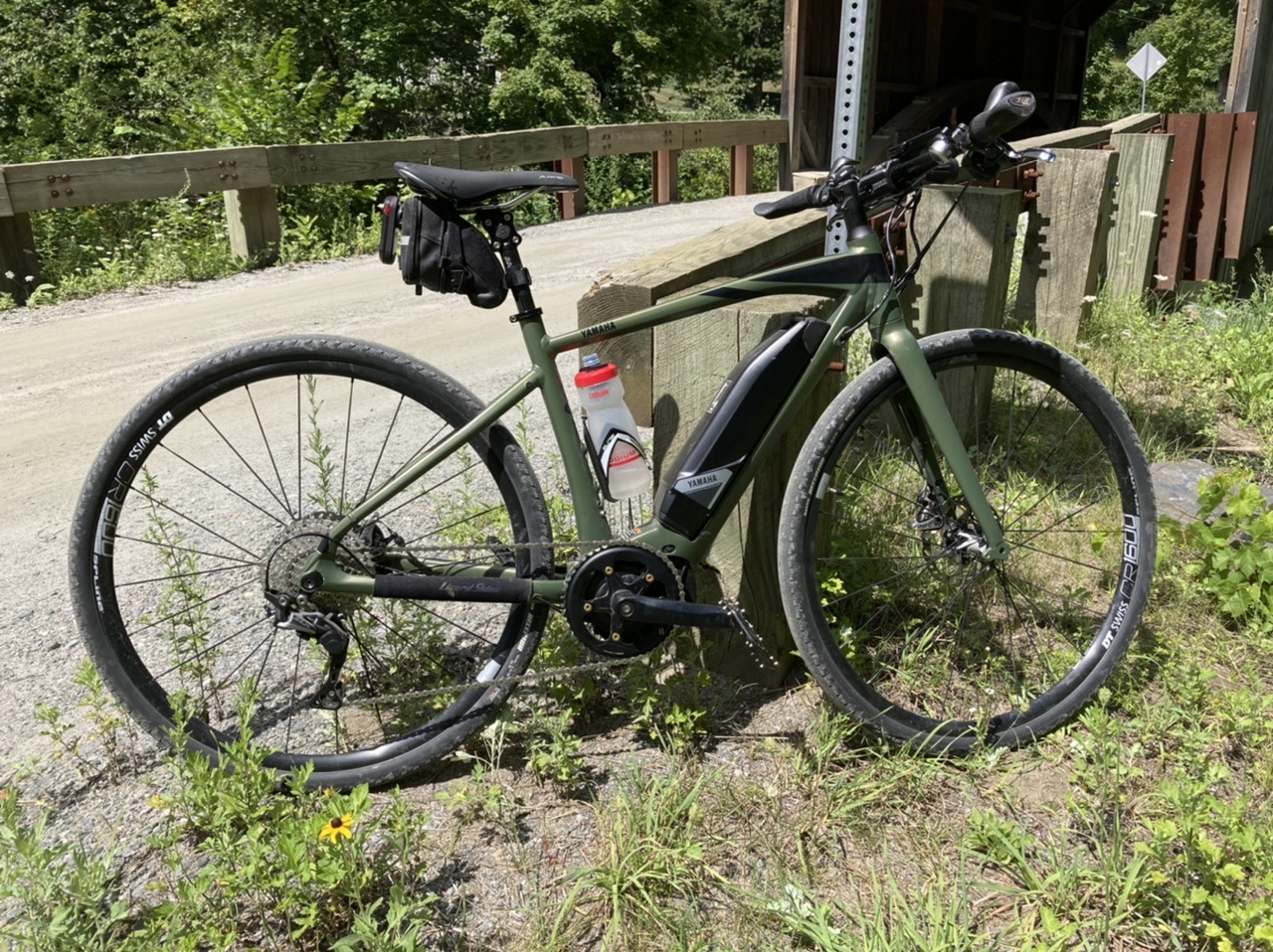

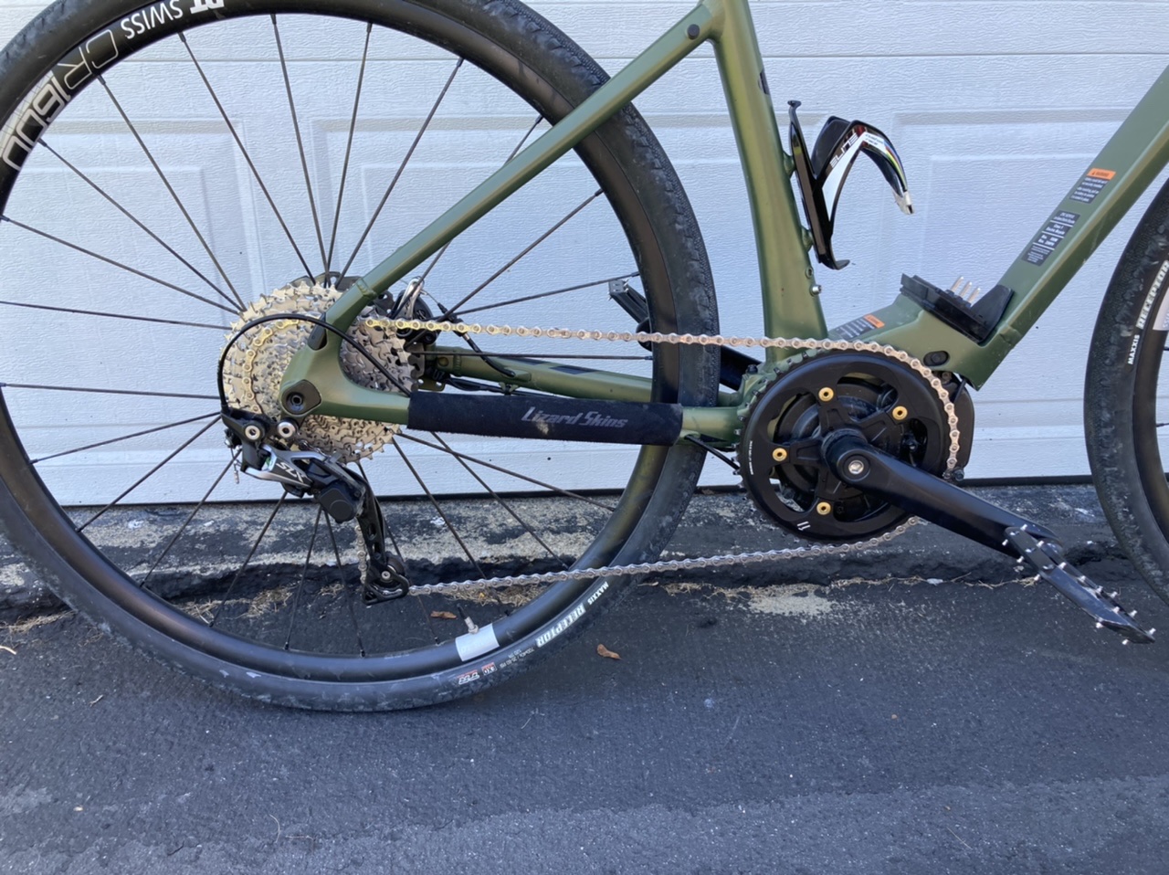

The Yamaha Cross Core has been great. I regularly ride gravel/dirt roads with grades over 20% and rarely use more than eco. It’s a mid drive with 70 Nm of torque. The motor is quiet and the stock bike with 500 watt battery was 44 pounds. Due to drivetrain, tire and wheel changes, mine are a bit lighter despite the addition of a Cane Creek eeSilk Carbon seat post and Red Shift stem. Nothing too fancy. Just a very capable and enjoyable bike.
View attachment 132639View attachment 132640
I went with the 46t chain ring on my Cross Core. It has a good range with the 11 speed, 11-42 cassette, (the steps are good, especially with the assist. The Shimano SLX shifter and derailleur are very good and won’t break the bank. I spin at about 80 rpm at 36 mph in 46 to 11. In 46 to 42 I can easily climb 20% on eco.
