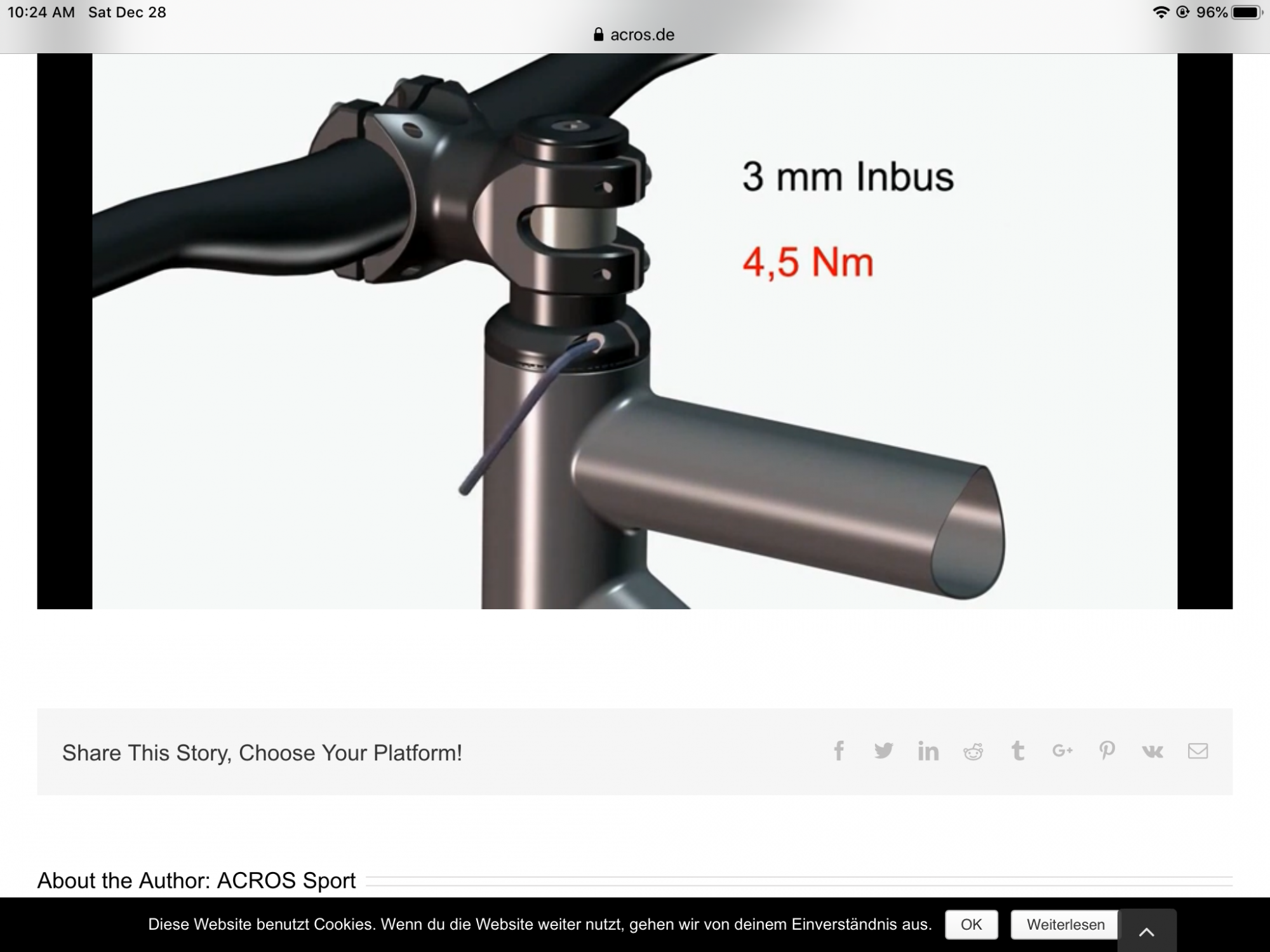

I have a question of you knowledgeable lot: the steering?
Good tight turning to the right, but quite restricted to the left. Best measure I can give you is pulling the grip full back on the left is a full 60mm less than pulling full back on the right. This restricts the turn quite a lot up front going left. There is still plenty of clearance for the wheel/fork/steering arm to turn more to the left at full lock beyond the current stop. Is this an issue inherent with the engineering of a longjohn style bike or has the headset (Acros BlockLock) not been set up right?

yes, I’ve had this issue on a new bike. Feel free to reach out via the inbox, and I’ll walk you through it if needed. Will take you less than 5min. Here is the adjustment:Hi Folks. New here, so hope this is posted in the correct place.

Hey Chris. Thanks so much for the immediate reply. Very reassuring to hear this from “Mr Load”. I googled as you suggested and got the installation video. Looks like the centring issue is several levels down from final state. Need a big headset tool. So will take this info to dealer. Thanks to you I now know the issue can be resolved and exactly which part is the culprit.Mike! Great to see you in here and congrats on your new ride! Mine arrives in a couple weeks and I can’t wait!! Be sure to share some photos, I’m sure you have some amazing sights where you are.
The issue you’re experiencing sounds like the Acros Headset needs an adjustment. You should have equal range of motion on both sides. I’m on my phone and don’t have the manual handy, but you should be able to google it and do it with the right tools.

Thanks dblhelix. Looks like that’s from the BlockLock install video. Thanks also for the offer to walk through. Being so new at this game I’m going to take to the dealer for service after 400 miles, there are couple of other niggles need ironing.yes, I’ve had this issue on a new bike. Feel free to reach out via the inbox, and I’ll walk you through it if needed. Will take you less than 5min. Here is the adjustment:View attachment 43279

Thanks so much for sharing this @dblhelix !yes, I’ve had this issue on a new bike. Feel free to reach out via the inbox, and I’ll walk you through it if needed. Will take you less than 5min. Here is the adjustment:View attachment 43279
