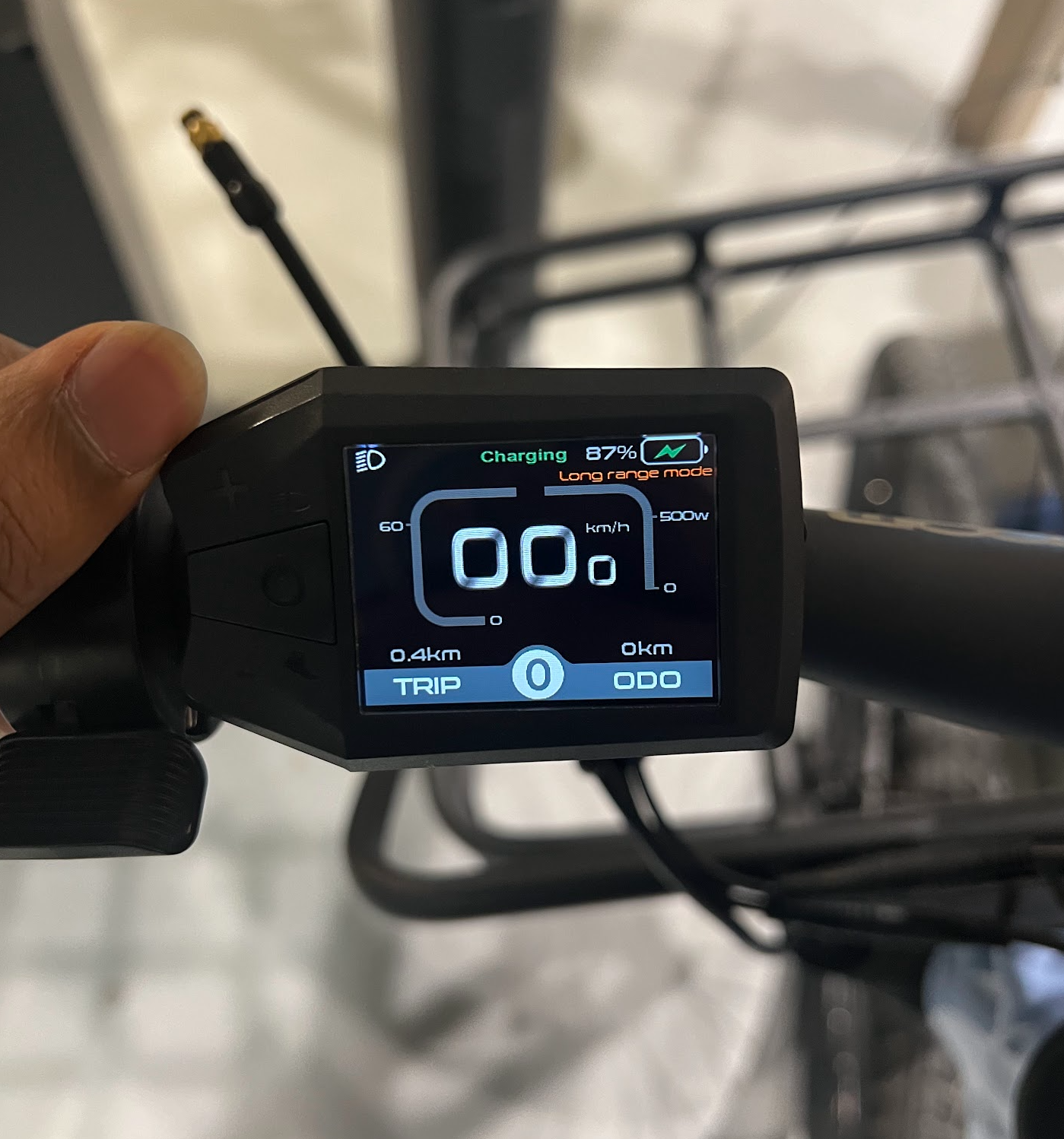

    We designed a custom BMS for this E-bike that offers multiple safety and innovative features. For example, by default, the BMS only charges 80% of the battery, and with one press of a button on the display, it will unlock the full charge to 100%.
    You don't need a Cycle Satiator or some advanced charger. Everything has been built into the pack itself. The pack is made of 21700 LG cells. Even charging 80%, the battery has more than 620Whr capacity, and at 100%, it has close to 780Whr capacity. BMS is built to UL-2271 standard.
  • Smart Charger
    The Battery BMS and the charger communicate effectively to adjust the SoC and eliminate the need for advanced chargers, timers, voltage limiting devices

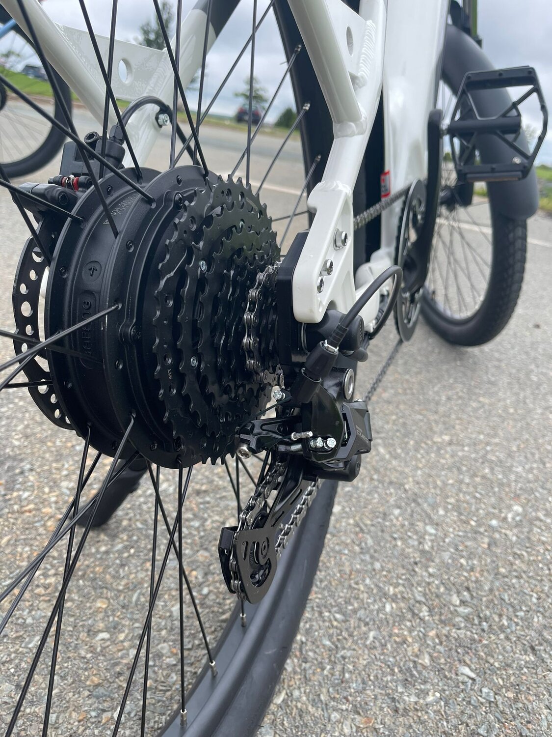

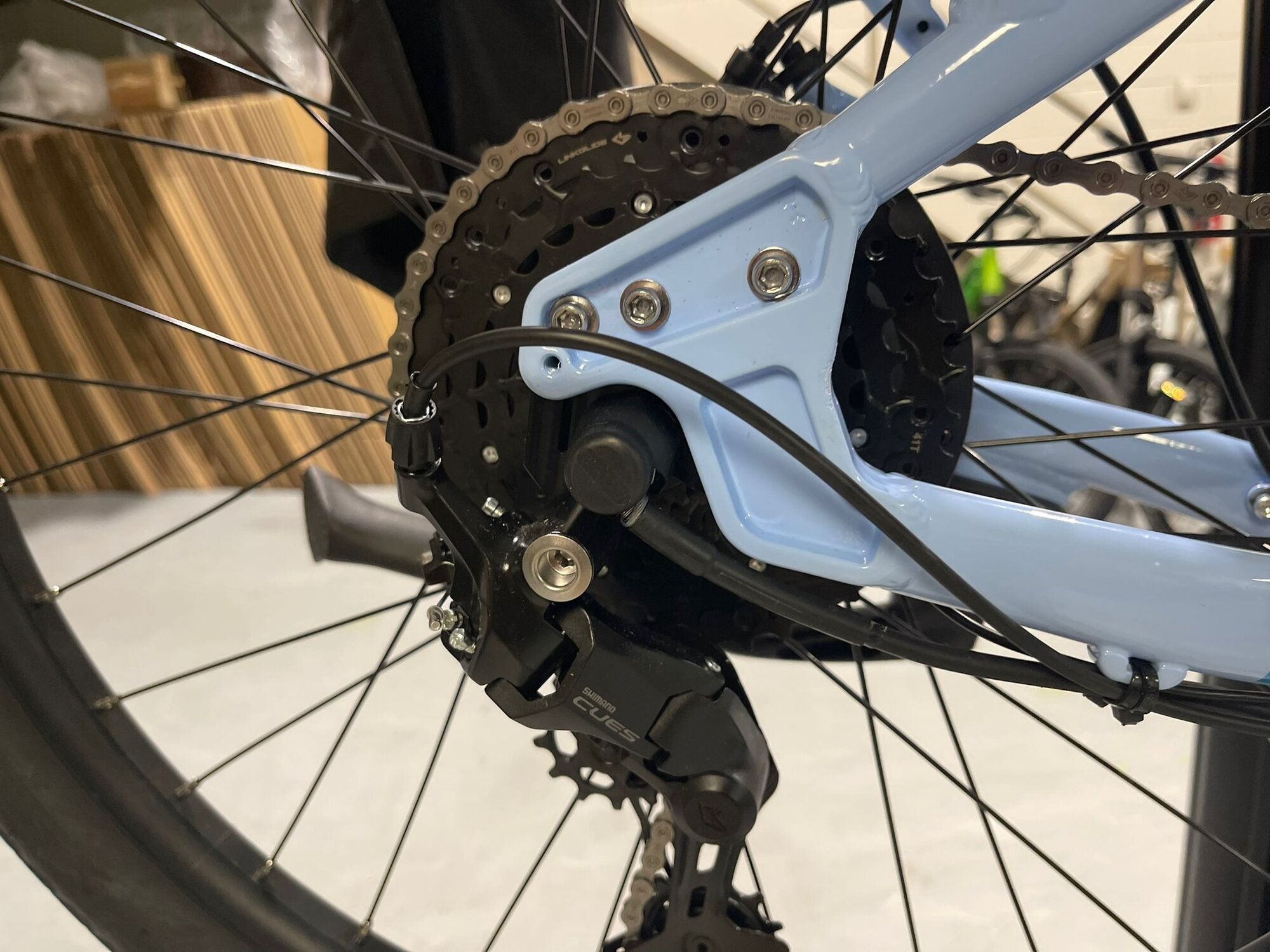

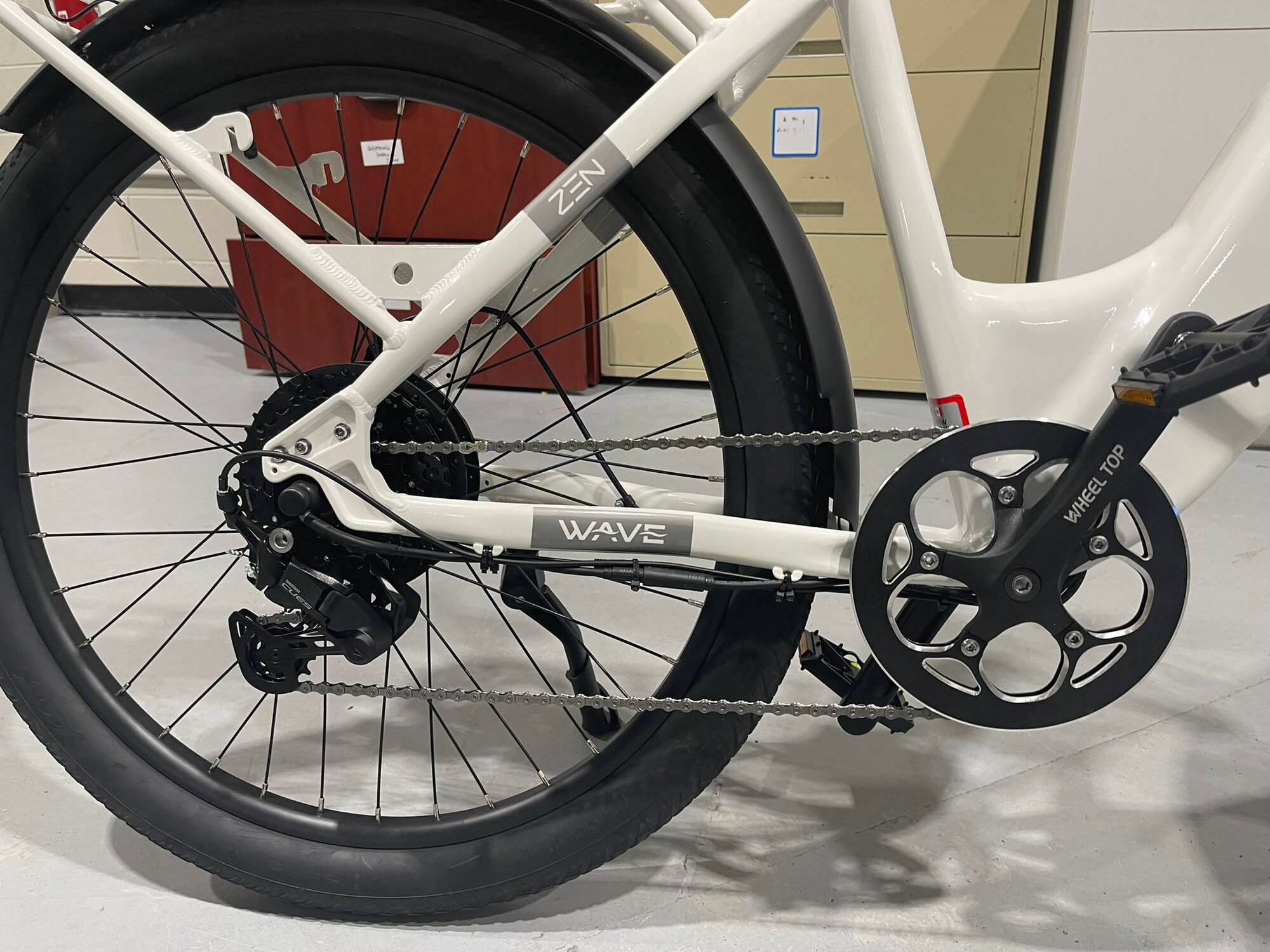

Shimano CUES Linkglide system – gear cluster, shifter, and chain.
See the video below, Prowheel 48T front chain ring
Gear cluster​
Shimano CUES Linkglide E-bike specific 9-Speed cassette 11-41T
https://bike.shimano.com/en-EU/product/component/cues-u4000/RD-U4000.html

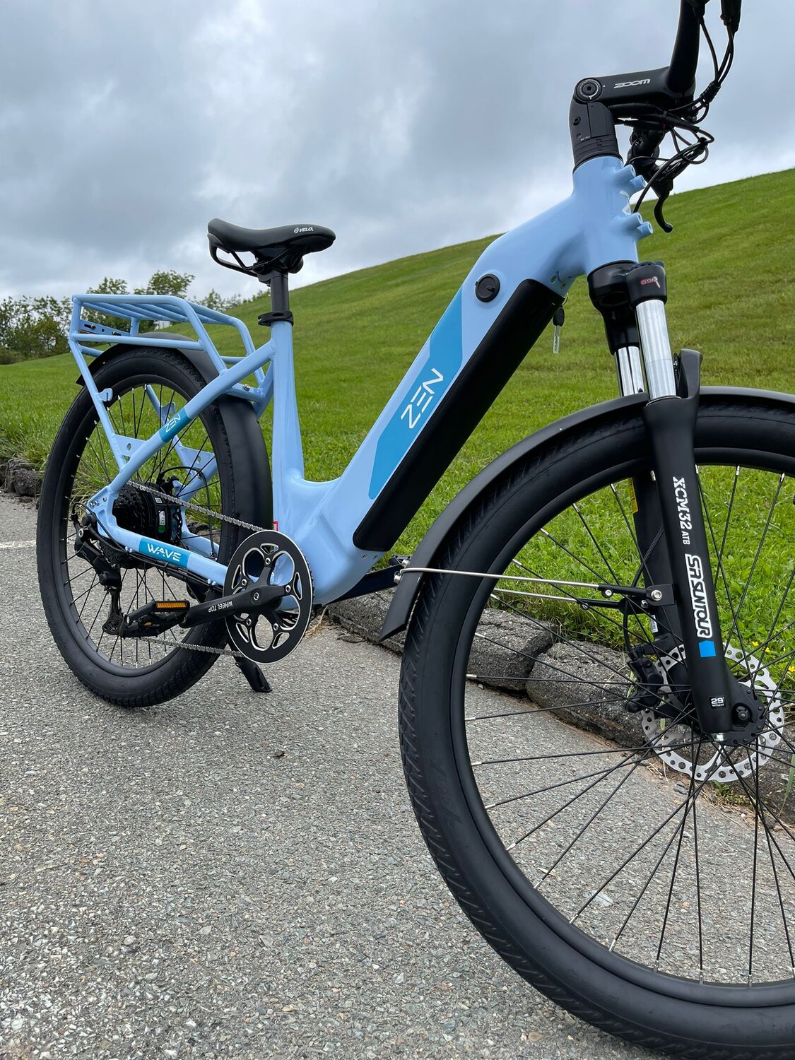

Suntour XCM 32-ATB Coil spring with pre-load adjuster
https://www.srsuntour.com/in/products/fork/XCM-ATB-29-5757.html​

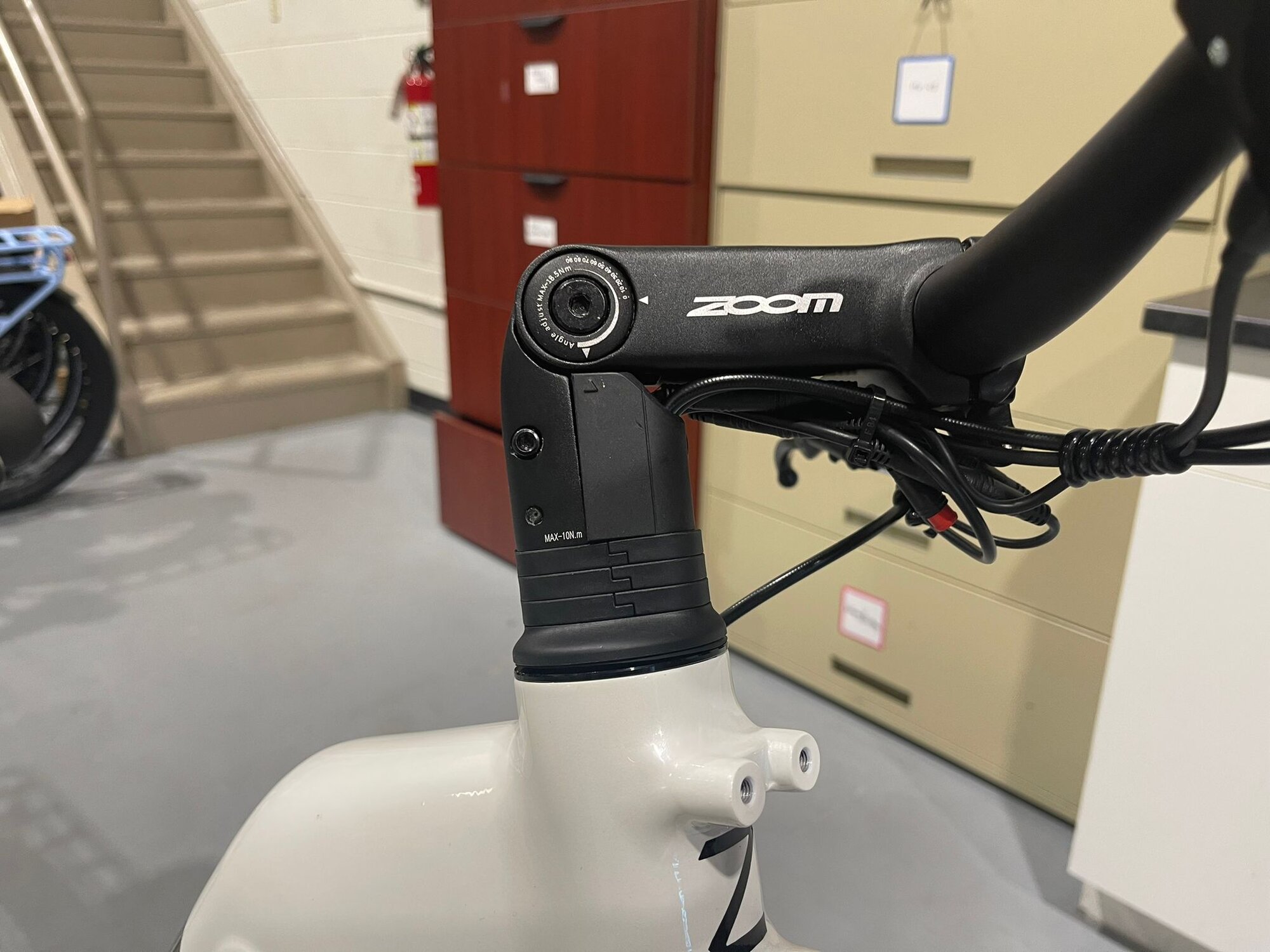

Stem and Handlebar​
Zoom TDS-D636-8FOV, E-bike specific, internal cable routing
EN15194-rated
Zoom handlebar​

Some pictures for viewing pleasure [please click on the images for higher-resolution]

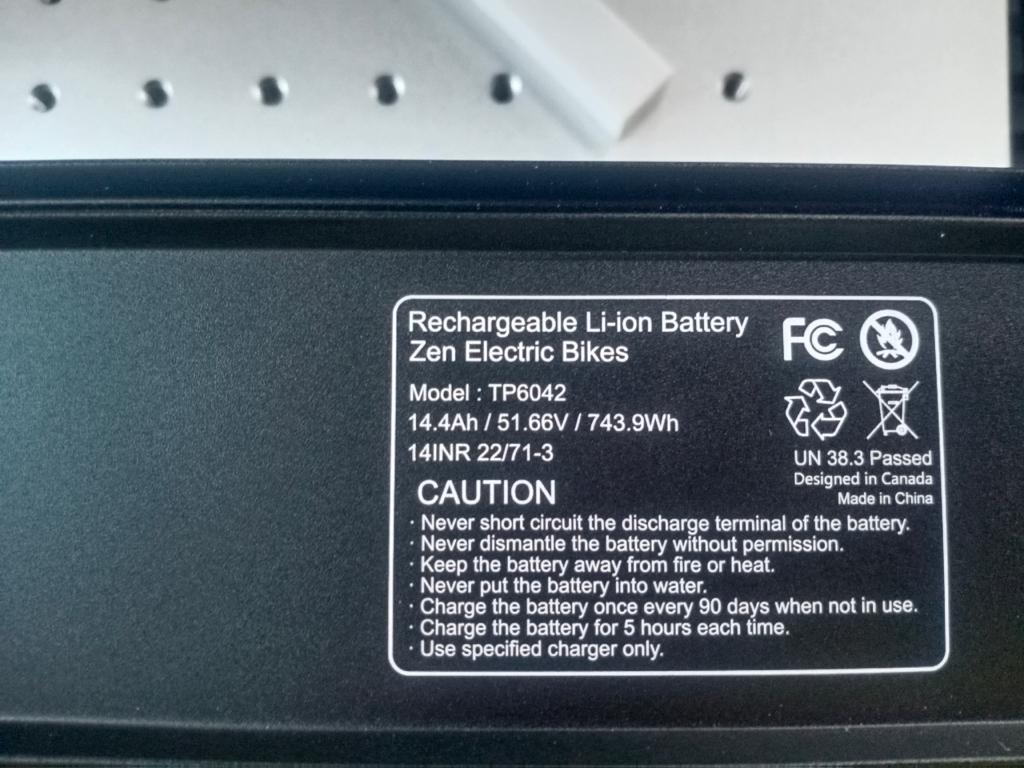

So far, our battery packs have passed UN38.3, UL-FCC, UL-vibration tests, and UL-1998 and UL991 tests for BMS. These tests are pre-requisite to obtain full UL marking on the battery.
The code name for our project is TP6042, and this is what you’ll find on the Zen Wave batteries.

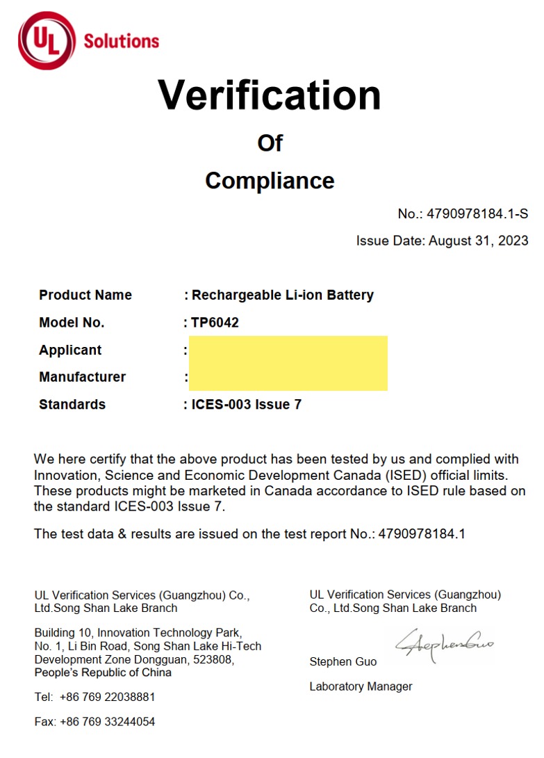

Here is an Official UL compliance report on FCC for the Zen Wave batteries. Hence, we can use the FCC mark on the battery. Please notice the TP6042 project code name. Our agent in Asia and the pack manufacturer's name have been held confidential for trade secret reasons.

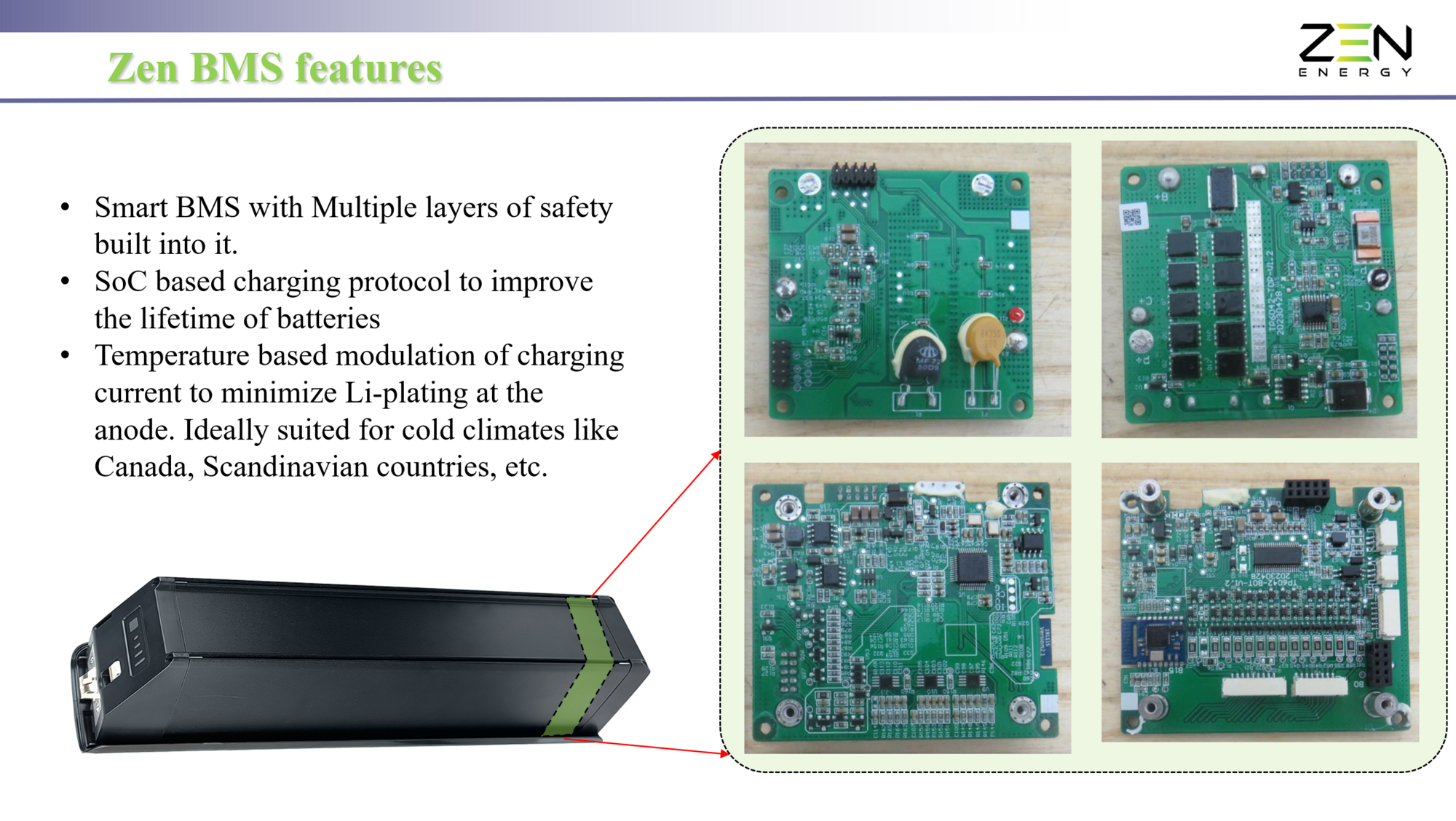

Did you know that we have included several innovative E-bike Battery Management System features ideally suited for cold climates in Canada, the US, and the EU.
Anyone who wants to learn more about E-bike batteries is encouraged to visit our facility in Dartmouth (1 Research Dr) and learn how these batteries are built.

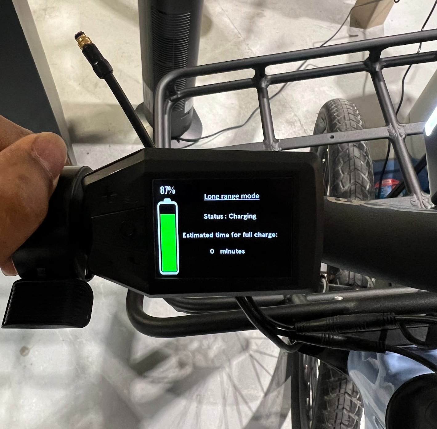

To our knowledge, no other E-bike has long-range and long-life modes like we do; especially at this price point.
On our WAVE E-bikes, we are upgrading software to indicate long-rage and long-life modes and this eliminates the need for using charging timers etc to limit the charging to 80%. Just select the mode you like to use.
Our WAVE E-bike has all that programmed into the BMS itself and this is the reason why we are able to offer 3-yr battery warranty. The following images were taken when the firmware upgrade was taking place, so numbers may seem a bit off.
