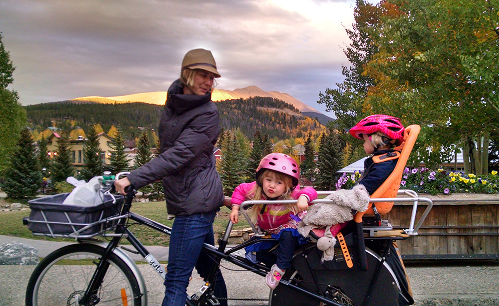

I have to say pulling a trailer adds more drag and frontal area (air resistance) you could do without with a stretch frame cargo bike. Loading the kids might be harder but with grab bars, a padded shelf, spoke covers over the wheel, lots of people are doing it with 2 kids. Riding on road, I like to be up high, to give me (and kids if I had any) a chance of bouncing over the hood of a motorist. My neighbor did it, only one night in the hospital.
I'd also say low pressure fat tires are a huge drag and kilowatt eaters. Try to find something that will take 2.4" or 2.8" medium pressure tires (55 psi) Most fat tires, 3.0 up, are 30 psi max. Radioflyer L885 looks good but I can't look at the specs, it locks up my computer. https://flyer.radioflyer.com/ebikes 500 w I see. Blix packa has 750 watts and only one post on the known problems thread of the brand forum, after 6 years in business. www.blixbikes/products/packa
If you really like changing chains every kilomile or two, giant momentum has a yamaha mid with dealers . Maybe the battery is not as expensive as bosch (>`$1000). I get ~5000 miles out of my chains with a hub drive.
With the stretch frames, you'll lose the suspension feature. You can add a suspension fork later to most of them with standard column diameter. My yuba has an oddball steering column diameter, makes it impossible for me.

2. Like the trailer rather than cargo bike because for the percentage of time not pulling trailer it makes for a more suited biked for the usage
